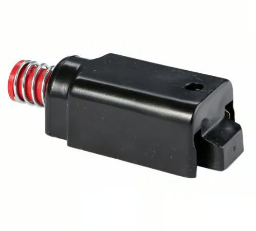

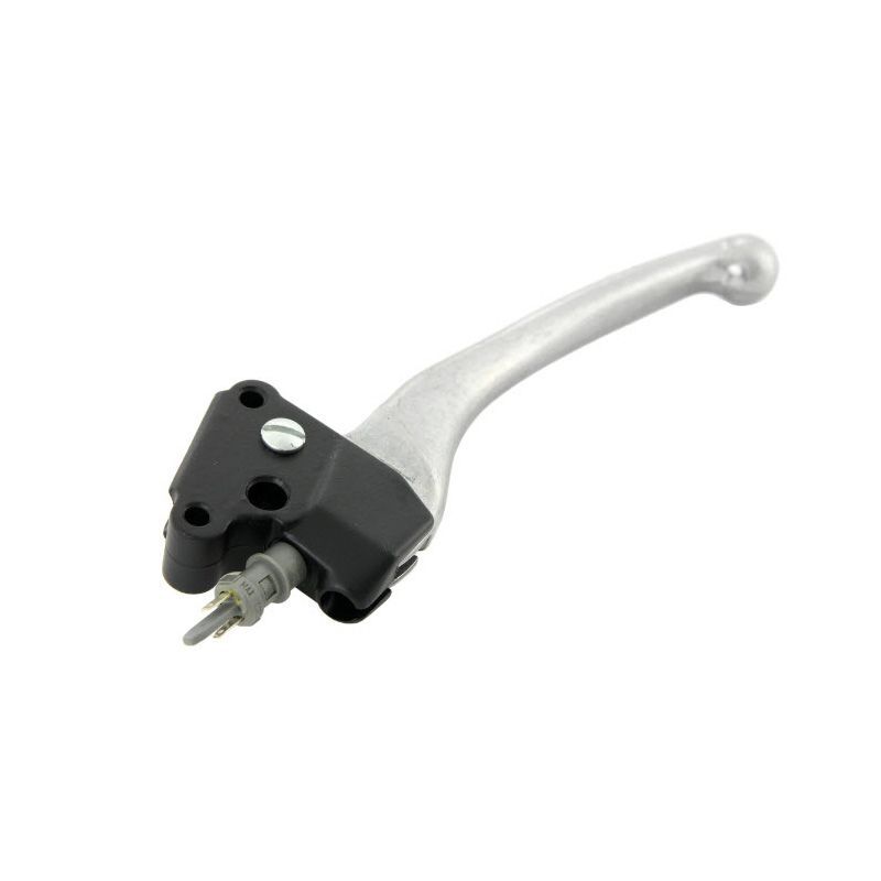

Scooter west has both the switch and mounting bracket listed.
You will need to drill and tap the lever, for the post the switch hits.

You would be better off installing a P style inline switch that you can hide in the headset rather than an external thing.
@jedihunter avatar
Posts: 331
@jedihunter avatar
Posts: 331
Do that ^
A much cleaner solution!
