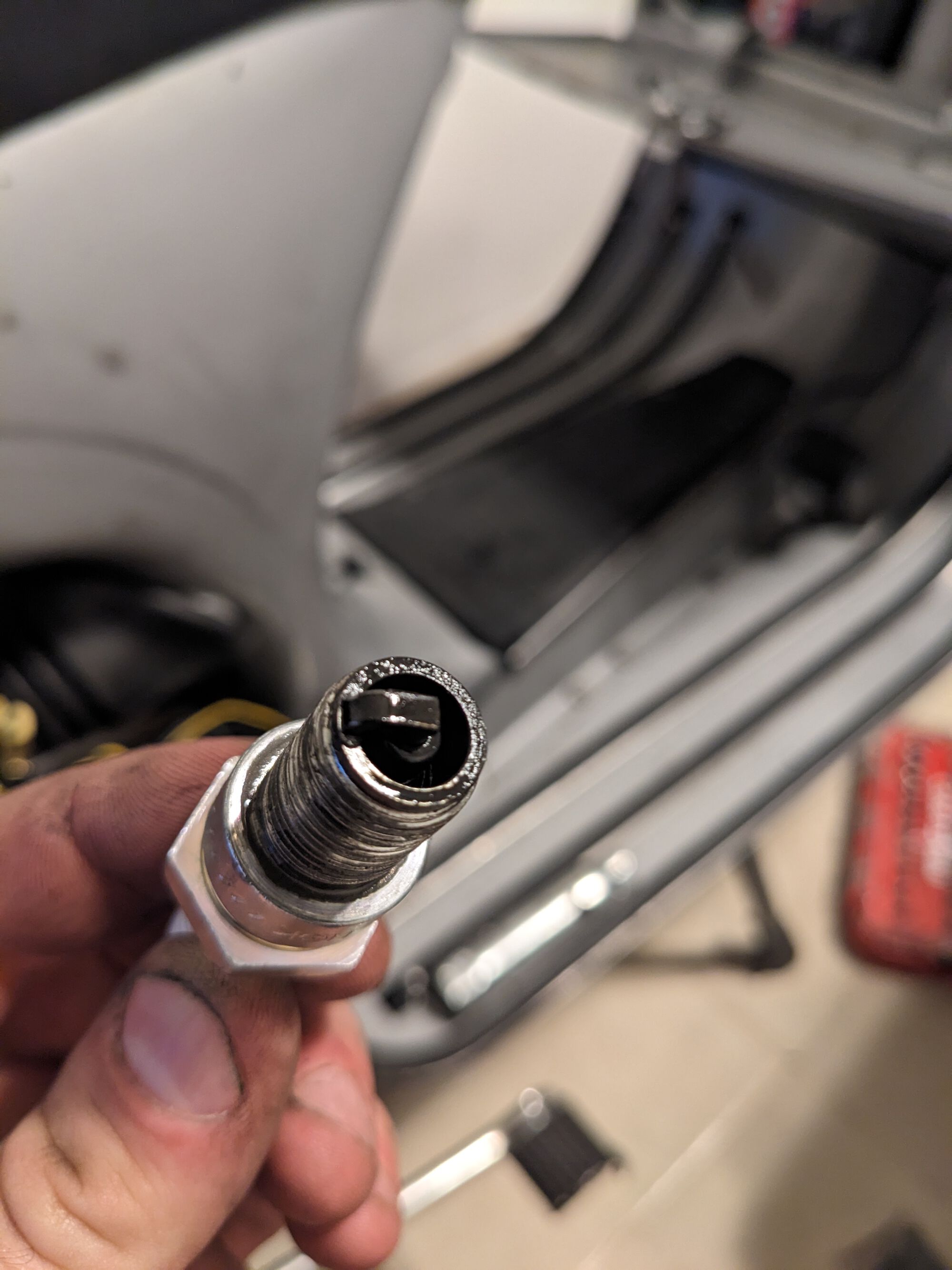

Done while riding.

Thinking about splitting the cases myself. I have the time. I want to avoid removing the engine completely though. How much can I accomplish with the engine still in the scoot? Can I solve my air leaks?
I'm on the list to get it into scooterwest, but who knows when that'll be.

You can leak test it on the bike. Just need to remove the carb and drop the exhaust.
Search here using "leak test," as there are a few ways to do it (and not much $).
Have you strobed it?

I strobed it when I initially timed it and everything was fine I believe it was right around 18 or 19 degrees btdc. If i remember correctly turning the stator in 1 direction all the way gave me the needed degrees.
UPDATE: Engines out. Cases split. Im diving in. Pretty easy so far. Going to ensure things are done right.

If only those marks on the bore then not bad but still shouldn't be there.
Confirm what jetting is in there now, AC140 BE5 115 52/140?
The idle instability is a sign of an air leak with a 52/140 pilot jet.

Yup, that was the jetting.

coastalviews wrote:
Sorry to ask this again, but I just discovered that I actually have a 24.24 carb on the bike, not a 20. 20, like I thought.
Recommended jetting?
Currently:
P125x
Malossi 177 cast iron
Mazuchelli 60mm race crank w/spacer
Case ported as best I could
All new bearings/seals/gaskets
Road2 exhaust
24.24 carb
52/140 idle
120/BE4/118
I ride mostly around town(under 25mph), and the throttle is barely cracked open, and VERY spluttery. Like, obnoxiously so.
Took it up to 60mph this morning, and temps didn't get above 250. Felt good. Though if I let off full throttle, it increases the speed almost instantly

Hec In Omaha wrote:
Man by what you're describing when you let off the throttle, it sounds like you're too lean. If it won't idle it's too lean. Next time apply some choke when you're riding. If it idles better then you know it's lean.
Hec
Hec
Sorry, I meant to clarify my post, but you got to it faster than I did. What I meant was, at full throttle I was holding steady at 60 MPH, if I let off to around 3/4 throttle, I sped up to around 65 mph. It idles fine.
I've heard of this happening before, but I can't remember if it was one of those situations where what I think the problem is, is actually the opposite. Like, I would think that maybe my 118 MJ is too lean, so at wot, it's not enough. Or maybe it's too rich, and bogging down the engine.
Ok
First let me start by saying I am a rank amateur and have never jetted a Vespa. Im going through this exercise myself for the first time. So take this info with a grain a salt.
You may have already read this. But incase you haven't here it is.
From NSM Wiki page on tuning SI Carbs
Wiki [D] Guide: SI Jetting Chart + How to Tune an SI Carb.
6.3) Tuning the atomizer is the same basic process as the main jet. Start rich, work your way down. If you have a 177 top end, start with a BE4. The Malossi 166 kit used to ship (maybe still does) with a BE4 and (I think) 125 Main Jet. No AC, though. Go figure.
If the BE4 is too lean, then you need to drop your Air Corrector (So 160 to 140; 140 to 120; etc.) and start the process over with the main jet, as it should now be too rich.
Once you're on the correct AC, test riding in 3rd gear by getting to the low end of the power curve, then dropping back to half throttle. It should continue to accelerate, albeit not as quickly, but also not stumble while it gets to a cruising speed.
Your description fits above and therefore I think your AC and atomizer combo is close. I would try bigger main jets and work your way down. What's the biggest MJ you have to try?
Others please chime in.

Late to the party here but all of this points to an air leak for me. I really believe you are chasing ghosts until eliminate air leaks from the equation.
@coastalviews avatar
P125X
Posts: 146
Location: San DIego, CA
P125X
Posts: 146
I think the air leaks are taken care of. It's running pretty well at the moment. Just getting the jetting correct now.

Did you leak down test it to be sure?
P125X
Posts: 146
P125X
Posts: 146
Leak down test with oil in the intake inlet? Or a pressure test?

Pressure test.
