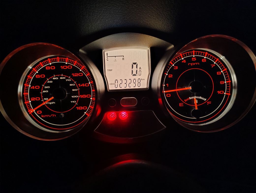

I attached a picture to show what lights are lit on my dash. Other than the wrench symbol (which I think is an oil change warning), nothing else seems out of the ordinary.
Wrench symbol is flashing. I just happened to capture the picture just when it went off.

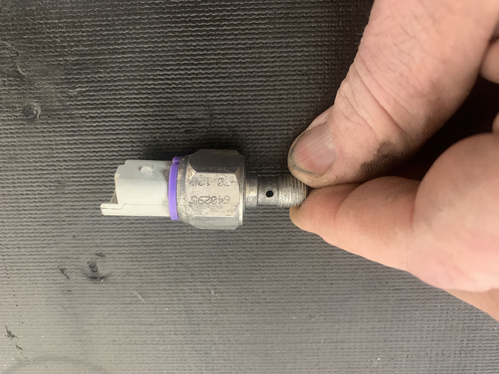

I have repaired this on one of my MP3's before (as well as others that came into my shop).
A 2009 MP3 400ie.
Usually, a failing sensor causes the horn to honk a multi-beep warning when you turn the ignition on.
What year and model are we talking about here please?
In the case of the 400, (and others I suspect) there is a pressure sensor which is a hybrid metal/plastic component. Mine was under the nose cone, attached in the back to the brake line assembly.
Eventually, the heat and vibration cause the fluid to leak from the point where the metal and plastic come together.

I was at Cadre Cycle in Cincinnati, Ohio yesterday.
Enzo, the owner, showed me a beautiful black 2009 MP3 500 that he took on trade for a new GTS Vespa.
Enzo knew that the MP3 had some issue but he had never encountered this before as he is a new PIaggio dealer. He asked me and I was delighted to be of assistance.
As is common of the MP3's I saw and worked on in my professional shop, the reservoir for the tilt lock setup (it is in the nose cone under the fairing) was bone dry. (Out of sight and out of mind for almost all owners.)
Because there was no pressure in the system, the alarm sounded the horn 4 times every time you turned the ignition on, which is the alarm to notify you that there is an issue with the system.
Again, these hybrid pressure sensors are all leaking at some rate by now simply due to age.
Most that I worked with, had leaked so slowly and for so long, that you literally could not find any liquid fluid anywhere.
In fact, the first time I did one of these repairs, I nearly tore my hair out trying to find where all the hydraulic brake fluid had gone to!
Those pressure switches are expensive at about $160 but they are a critical component.

Replaced the roll lock pressure sensor today. The old one was definitely leaking because there was brake fluid inside the housing where the electrical connector plugs in.
