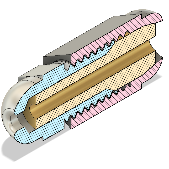

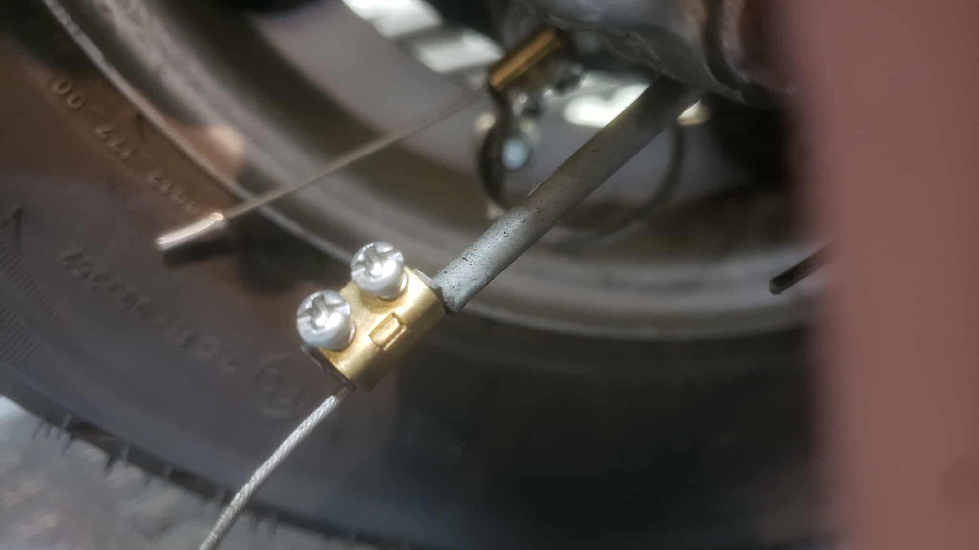

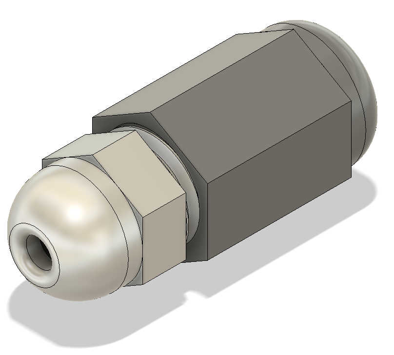

I'm trialing a system where I'm using an electrical cable screw connector, usually an earth connector, to clamp the cable. It very rarely damages the cable, so I can move/adjust it without having to replace the cable. No matter if the trunnion has the little round plate, it always seems to damage the cable to hold it as you see in the picture.
I drafted up a clamp that uses dremel collets but never got around to making one to test out.

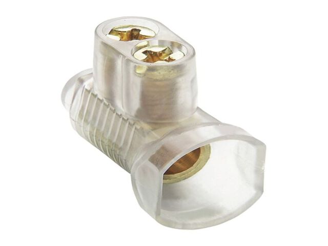

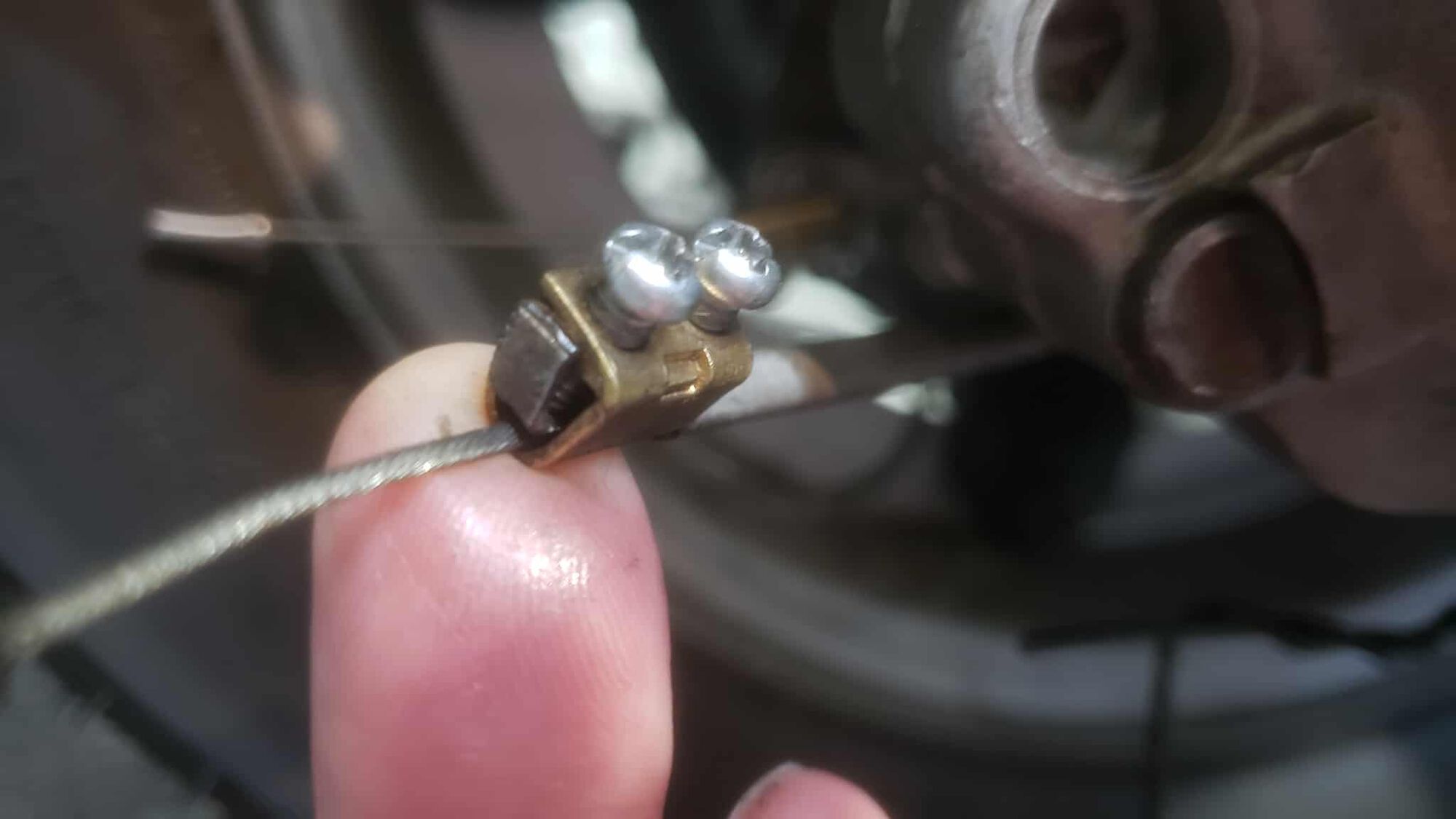

Here is my attempt to stop ruining cables every single time I use them... this electrical earth connector is cheap and holds well. I add a small strip of sheet metal bent up at the ends to stop the screws cutting into the cable. Certainly not as neat as yours but doesn't require much input at all. I guess you could cover them with heat shrink if you don't like the look.
Looking for a picture I see aliexpress do them with grub screws which might help them to look a bit less chunky.
