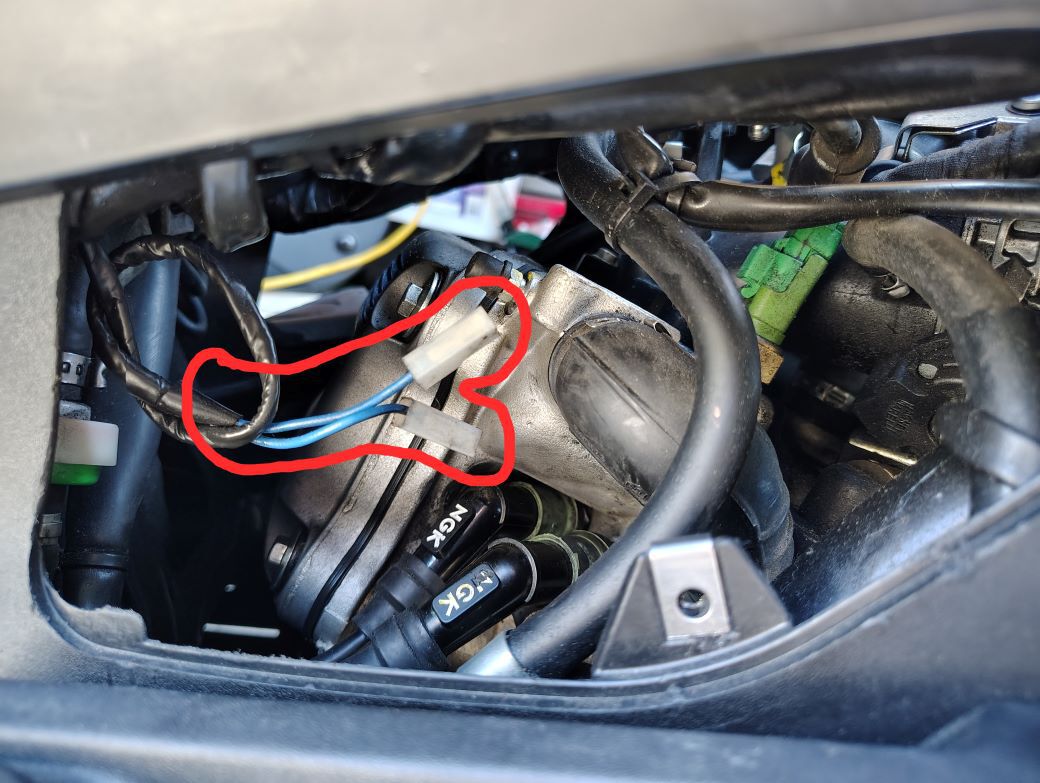

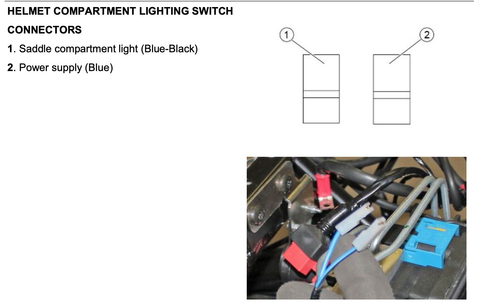

Also, anyone know what these connectors with the blue wires are for?
Mystery connectors with blue wires.

Still trying to figure out what those blue wires are for.
Does your bike have 1 or 2 ignition coils? Maybe a coil is missing or unplugged, hence the wires, hence the hard starting??? Strictly a guess, since I don't know the early gen 1&2 bikes very well
The wires look factory, and not aftermarket junk

Does your bike have a cigarette lighter? On mine (a early gen3 mp3) the factory cig lighter sits just above the engine next to the battery.
On later bikes the cigarette lighter was removed as a cost cutting measure
Does one of the wires have constant +12V under all conditions including key off?
if you trace them backwards do they go into the main harness bundle?

Yes, there is a 12V socket under the seat. Don't know if it has power though because I haven't tested it. The underseat light doesn't turn on when the seat is opened. There doesn't seem to be a switch that I can see that would turn on that light though. Anyone know where the switch is located? Maybe those wires are for one of those. I'll have to check.

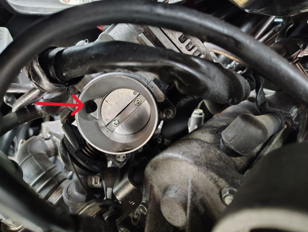

So I took the air filter box off to take a look at the air bypass valve. I assume it's that small hole next to the throttle plate. Makes sense now. That's how the idle circuit gets its air when the throttle is closed.
Interesting thing, the engine doesn't seem to want to start if I don't twist the throttle a little bit (thereby allowing air to get in). But, once it starts, it will sit and idle forever with the throttle closed. I haven't sprayed cleaner into the air bypass yet. This is puzzling because if it is blocked, it shouldn't be able to idle.
Maybe the valve lash needs to be adjusted. Sigh. I don't really want to remove all the tupperware around the engine so I'll just have to see if I can make the adjustments using only the provided access holes.
Air bypass port indicated by arrow(?)

Do not adjust the throttle plate under any circumstances. The plate is never 100% closed
Clean out the bypass valve first using carb cleaner or throttle body cleaner, followed by adjusting the intake & exhaust valves.
Then report back
The cig lighter socket is easy to test. It is hot at all times, so plug in something and see if it powers up.
The light is triggered by a switch located around the edge of the bucket.

Could those wires be from the saddle switch? The switch that checks if you're properly seated and which prevents from unlocking the rol-lock and revving.
Sorry for the late response. I think if the seat pressure sensor were to be disconnected, there would be an error light on the dash or some kind of reaction from the ECU. At least that's what I've heard.
I'm thinking those wires were connected to the seat switch that turns on the tub light because the switch itself seems to be missing. There's a hole there, but no switch. Perhaps a previous owner (I'm the third caretaker) removed the switch for some reason.

Oh I will take a look for the blue wires on mine when I get home as I currently have two 500s apart in my bike barn lol

I didn't get chance to check the blue wires yet.

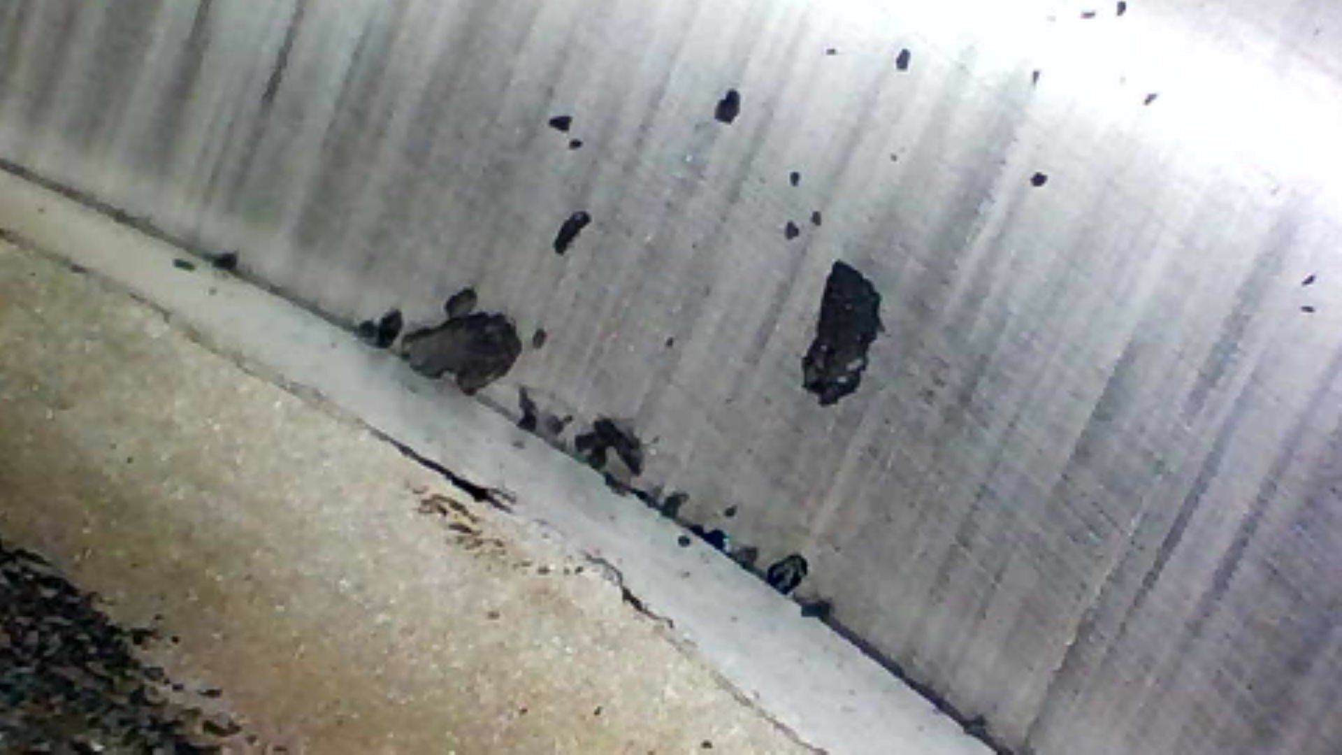

Did a leak down test. Failed miserably. I could even hear and feel air coming out of the dip stick hole.
Ah well. A new piston/cylinder/gasket set isn't too expensive at around US$500. Now to see what a shop will charge for labor. If it's too expensive, then I'll try tackling it myself. I've dropped and rebuilt GY6 engines before and the Piaggio engine doesn't look too much different. A lot heavier and water cooled.
Life is an adventure. It's a good thing I didn't pay very much for this thing. Besides, I like this scoot, even though I haven't been able to ride it much.
Scooterwest has the OEM kit. https://www.scooterwest.com/cylinder-piston-pin-ring-group-873812-b019019-mp3-500-2007-2019.html
It is not a bad job. Hardest part is breaking it in half after getting the plastic off lol. Here is a thread where I documented my nooby attempt and ultimate success doing it. Got the engine dropped today. Head off. NOW GOOD NEWS!
