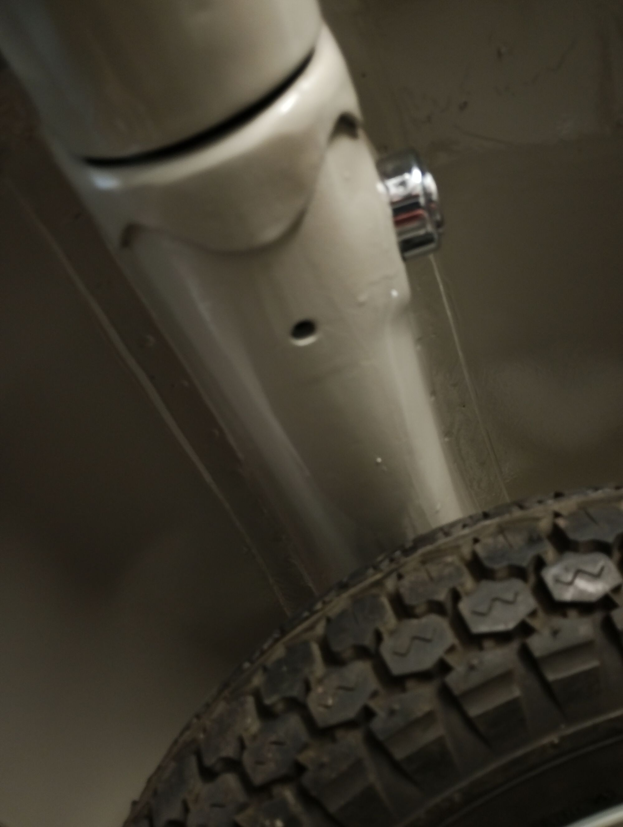

Just next to the lock. Looks like it has a thread in it

It's my mount for my rpm/temp gauge. Glad they put it there.
No clue what it's original purpose was though.

Surely someone must know. Looks factory

What model is it ?
There is no hole there on my VBA and VNB

ColinBelgium wrote:
What model is it ?
Both my VNA and VNB Allstates have the hole

Most bikes have a rubber plug there, but it is used to hold a basket at the inside of the leg shield.

Could that be proper to US market ?

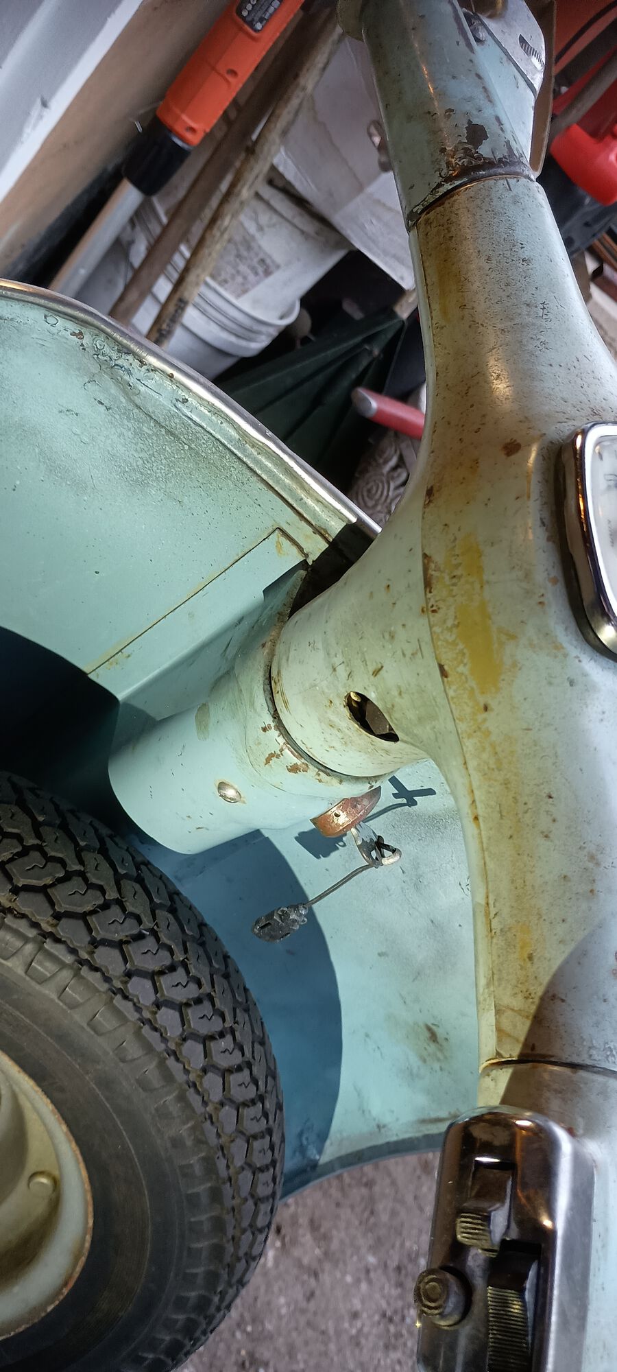

My VNB
My VBA

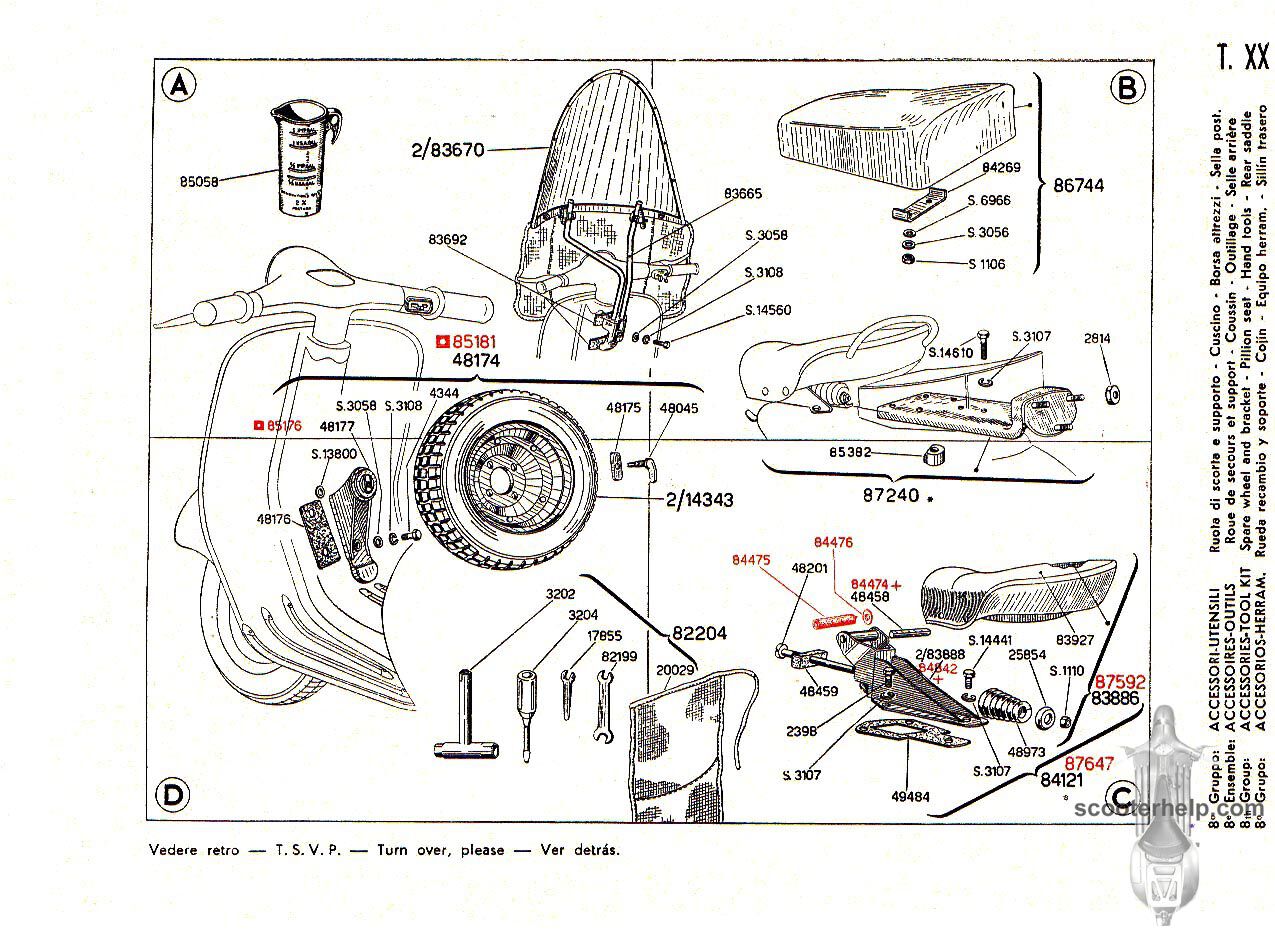

What basket? Can't see anything in the parts lista. P65 shows a windshield that could be the answer?

yes. windshield.

Same here, everything I found seems to mount to the headset. I have a '58 AllState with a screw in that hole and I can't see how a windshield could mount from there without interfering with articulating the headset.
I looked at lots of old windshields, but all seem to mount to the headset. I'd love to see a pic of how one mounts here.
How do you mount an effective windshield from this screw unless there's something more going on...

there's a lot going on - see this pics
https://www.scooterhelp.com/manuals/VNB.parts.manual/65.jpg
looks like twin brackets against the head tube and then the bolt to keep tension

Think the windscreen was a joke.

No joke. Have a look at the parts book link above . Any basket would be aftermarket

Interesting way to mount a screen!
Great find!

Was that again some stupid DOT requirement?? It's crazy to have the screen 'levitating' like that. It would definitely bounce like crazy…

Whats in the hole?
Is it a hole or a tube?
Can you see the back of the lock thru the hole?
Could be related to mounting or removing the lock?

It is for a windscreen. Don't people look at the links provided?
Right there
