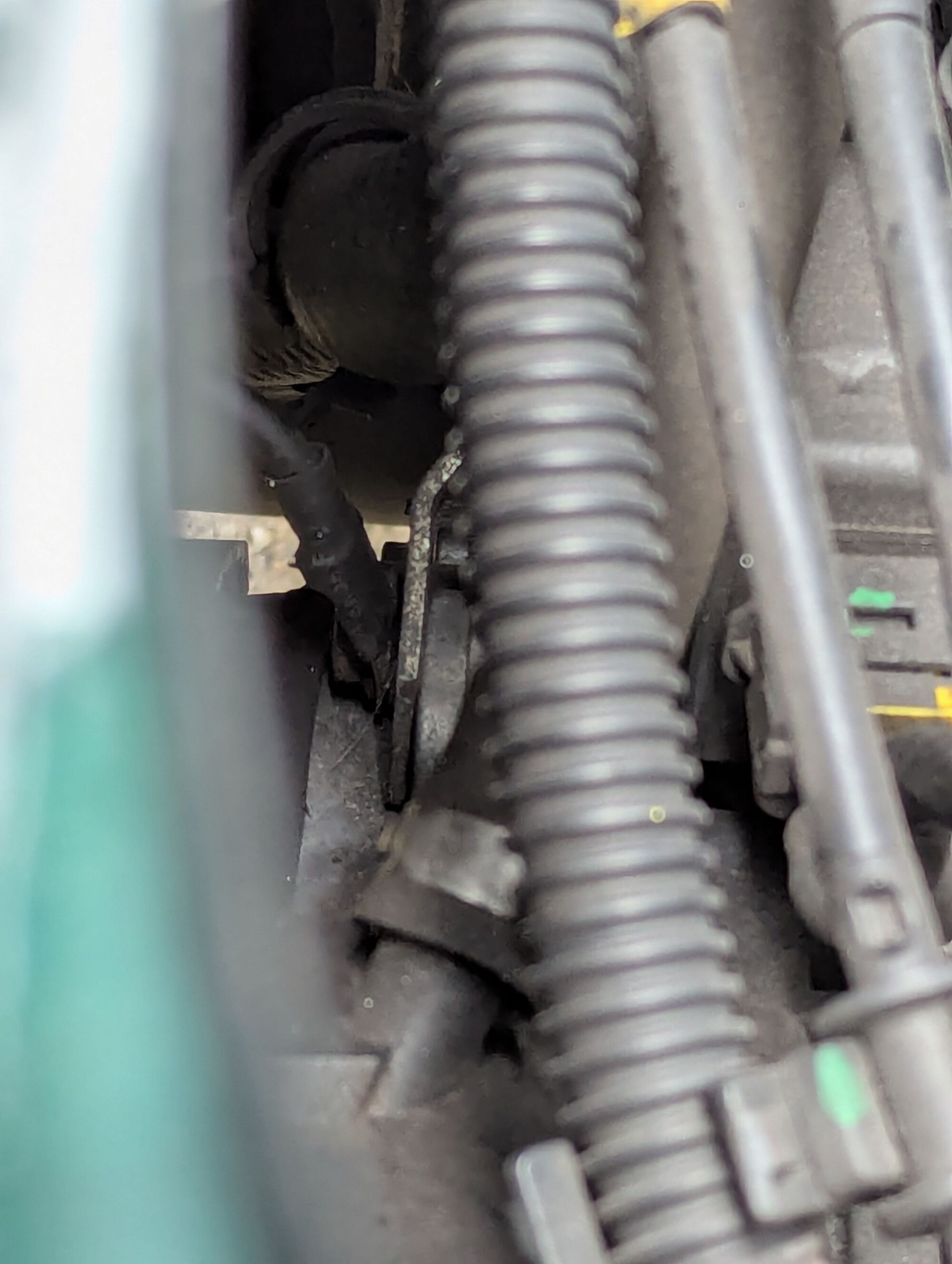

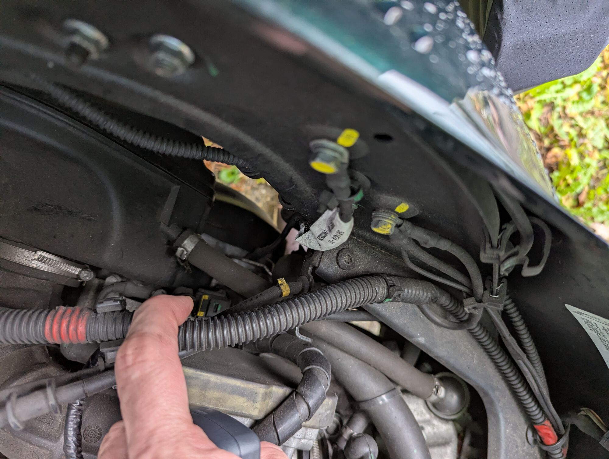

I looked under the bucket and didn't see the connector Robot referenced in his electrical diagnosis video, but I did see the connections marked in yellow chalk in the first photo, and the one I zoomed in on in the second photo. Neither were loose.

I looked under the bucket and didn't see connector. Robot referenced in his electrical diagnosis video, but I did see the connections marked in yellow chalk in the first photo, and the one I zoomed in on in the second photo. Neither were loose.
your first photo is the coil connector. your second is grounding. what connectors were you looking for (reffing a 14min video is not something I can watch in the cafe where I am right now)
Robot said to check that all permutations of a 3 prong connector under the seat pivot read ~18V. It was white in the video, but I didn't see a white connector there in the HPE.

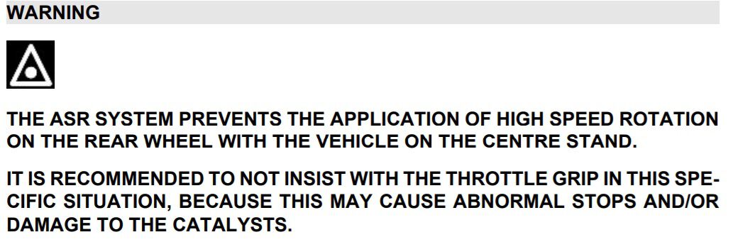

mayorofnow wrote:
I did not.
You must turn off ASR when using the throttle on the centre stand. If you don't then the ASR gets confused because only one wheel is turning and it will then interfere. Even the user manual says to do this.
