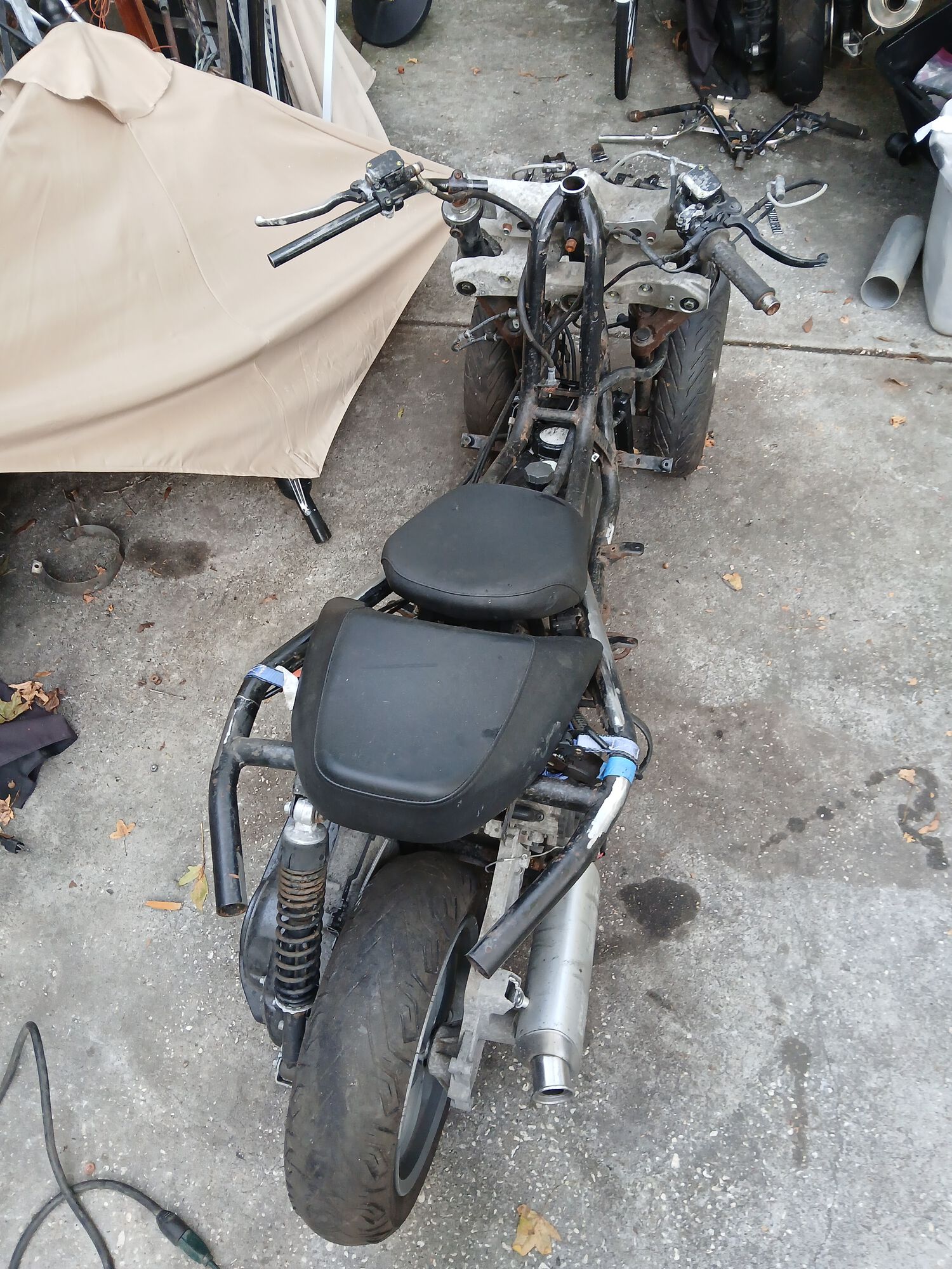

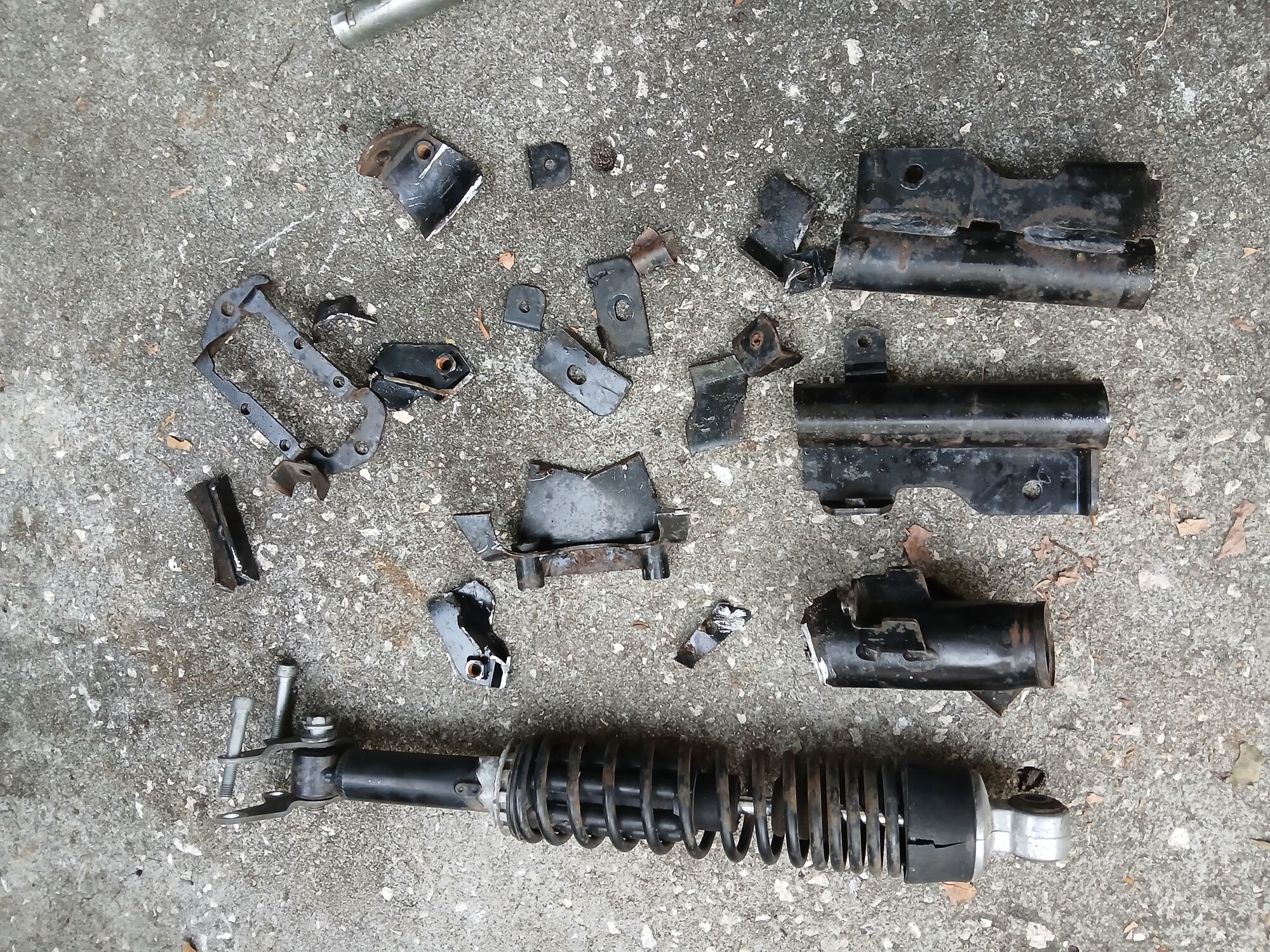

Teasure pic. Goals sub 440lb three wheel. Radical steering mod. Split steering from top of shock towers. 400 frame , hot 493 mill.. Any questions?

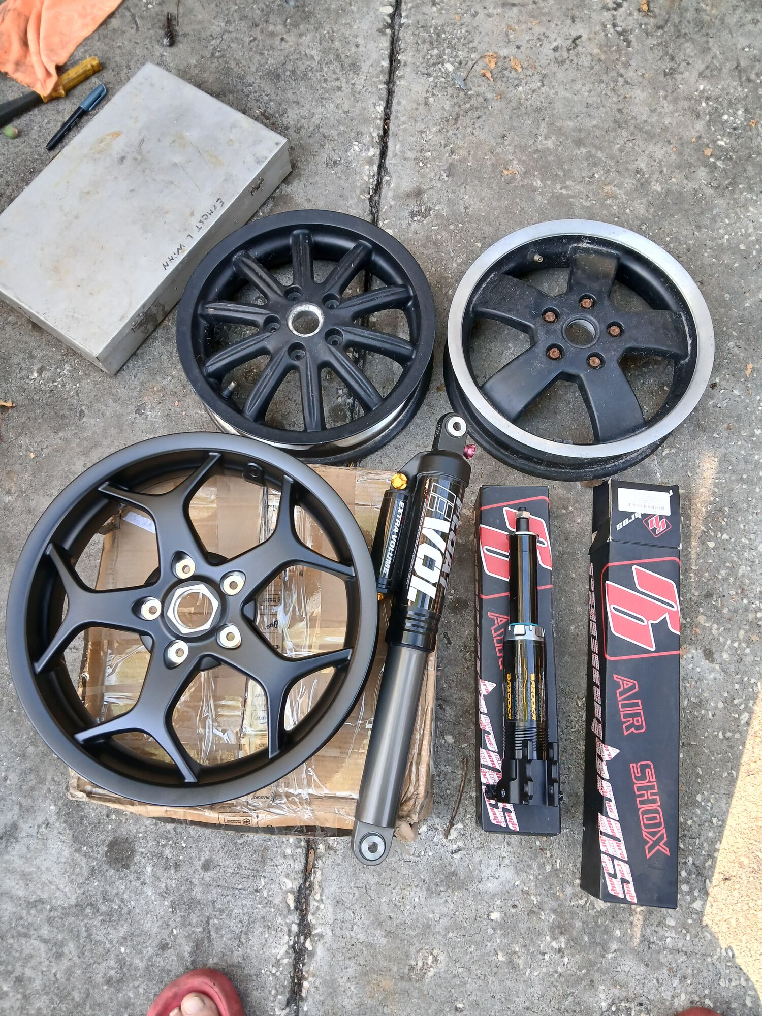

Tires on the way . 150/70-13 rear. 110/70-12 front. Air shocks front and rear.

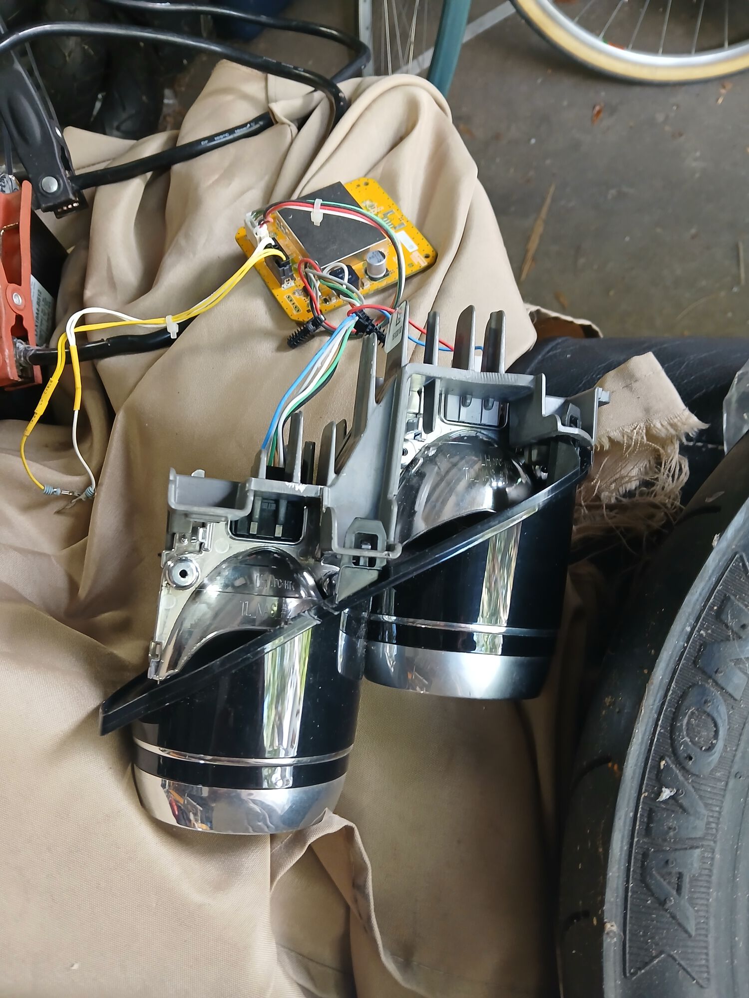

The new steering will be unique in a few ways. Normally when you lean a bike one hand gets closer to ground and the other goes closer to sky. On this both hands will remain parallel to ground. Headlights mounted to front arm will light the road better in corners. Light will also stay parallel to ground. LED light is a single automotive beam. Lights will be split for symmetry..

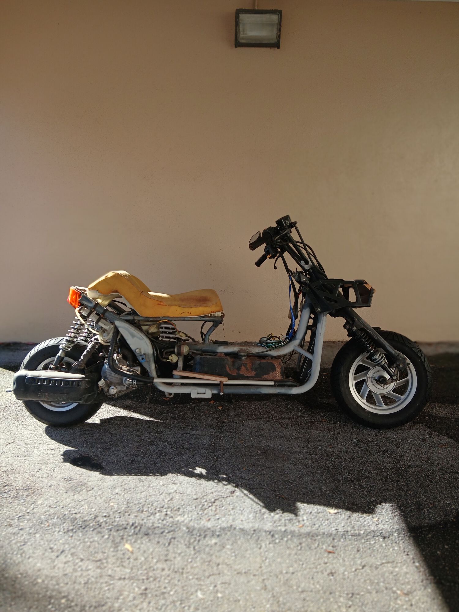

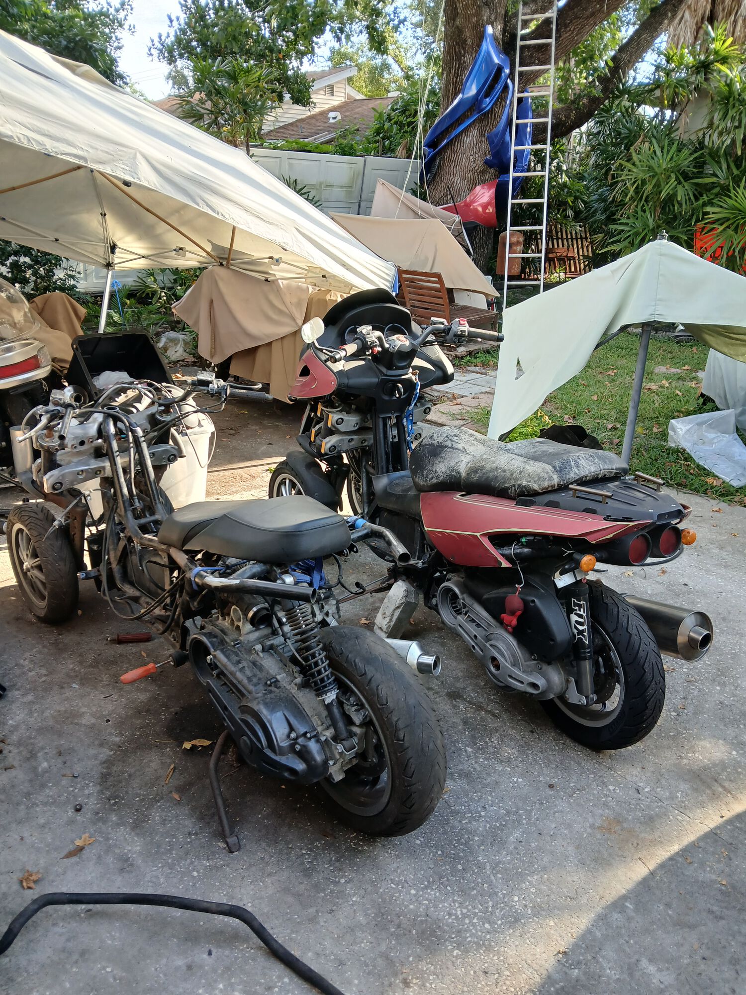

I am addicted with 12 scoots. Half of them stripped naked and ratty. They ratty because they are FUN to ride in lite weight form. More fun to ride than work on. There is 20 hours sitting on this new bike, Just considering different steering options. This bike will be show quality. Frame will get high quality paint. And every part restored to beauty. The project will go viral when finished. Too unique not to.
