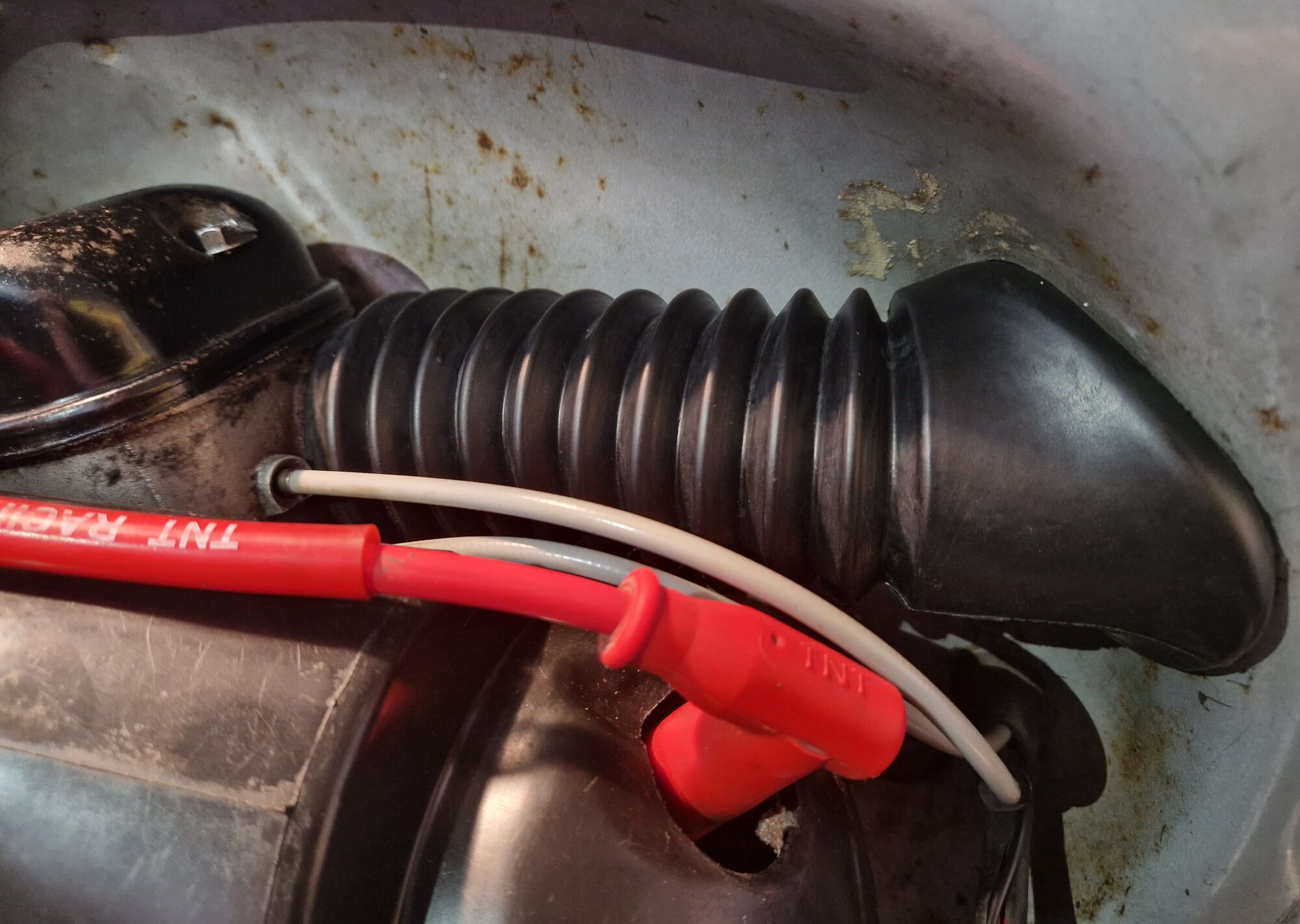

Gravelrash2004 wrote:
Such an easier way to do this
Ill try this next time I habe to change one.. royal pain in my b... these have been for me over the years
Give it a try... it makes the job way easier. I mount it with the carb completely assembled, like in the pic.
