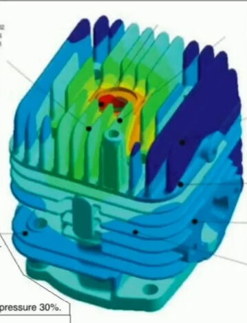

Jack221 wrote:
I was impressed by this test. Jetted well still it stays cool with low airflow. Something like 260 to 300F.
Wow.
Notice how the temp readings change at different targets on the cylinder?
Of course, the top center of the head is much hotter than anywhere else.
Heat map of a 2 stroke pavement stamper. Dark blue is 78C. Red 270.
