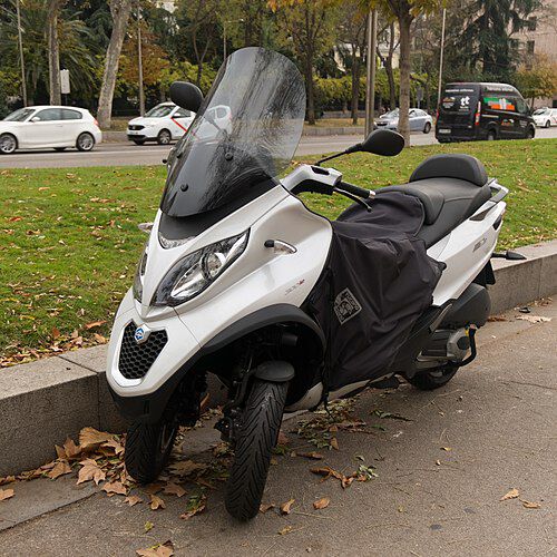

If it looks like the mp3 in the pic below then it is a gen 3 bike.
