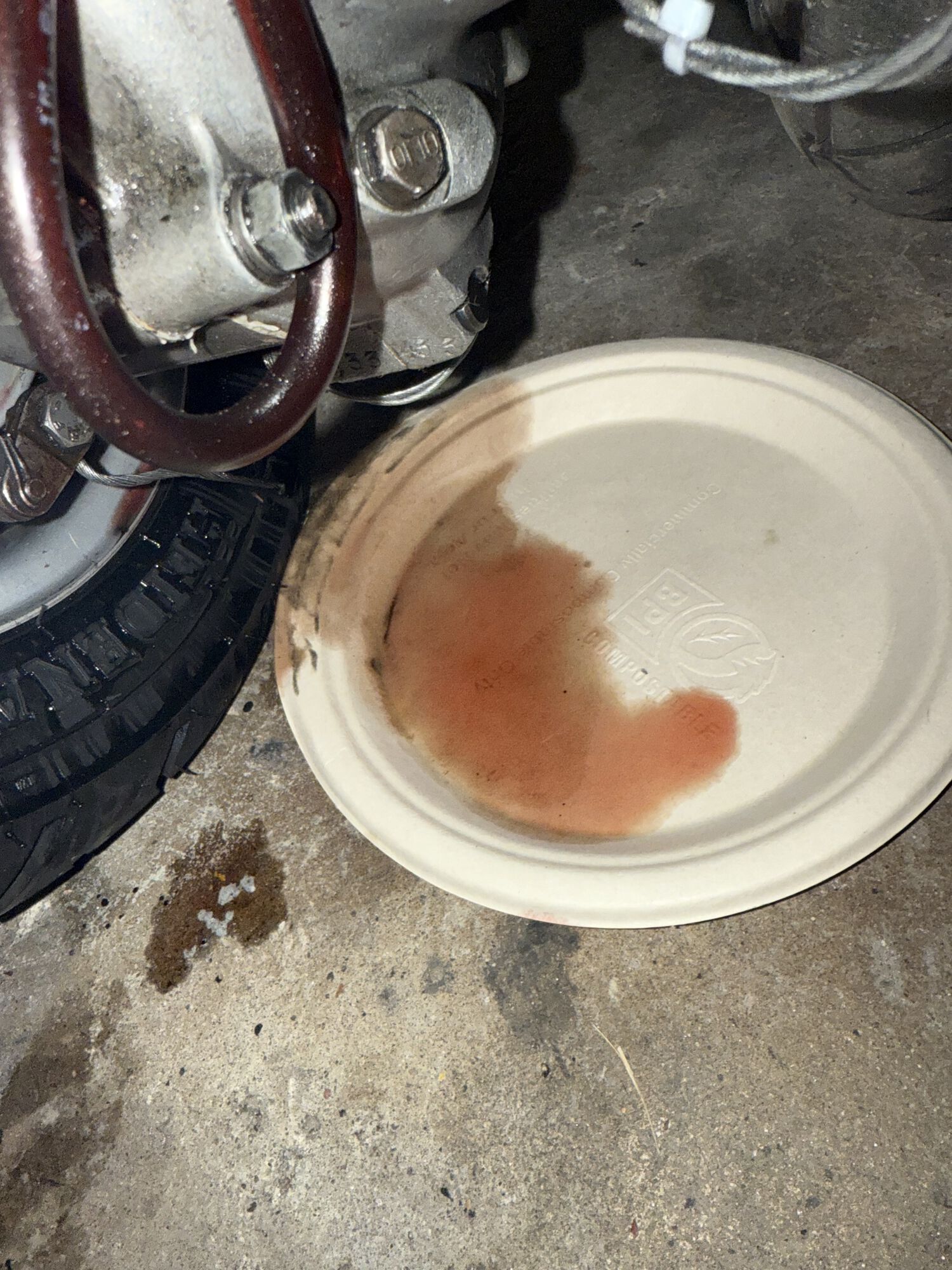

Got a head scratcher for the collective.
It's 100% two-stroke.
I'm thinking it has to be from the autolube pump … but why and how's it getting out?
Scoot runs great. Just rebuilt the engine, all gaskets and seals are brand new. Starts and runs great. No symptoms of any air leaks.
Just this drool of two stroke.
Anybody?

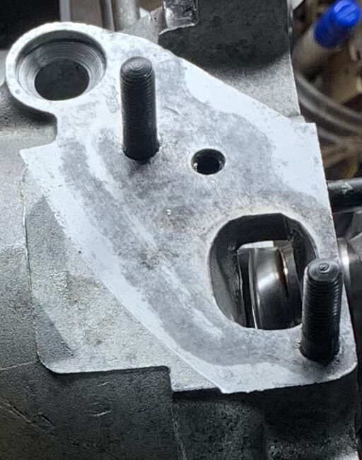

Little update …
Drooling stopped with the oil line disconnected. So, best I could tell, the 2-stroke was somehow making its way thru the oiler and dripping out from under the back corner of the airbox on the wheelside. Why exactly, I don't know. Box wasn't loose. Might have something to do with the amount of oil in the reservoir and the scoot being on the side stand. Defective gasket maybe? I can't explain it.
Cleaned everything up, squeaky clean, put a new o-ring on the autolube shaft, replaced the airbox and carb gaskets and snugged everything down. Drippage seems to have stopped for now. We'll keep an eye on it.

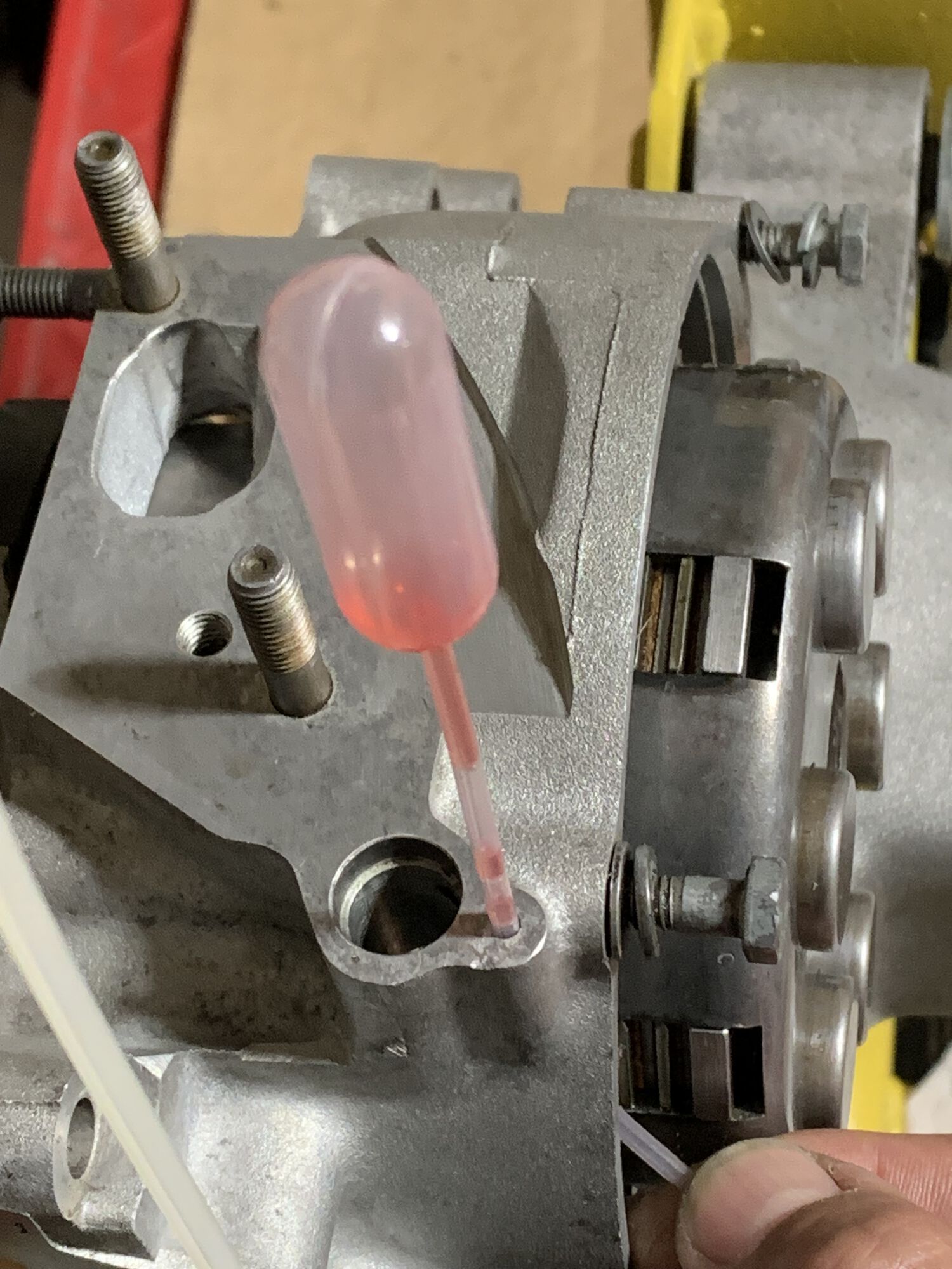

Did you check the little passage right next to where the oil pump drive shaft pokes out of the case? It's in the back corner on the wheel side. When I did my engine rebuild that passage was clogged with black sludge. I would think that passage returns gear oil and not 2stroke oil.
Hec
Oil return passage clear?

Thanks, good tip, but that passage doesn't exist on pre-P series oil injected scoots (Rally, Sprint & Super). They use a slightly different autolube system - different airbox, different pump.
https://www.scooterhelp.com/tips/engine/oil.mixer.old.vespa.html
