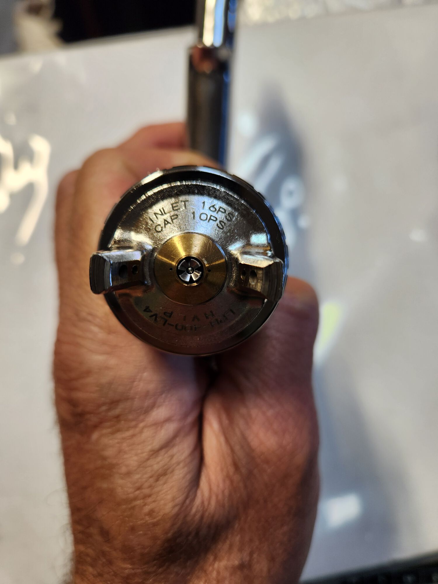

Here's the cap on my lvlp and the inlet pressure on my mini. The cap pressures are almost always close to 10 psi. I wouldn't steer you wrong.

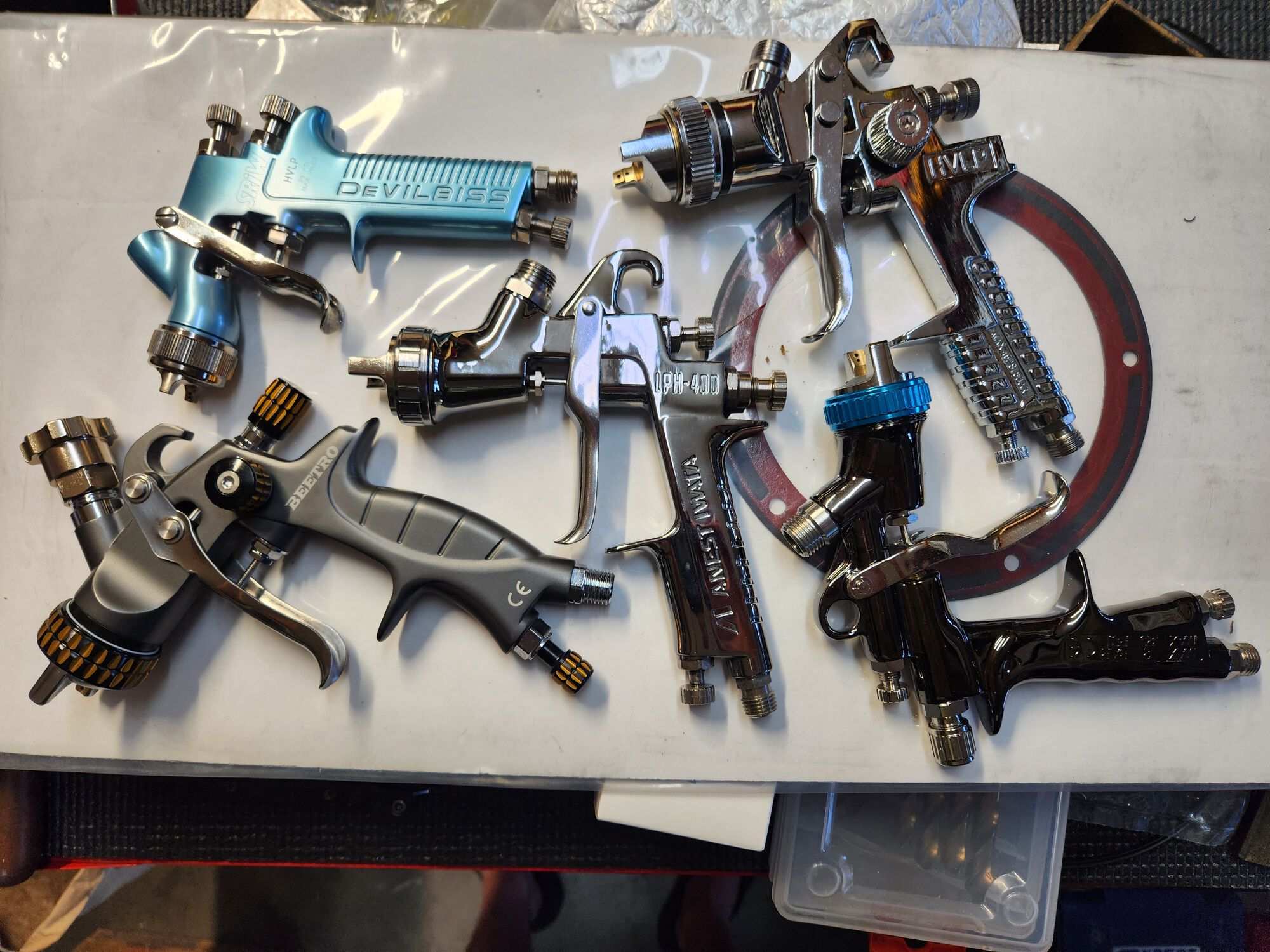

Here's my arsenal. The two on the right are for shooting metalflake. Except the lvlp in the middle, the rest need between 29 and 45 psi to get 10 psi at the cap. For what it's worth.

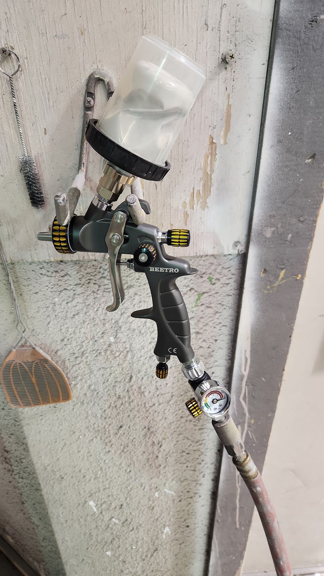

This is my dedicated primer gun. It came with a 1.4 and 1.8. Couldn't be happier. I think it was $130. It also came with a regulator.

I like that little regulator.
