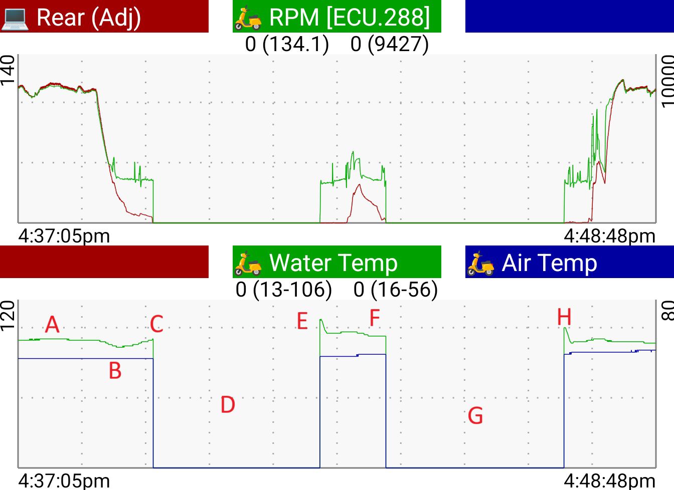

Here's some data from a long 721km day ride several months ago:
A. Many hours of 110-115kph on the freeway holds the temp at 91C. At 100kph it will normally sit at 86-89C, ie that little bit of extra speed is making it harder for the cooling system.
B. Cutting the throttle and drifting in to a pull over area rapidly drops the temp to 86C
C. Less than a minute of idling a heat soaked scoot rose the temp to 91C
D. Three minute bathroom break
E. 106C. Yup, the temp rose 15C with the engine stopped for 3mins. How rapidly did it go up in that gap and how high? Shame I hadn't used the kill switch and left the ign on which would leave the record running.
F. While moving the bike to another part of the carpark, the running engine drags water from the front of the bike cooling the engine back down to 94C. Still well above normal.
G. A three minute break for a drink and snack.
H. Again with the engine stopped the temp had risen, this time to 100C. Followed by dropping to 92C as I drive off as it gulped that cooler water from the front
A caveat that *only affects idle periods* for this discussion, is the bike was idling high due to an air leak. I was waiting for the new intake hose to reply and riding anyway.

Did the fan kick in at any point ?
Posts: 8035
Posts: 8035
I'm pretty sure i would have used the manual fan switch to turn it on during that idle period.

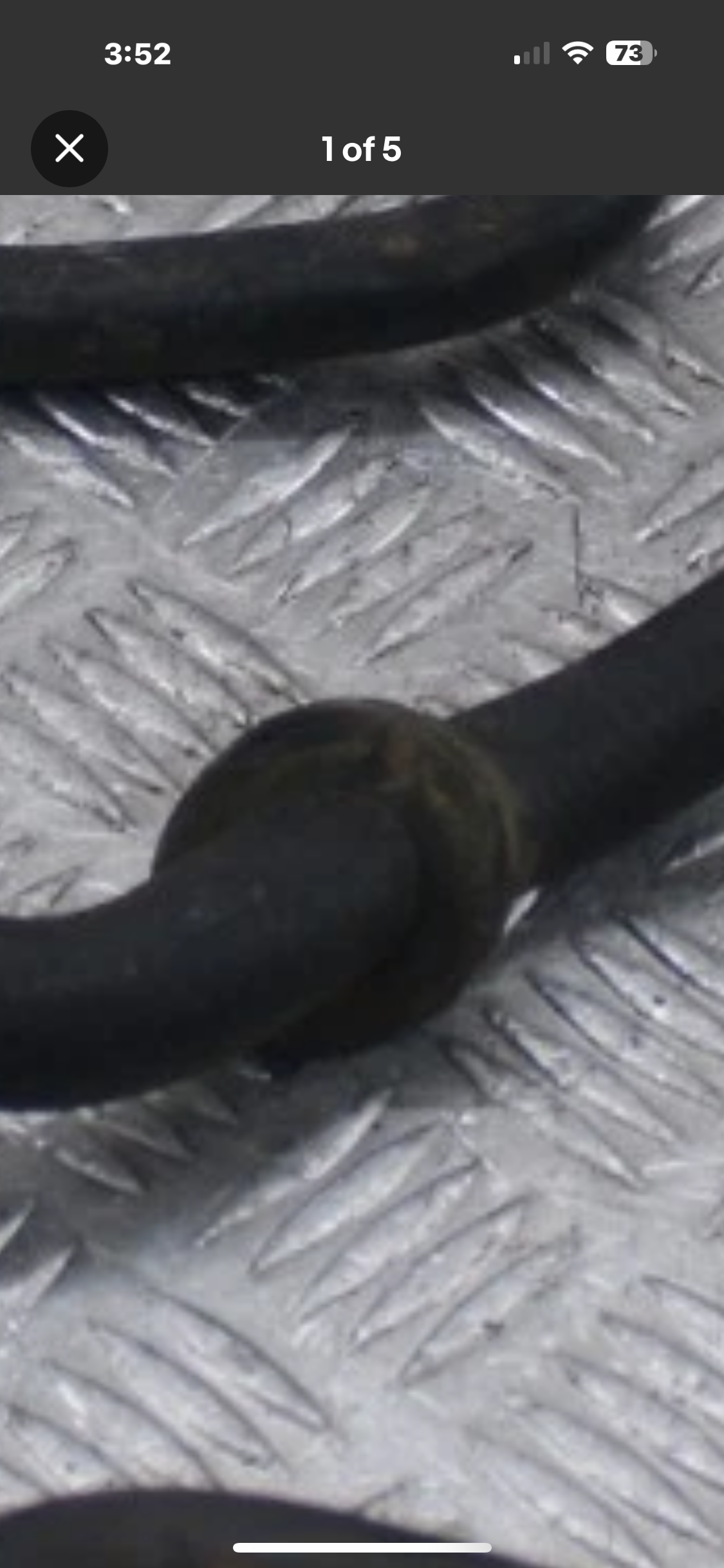

I ordered the larger carrier from sip
I will swap coolant after I change all the hoses to my silicone version 3ply.
I will mfg a silicone grommet to seal the hoses to the frame there are two per install.
Larger o.d.
Softer for better seal
Silicone for better life

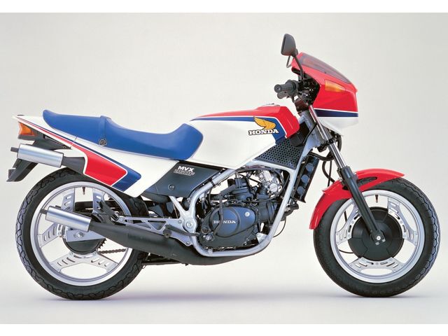

MVX250
