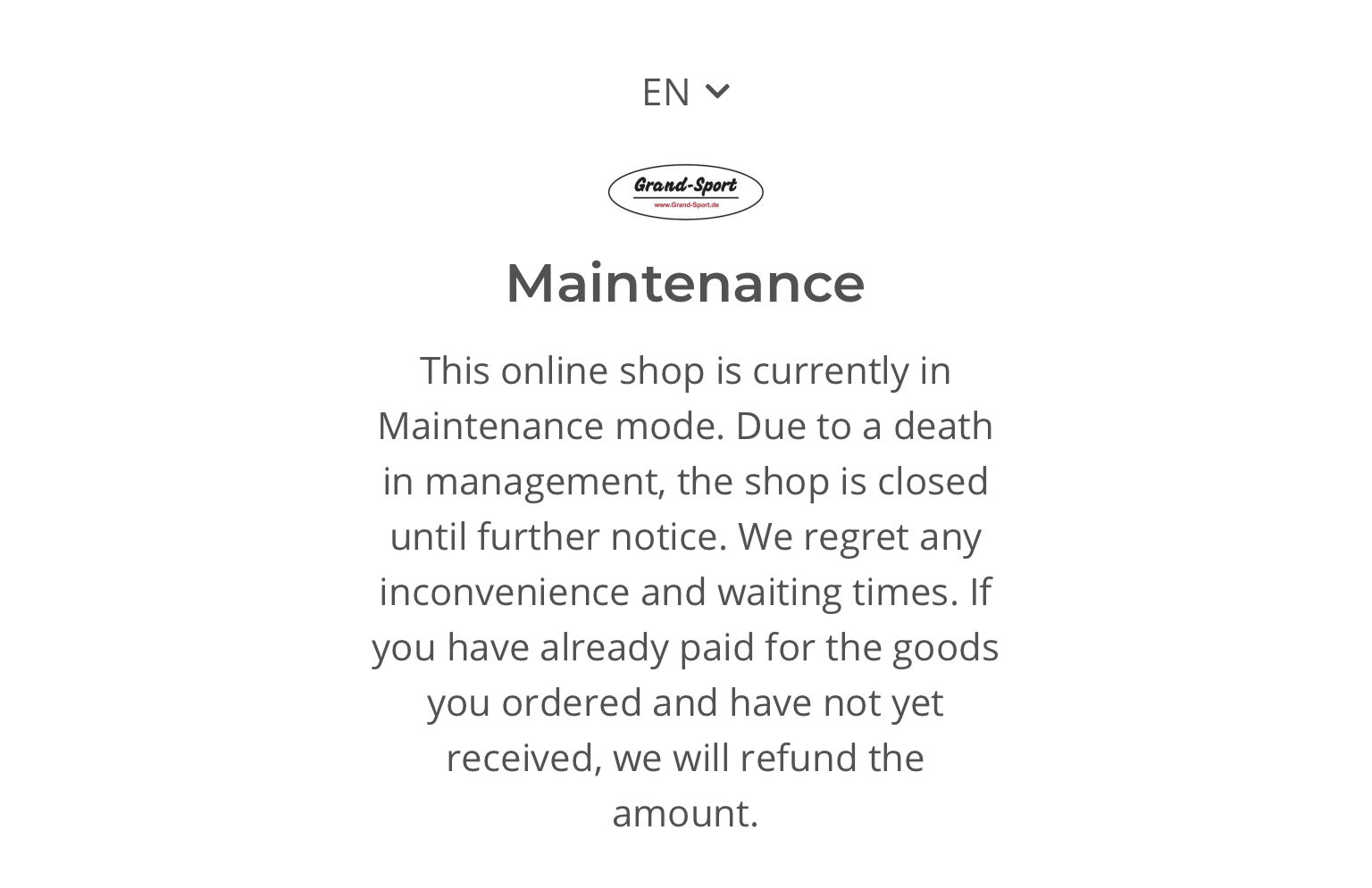

My supplier told me that the owner moved to Taiwan and got married to a local. He now works for SIP supplying parts made there. Apparently SIP brought all stock. On their site though they have the following announcement…
@ginch avatar
Posts: 9525
@ginch avatar
Posts: 9525
Shame. They did good stuff.
