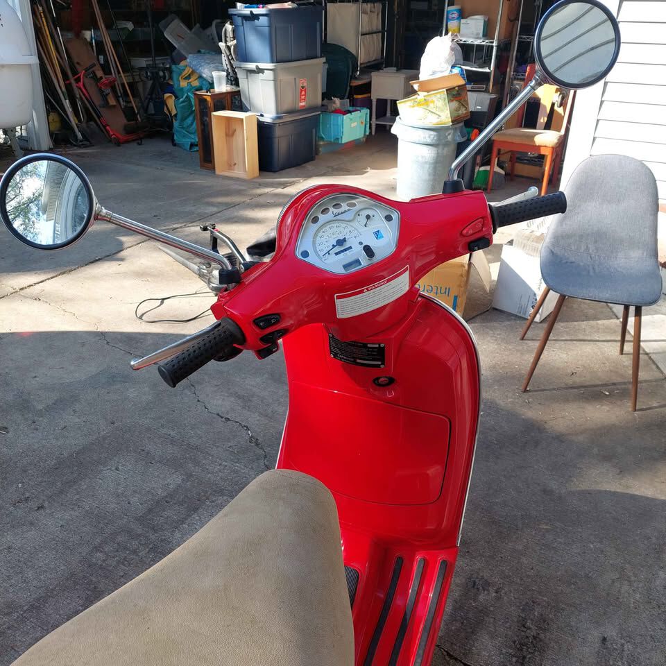

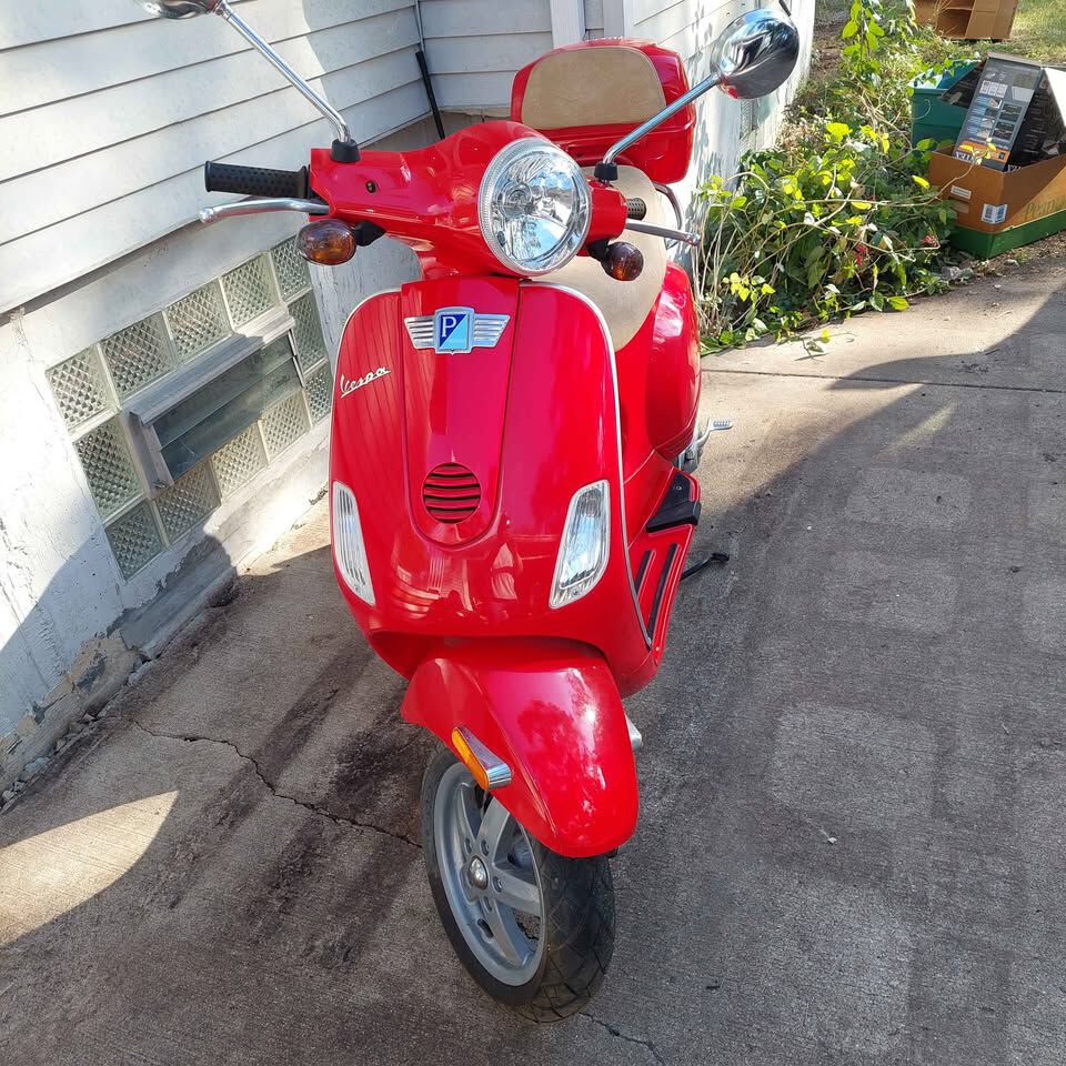

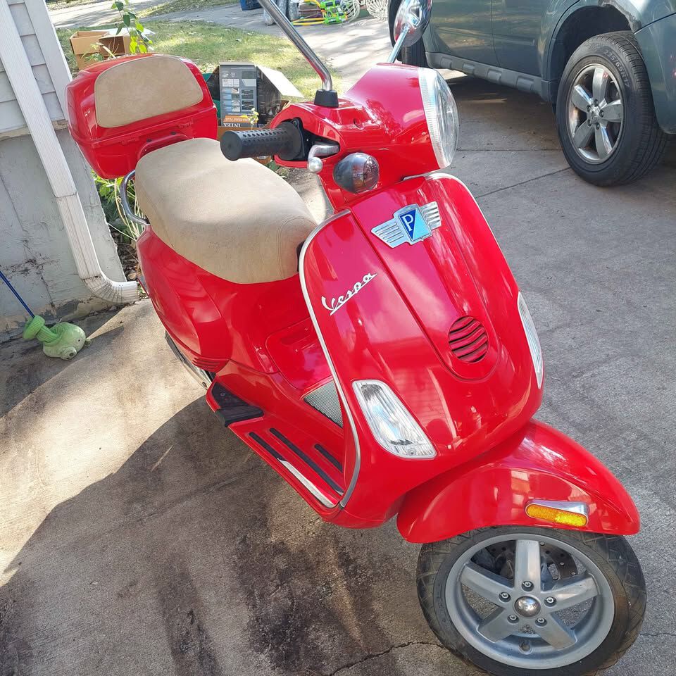

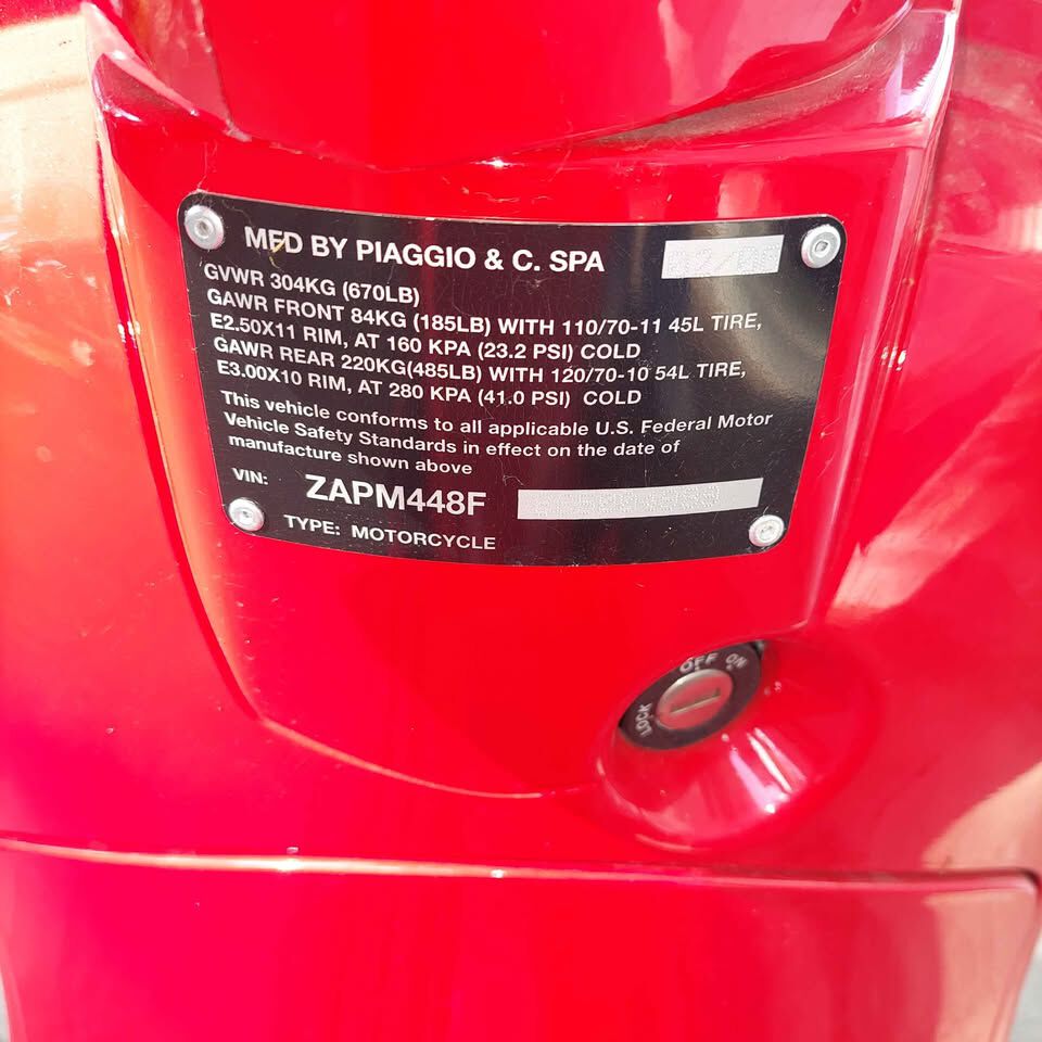

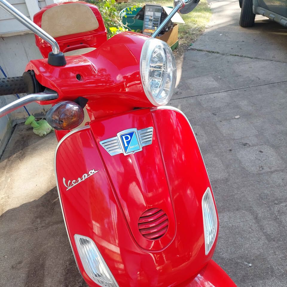

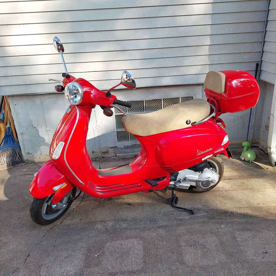

Based on the photos and the following...
- no title
- no keys
- unknown mileage (I haven't asked yet)
...what value would this have to you?
...what options are there to re-keying and how costly?
...I know the latch trick to open the seat on a GTS, is it the same on an LX?
...is there a way to open the top box without a key?
I've gotten bonded titles before, so not really concerned about that, its just a process. This looks like a beauty and is worth saving, but could be more of a project given above. Appreciate it.
