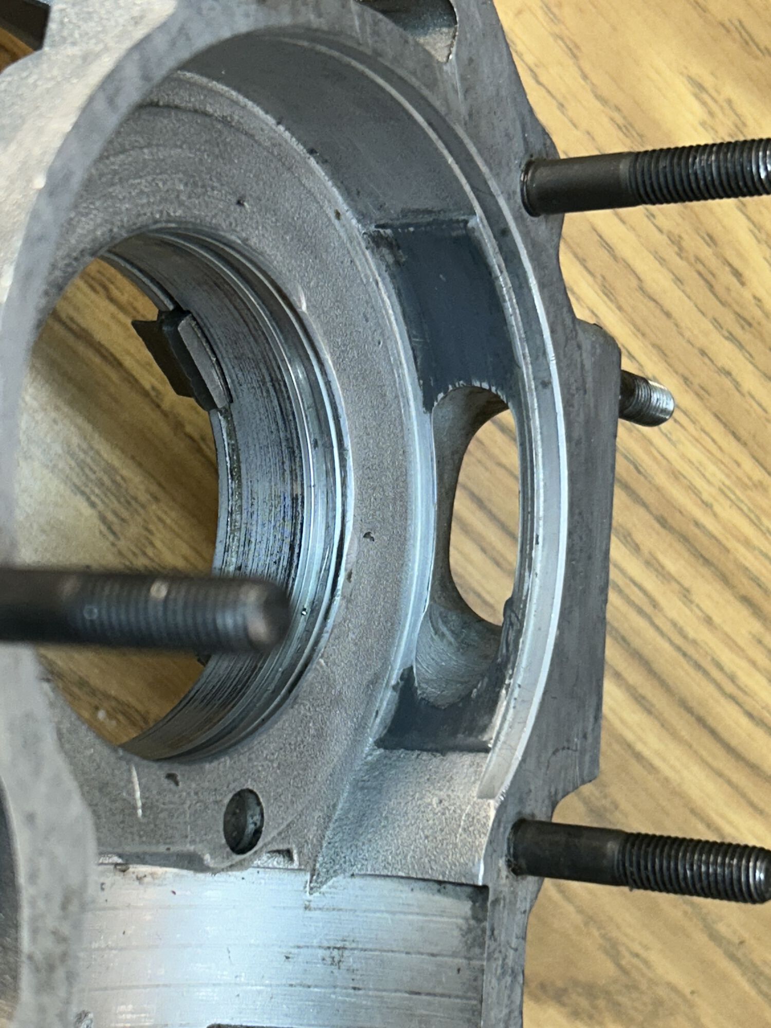

Bone stock except for a SIP R2, 26/26 autolube carb and short 4th. Jetted to 52/120 140, BE3, 119 (I think) main as advised by Jack. Changing the jetting helped a great deal with engine vibration. New 57mm Mazz crank, new stock Piaggio top end. Completely rebuilt and leak free. Somewhat scored rotary valve repaired with JB weld.
It's slow. Easy 50, but 55 is a conscious push (GPS). Revs out to 6500 in 3rd. Won't crack 6k in 4th. It doesn't splutter rich at max revs. Low end torque is adequately stock.
When I built this engine, my tuning efforts on other engines weren't going so well, so I deliberately kept it stock. My thinking was that I was doing something righteous and pure and would end up with a cool and reliable engine. Mission accomplished, but damn…it's a dog. Even by stock standards. And I have no idea where timings and squish ended up.
I'm looking for an easy cruising 60 for this bike with a reachable top speed of 65. That'll do it for me. I would like to keep the stock clutch, brakes and otherwise keep it simple. Looking for a path of least resistance winter project that will get me there.
Thanks for reading along.

A 26/26 isn't stock. A 24/24E jetted in with a 160, BE3, 125 main, 55-160 is good for sea level to about 3500'+ elevation (at least for me). Flow the carb to the mixing box and then the engine case. A short 4th and a Sito+ will get all my stock P200 scooters to a true 70mph on a flat if i have a windscreen installed…but only if there's no headwind!
The only wild card for me is the JB weld on the rotory pad. Just make sure you got the correct clearance with it. I guess the Mazzi crank could be a wild card as well, but i doubt it. I'm not fan of them.
Timing is correct and I'm running a short 4th. I did run it for a bit with the original 24/24. Seemed about the same if I remember correctly. The rotary had some grooves in it where trash went through before I owned it. Most of it was intact. When I repaired it, I bolted the case together with the crank and a dummy bearing. I think I used a feeler gauge between the crank cheek and pad with some release film.
I agree with the kit vs O-tune argument More work and no real cost savings. Would probably need a GS piston too.
Any reason for recommending the Ranger over the Malossi Sport? I love the Sport on my VR-1 case. Lots of torque. Speed available anytime, anywhere even in 4th on a hill. If it's less revvy, it's not at rpm's where I ride, so I don't miss them.
