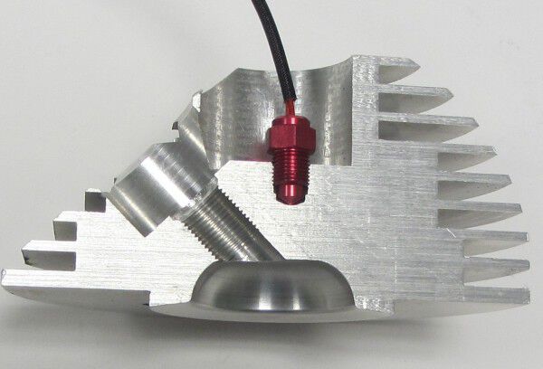

Unlucky, in that this CHT port gives #'s unlike what others with under the plug sensors consider "safe." This sensor's readings are VERY different.
Highly suspect we're dumbing down these kits too much.
What's your max CHT now?
I'm at 325F. The Lemarxon X234 atomizer dropped it 40F with no other changes.
*Don't widen the inlet. Too risky.
Thanks Ray
"Whats your max temp?" Is very difficult to answer 😂
When Im crusing at 60 on a rural country road it will show around 300 Fahrenheit. 350 when im pushing it.
I set the rev counter to turn an led red light when it reaches 350.
But unti I seize it I cant judge the max temp...🤣

Robbie 11 wrote:
Thanks Ray
300F is operating temperature with this sensor, maybe 220F(?) under the plug.
Rode for a bit with both just to see. Really frustrating experience.
The readings are not parallel between the two, and under-plug CHT comparisons should be disregarded.
I rode quite a while stuck on the hwy with a head leak at 420+ a few years ago.
Pulled the cylinder, nothing. There are a few similar experience posts on the GSF.
Pre-2021 pistons are different vs the newer version.
They piston slap up until 300F or so.
