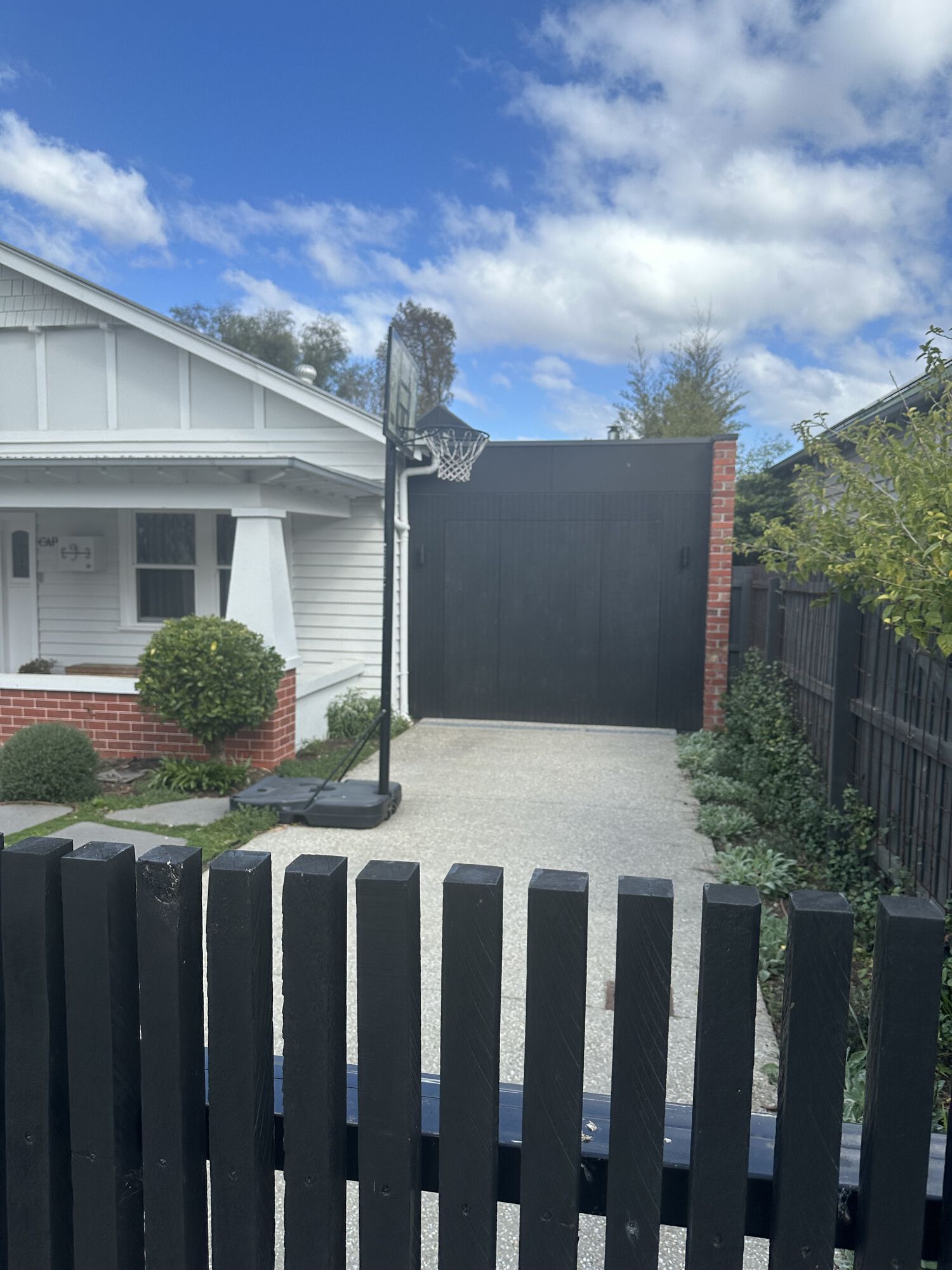

I moved to a new house this year that doesn't have a garage so need to build one. I am going to use it as my dedicated Vespa workshop and storage for around 4 bikes. There isn't enough room for a full car sized garage as we have limited space. The foot print will be about 4.5 meters by 2.9 meters.

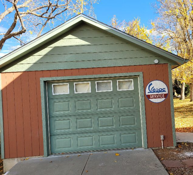

You're not planning on a standard 8 foot ceiling? The popular Harbor Freight lift reaches 29.5 inches off the ground. Are you planning on standing up in your shop? I built one a while back. I wish I would have made it a little bigger.

My ceiling height is a flat 2.4 meters. To be honest, I could probably lose 10 inches of that and still be fine. I'm 5'-11" and have plenty off room. Draw out a quick side view with dimensions going for the best aesthetics with existing building. See where you end up, and start tweaking from there.
