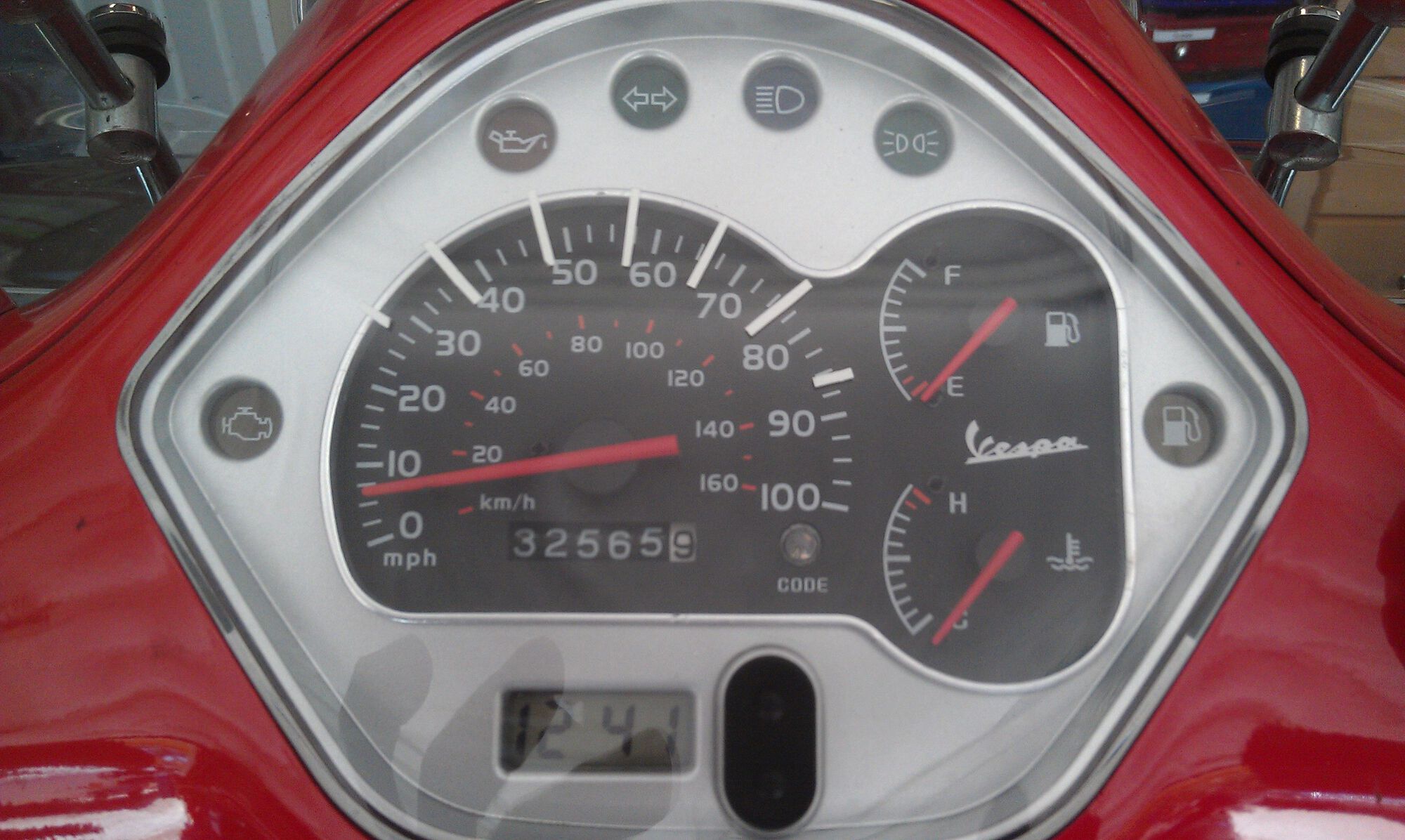

On my US GTS:

Looks like you're running very slow on an empty tank. How do you keep your water temp so low?

Those are the 20, 30, 40, 50, 60, 70 and 80 mph true GPS marks.
Being an analogue magnet-driven speedo, it starts at just over 5 mph because the magnet doesn't generate enough eddy current (and thus the opposing force) to get the needle's hidden disc to start moving until then - plus it's almost illegally optimistic at the lower end.
