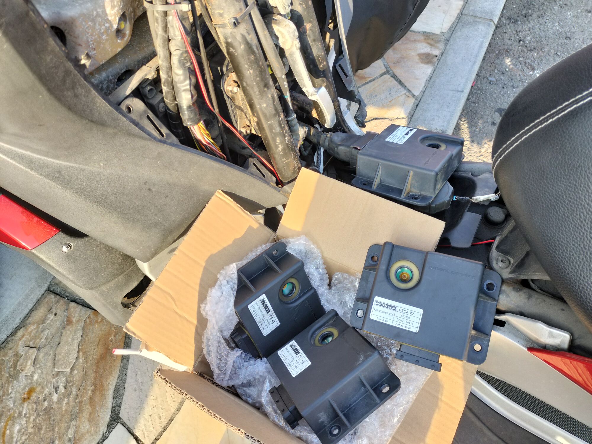

3kΩの書き間違いです。スミマセン。結局家に持ち帰り、予備のロールロックecuを3個を使い検証しました。しかし症状は変わらずでした。何度かコネクターを抜いたり挿してるうちに直ってしまいました。搭載しているecuを含めて4個検証しましたが全て正常に稼働しています。接触不良を疑い接点復活剤を使いコネクター類は全て清掃しました。少し腑に落ちませんが直ったので様子をみてみます。

What is the loose wire running next to the main wiring looms?
Perhaps it is just the picture, but that wire looks pinched or damaged in a couple of spots

The wiring you see on the side is a USB connector added by the previous owner. It was removed before the problem appeared. I slept on it overnight and thought about it, and it seems the radiator cap was loose, causing coolant to leak. It's unlikely, but I think the radiator fluid overflowed when accelerating and got onto the connector and wiring, causing the leak. I'll run it for about a week and report back.

It was completely fixed. The roll lock unit is MAT, the throttle body is original, the stator coil is from a 250, new ignition coil, new plug wires, new plugs, new speed sensor, new O2 sensor. My impression is that it's a physical problem, so it can be fixed by touching it. However, there are more sensors than a GTS, so the failure rate is higher. That's why it can't be repaired and is dismantled. There are plenty of parts on the market. My English is poor. Sorry.

Does anyone know of this symptom? Roll lock won't work and the car can only go up to 38km/h. After that, I replaced the roll lock ECU and it was fixed. The ECU was in stock when the problem occurred. It suddenly broke about a week after I started using it. Does the roll lock ECU need to be synchronized using a Piaggio diagnostic tool?

wrong version if its newer version you need a update for the other ECU's
Also could be that you didn't solve other problems speedsensors Pot meter microswotch fault seatsensor
a 300 doesn't have safe mode i did have a customer that did have a blocked air intake did no more then 60 km/h on a 400

Thank you for the information. Was it necessary after all? Do I need pads? Is there any diagnostic equipment I can use instead?

Since replacing the original Roll Lock ECU, it has been running without any issues. The engine misfire was caused by the pickup coil. The manual stated it was 116, but replacing it with a new one improved the symptoms.[img][/img]
