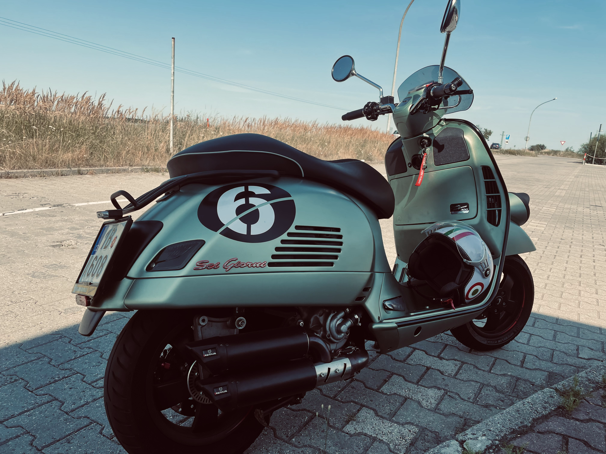

Hi All,
I have a lovely Vespa Sei Giorni.
I have made a nice upgrade to look and now I would like to upgrade the Performance and ride:
My main question is:
Is it worth swapping the engine from Quasar to HPE Euro 4 which has better potential for power performance upgrades?
The upgrades I am looking to do this winter:
- 13" wheels
- New brake system (I am looking at Ottopuntouno 4 piston), also considering the bigger from discs.
- BGM or Bitubo suspension
Engine. Still deciding if 282 big bore with V4 head would be enough or should I go and swap the whole engine for newer HPE?
My other option would be:
- Malossi 282 V4 kit
- Piuaggio 300 Super Torque
- Malossi Ventilcat
- CDI Force Master 1
- Malosi Maxi Delta Clutch.
What do you think?
Any advice welcomed
