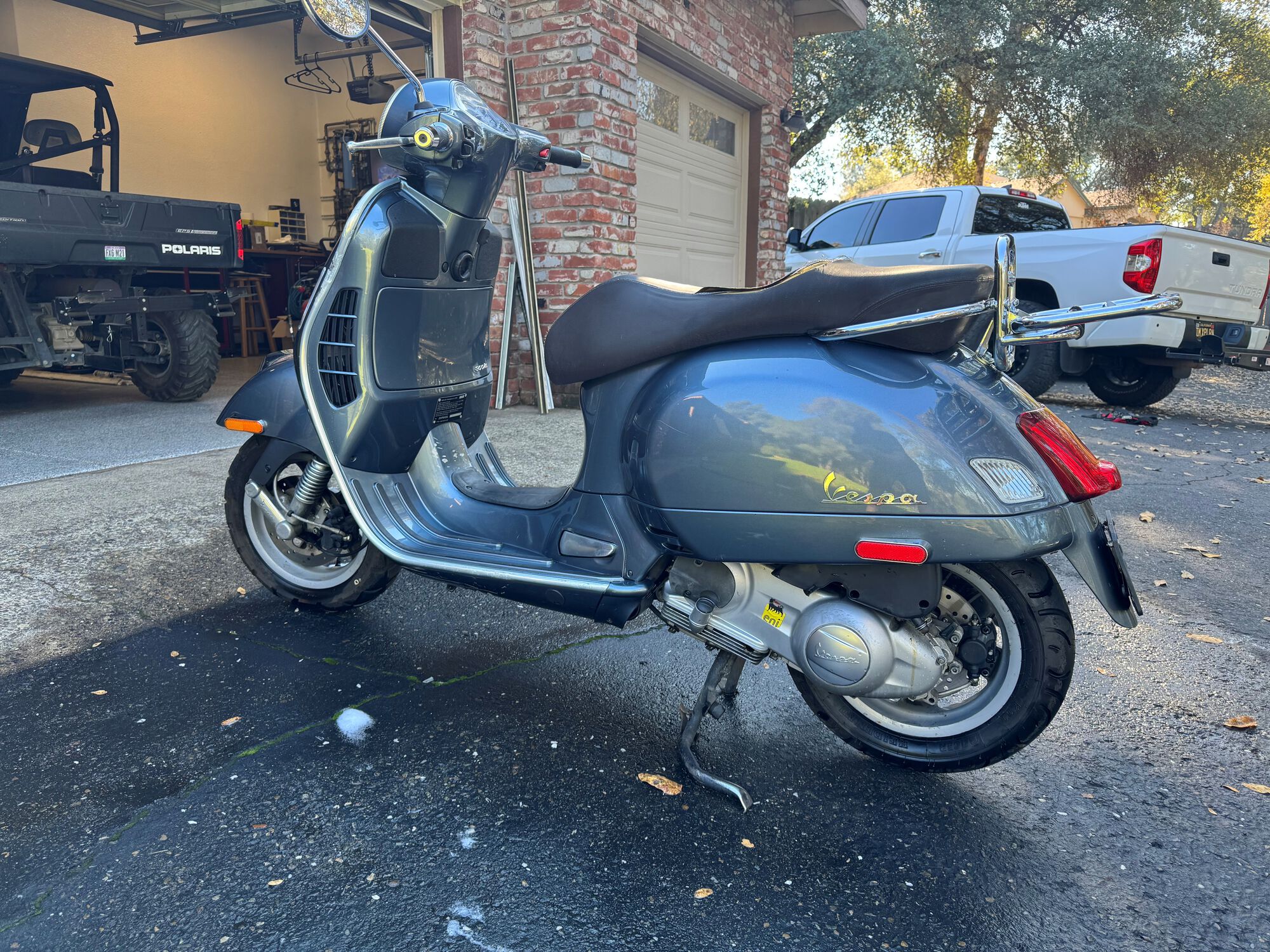

Nice and clean
Nice and clean

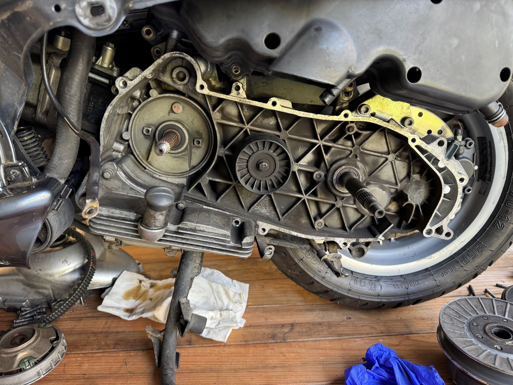

Ready for surgery
Ready for surgery

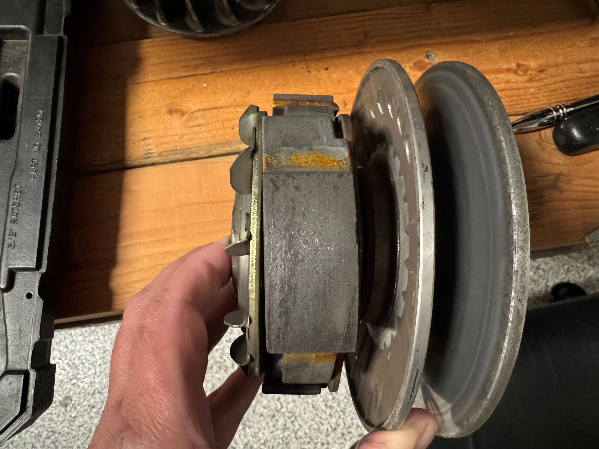

Clutch pads are crooked.  I'm not sure if this good or not at this point.

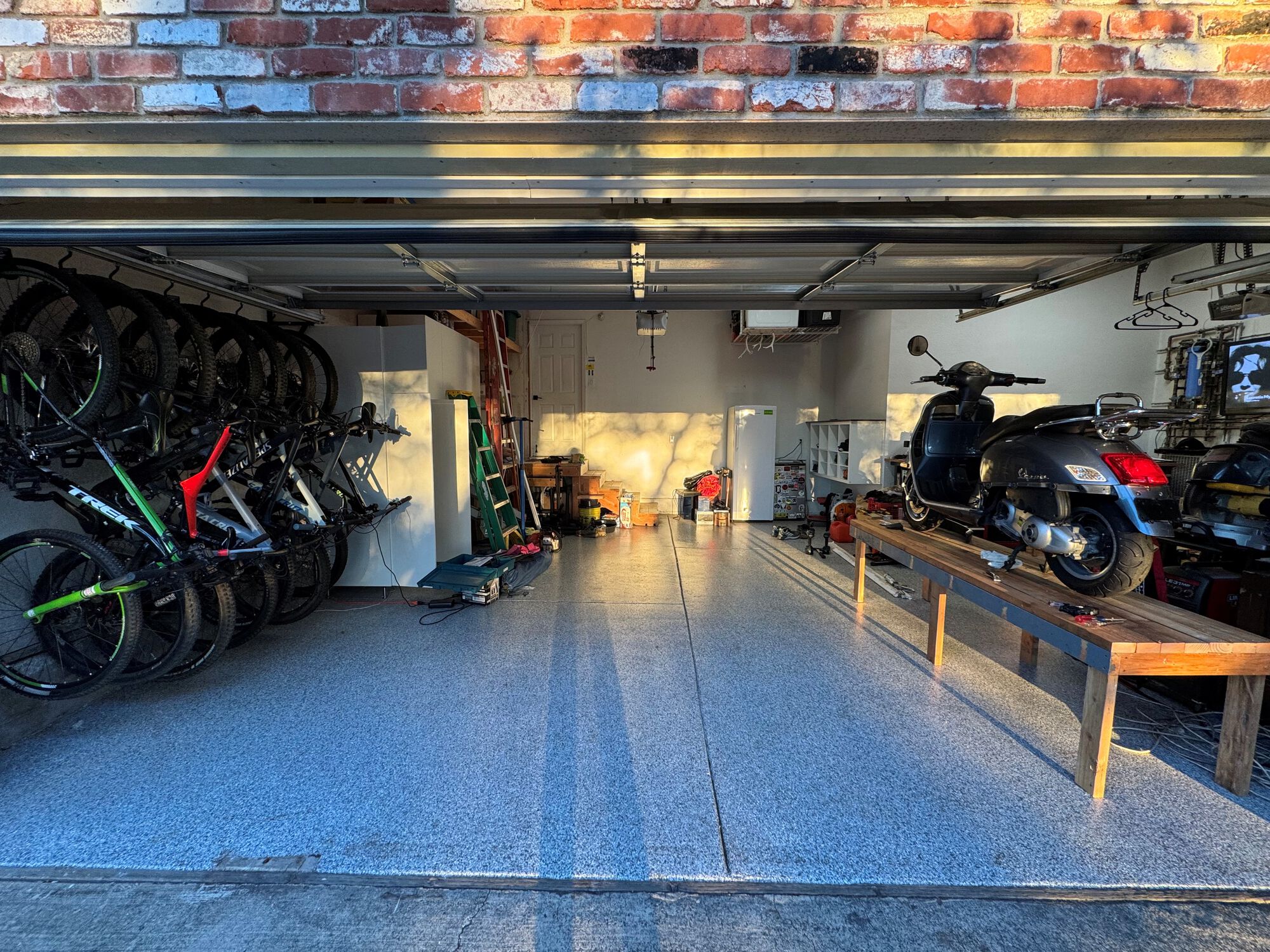

My apartment is not as clean as your garage.
1962 Lambretta TV175, 2001 ET4, 1972 Honda CB350 1969 Honda CL350
Posts: 333
Location: Rescue, CA
Posts: 333
The garage is actually a complete mess right now. It's been a work in progress since we moved in to this house last year.

I have not had much time lately to jump in and diagnose this more. But I did rule out the clutch. I put the variator/rollers back on and ran the engine without the belt for a moment and the noise was still there.
?si=ysSZBUHGgXLNdh1S
@xristos avatar
Aprilia scarabeo 300 aprilia sl1000
Posts: 95
Location: Athens
@xristos avatar
Posts: 95
Location: Athens
I think that the rod bearing is damaged. Did you find any metal flakes in the oil? Check also the camshaft chain tensioner before digging inside the motor.
