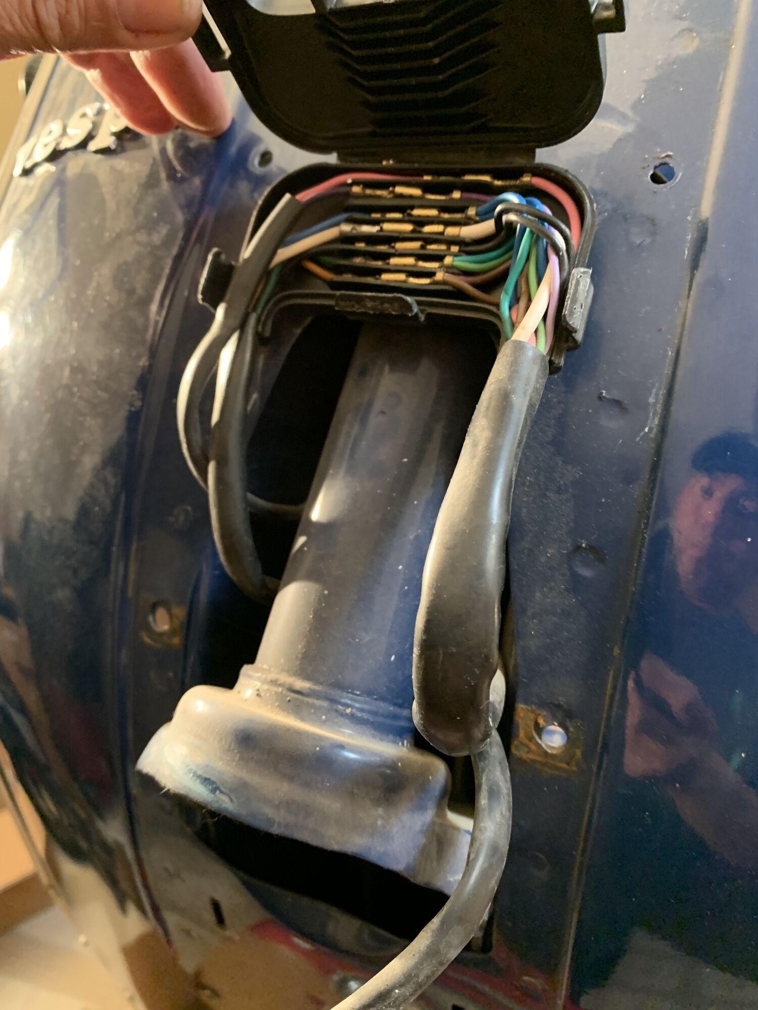

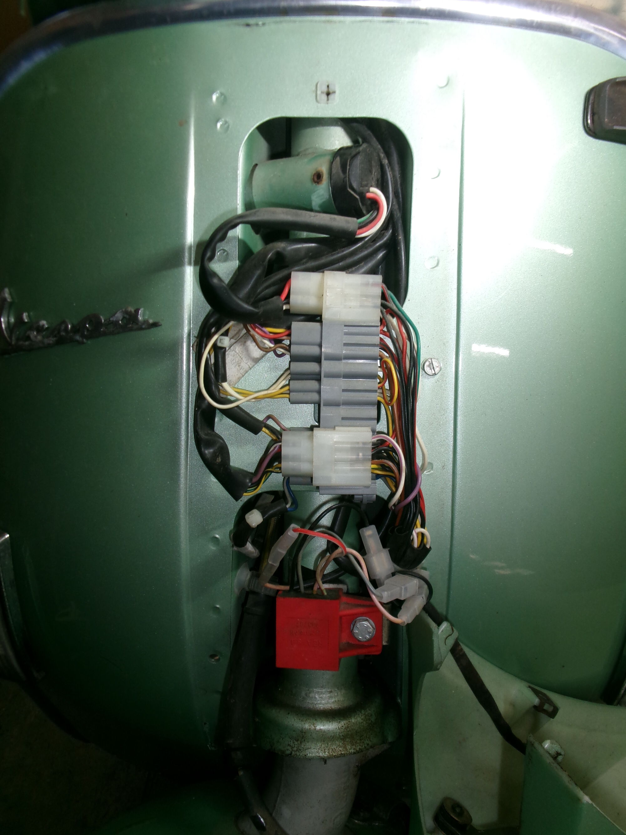

I would next check for voltage at the front wiring junction box. You will need to pull the horn cast off to access. Maybe something got disconnected there. If all is good there then move on to key switch.
Hec
Front wiring junction box for reference

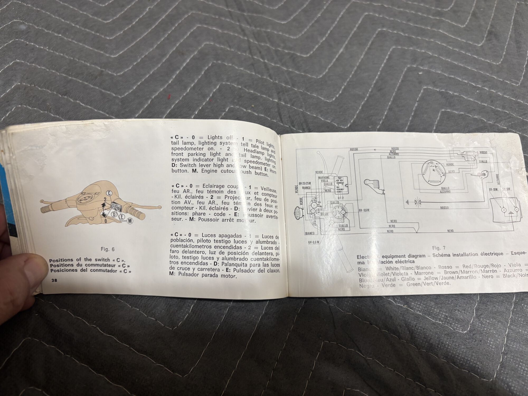

Check the glove box. You might find a wiring diagram in the owners manual.
I'm going to guess that RED= 12V pos. GREEN = kill wire which gets grounded via key switch. White =keyed on 12V pos. BLACK = Ground. See if you can bypass the switch by applying 12v pos to the WHITE wire. If everything comes on then there is an issue with switch or WHITE wire or its connection.
Hec
Owners manual for a P125X wiring diagram.

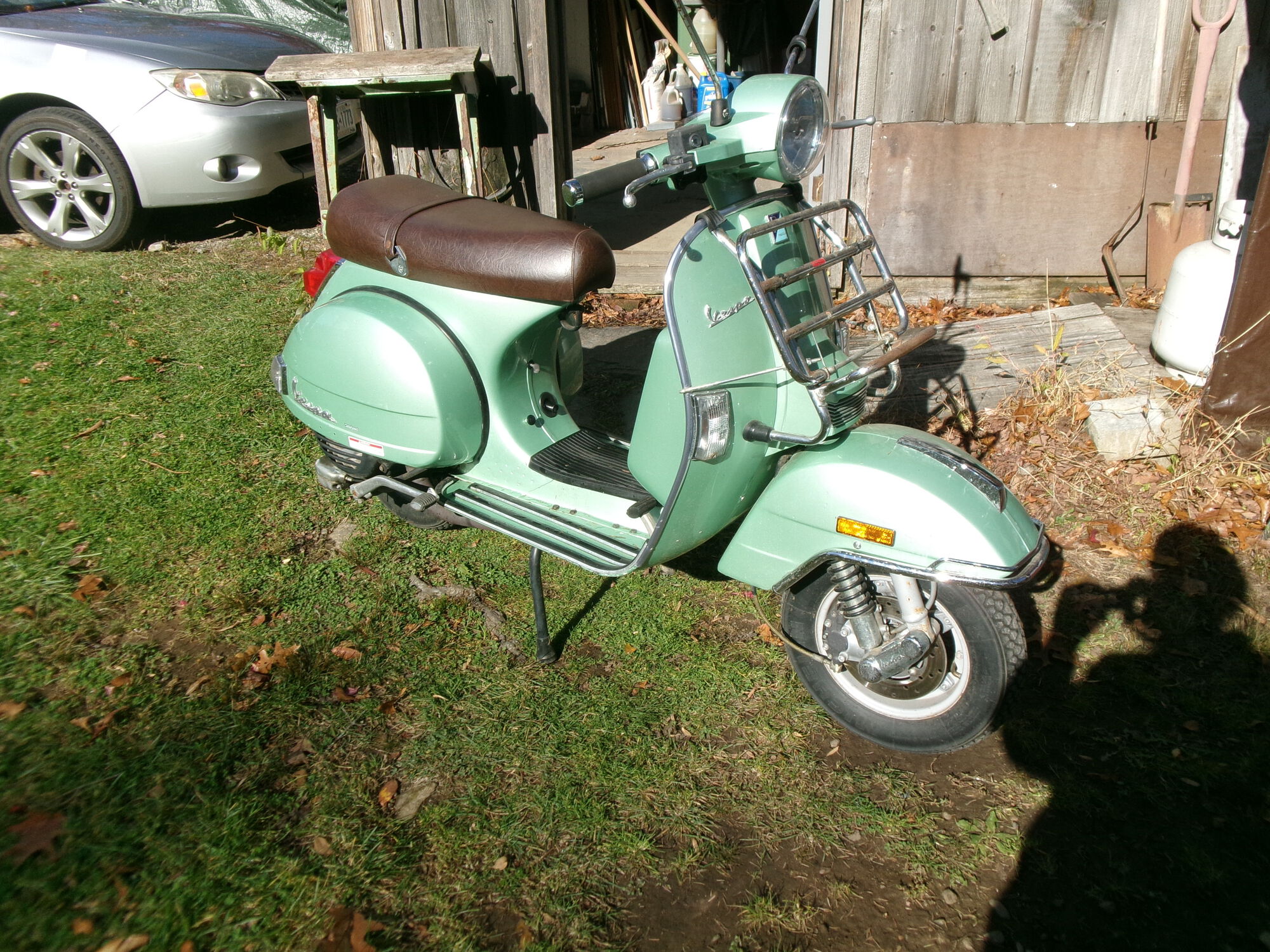

That looks like a Series America. I love the color and uses to have one. I'm still lamenting moving that bike along..
Good job on getting it sorted!
