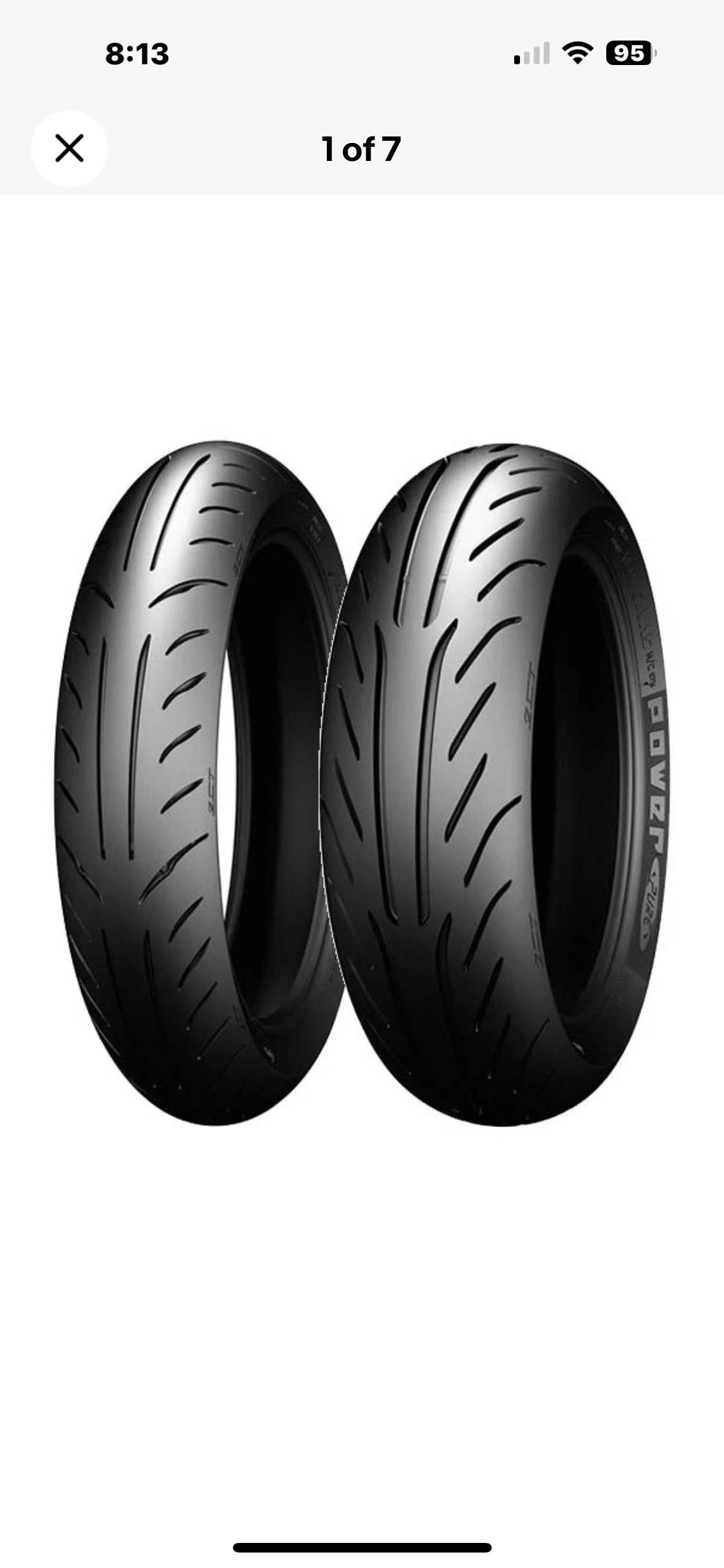

I ordered Michelin power pure from Europe
140
120
No stock in USA
Application is so California
Temp was 82 degrees yesterday, snow in the mountains .
