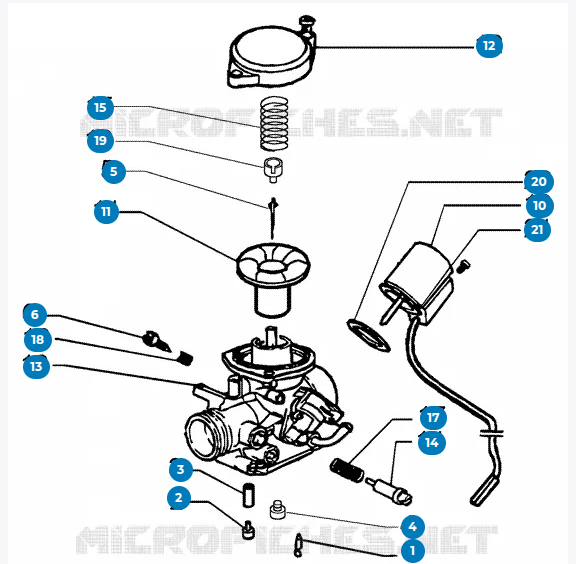

How do you define runs fine? Fires up and idles smooth, rpms increase as you give it gas? If you get nothing past idlle, reset the diaphragm. Use a thin layer of silicone grease around the lip. It can look fine, but still not be completely in place. Number 11 - Welcome to Modern Vespa.

make sure there's still an air cleaner. It sounds like the carb isn't transitioning from the pilot to the main jet. Run a wire through the main jet. If you can't, it's clogged.
