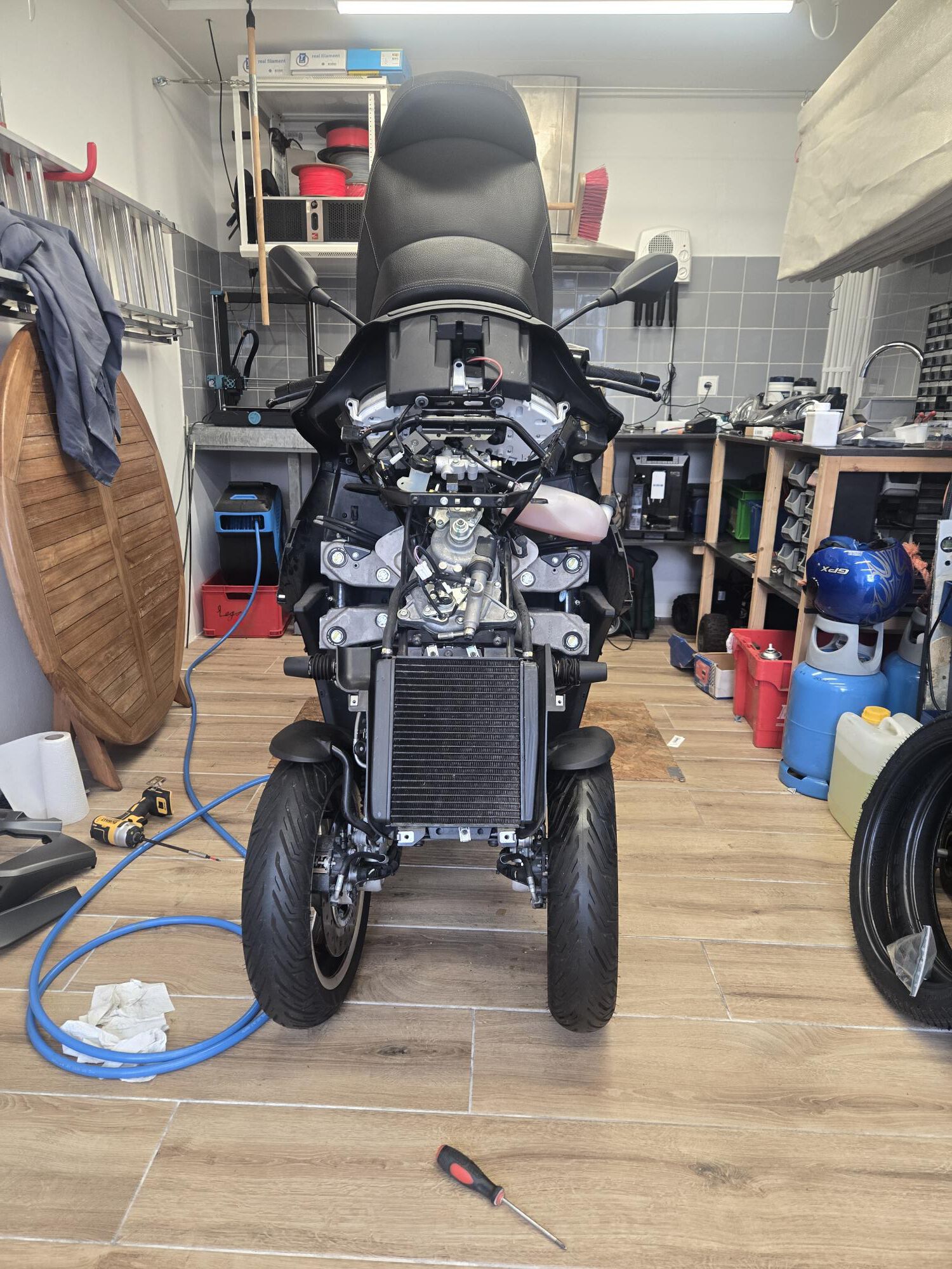

As driving around for many years on my little mopet,
I always change the original spark plugs with Iridium.
expecially on 2T engines, it will last forever,
because it isn't effected by the oil in the fuel.
As my new bike is 10 years old now and into a big overhaul
(new oils, everything fresh grease and new plugs)
I just ordered 2 new Iridums as well.
