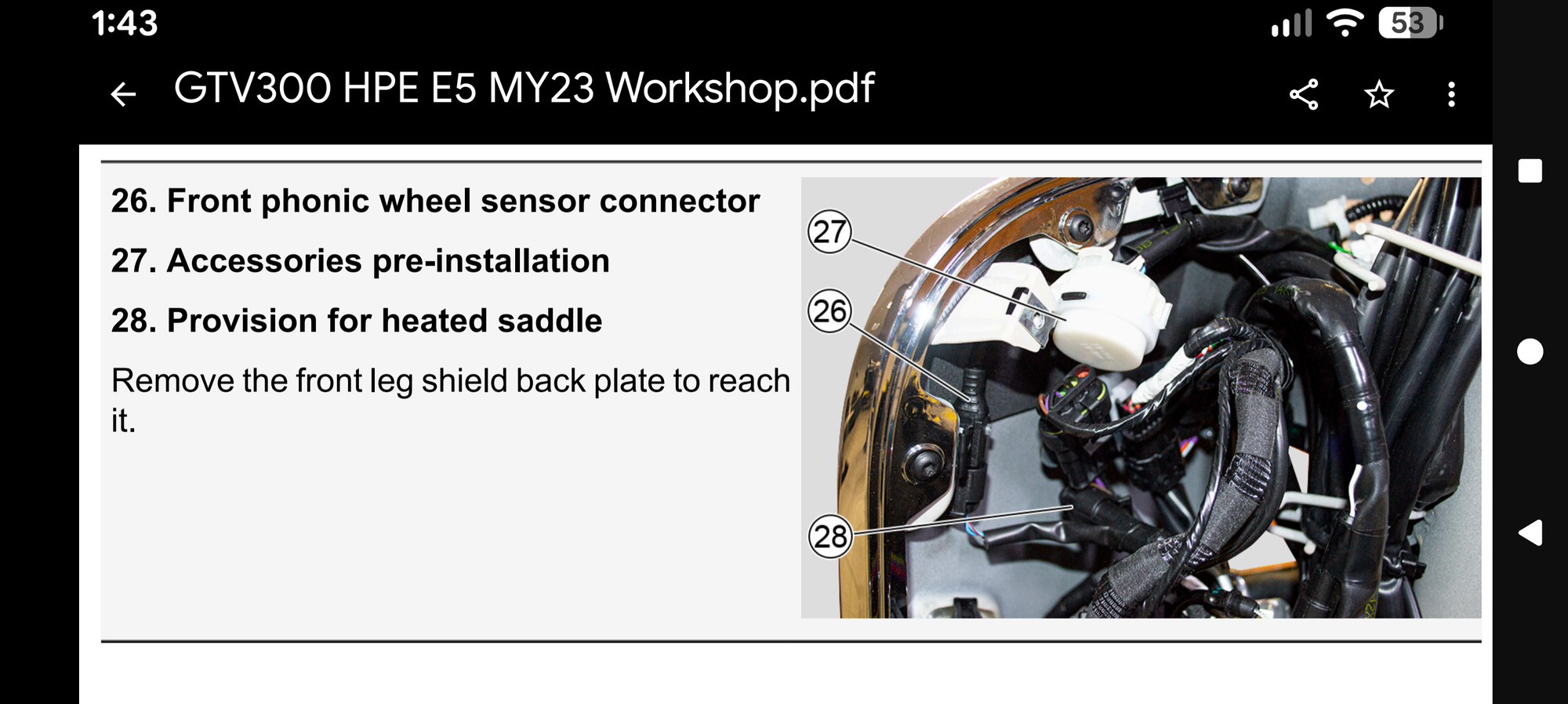

my HPE does have the standard big round white connector behind the left knee cover. but can't see it without partially removing the glovebox. have not opened a 2023 or 310.
workshop manual for gtv keyless 2023 shows it sitting higher but still on the left. See pic

Before you remove the glovebox, take off your horn cover and have a look as detailed here:
Installing Heated Grips on 2018 GTS300 (Post 2437671)
