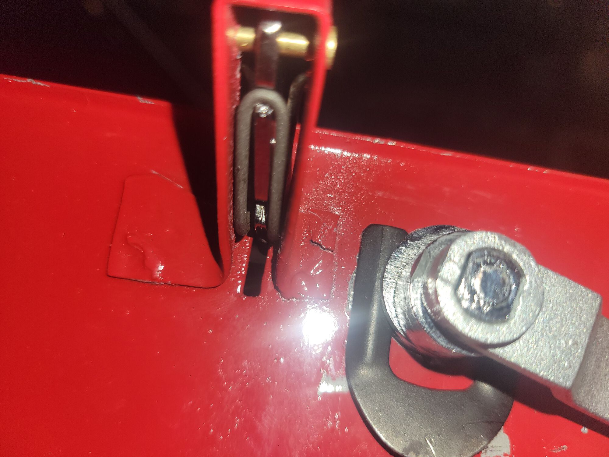

Hi guys just wondering about the side panel lock on a VBB not to sure about how the lever pushes down especially the "V" type spring on how it's fitted thanks in advance.

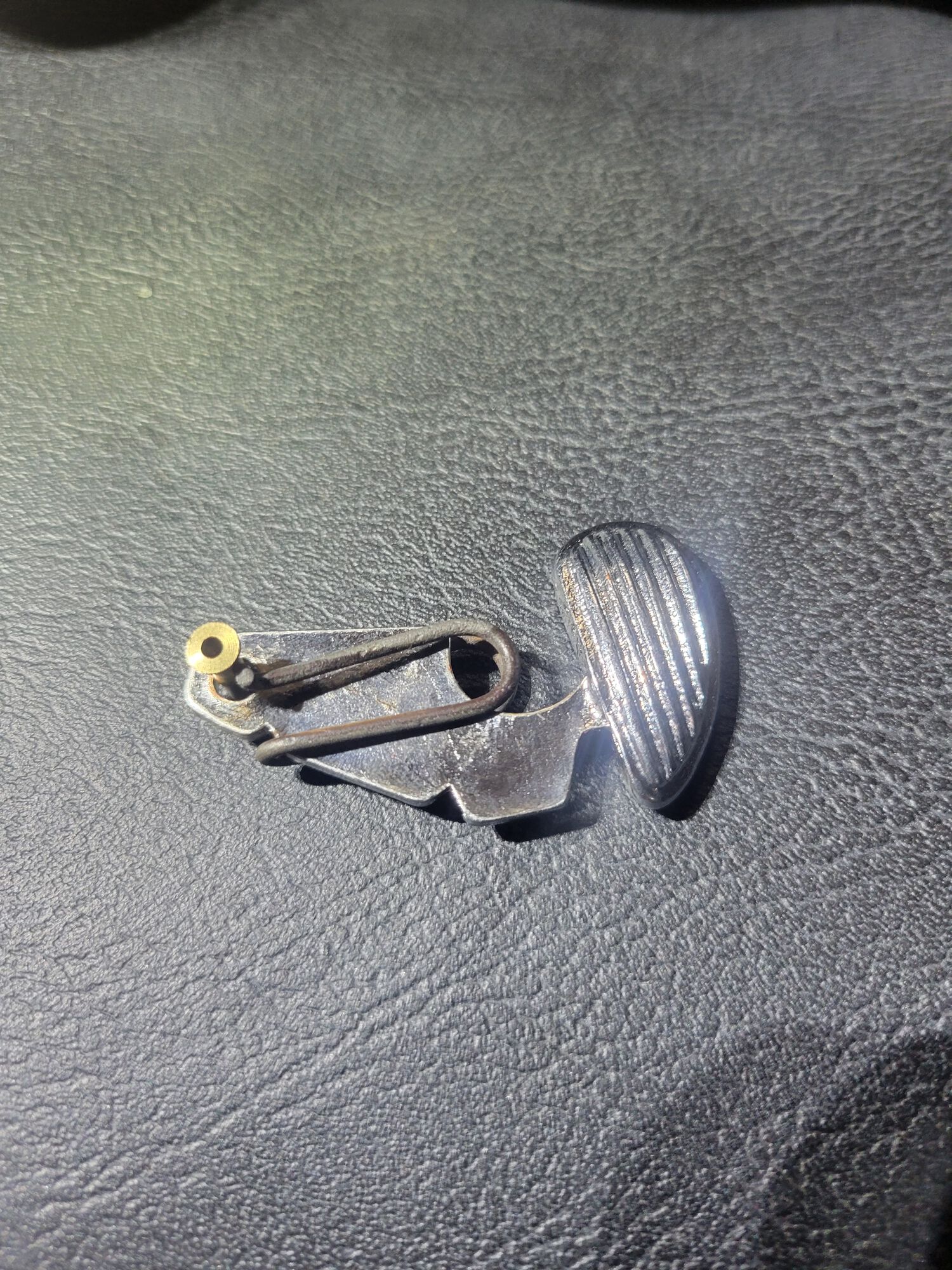

Here's a pic of mine. Hope it helps.

So as I can see the spring sits inside the bracket slash chamber

Yup,spring goes in the chamber, then the lever feeds from the outside.

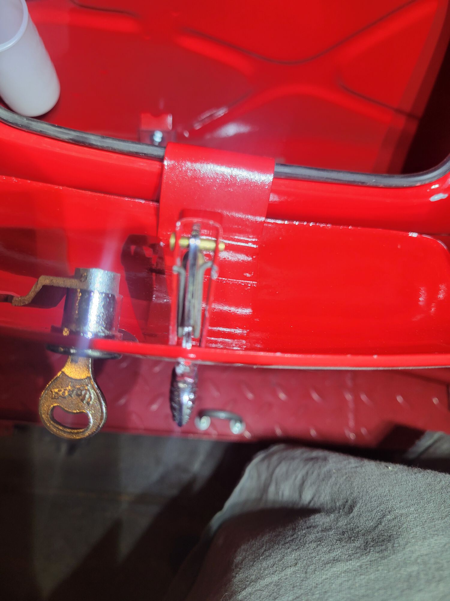

Still having trouble it seems that it doesn't spring when it wants to

No it's not sorted I still can't get it to spring properly

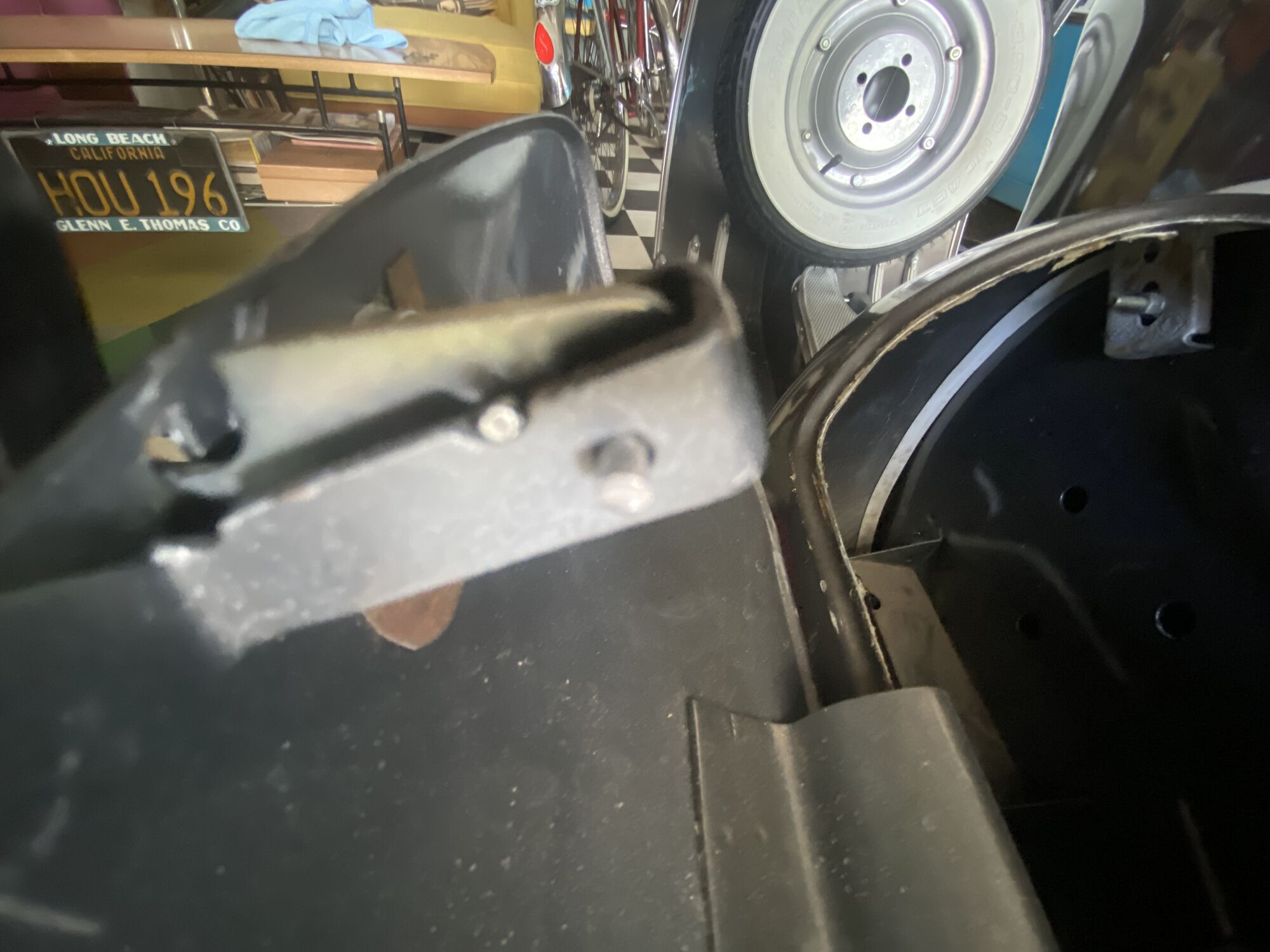

What am I doing wrong here?

Should I just stretch the spring out a bit so it springs better

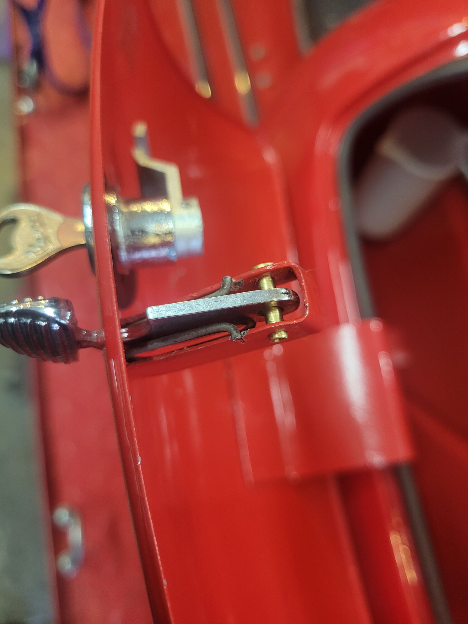

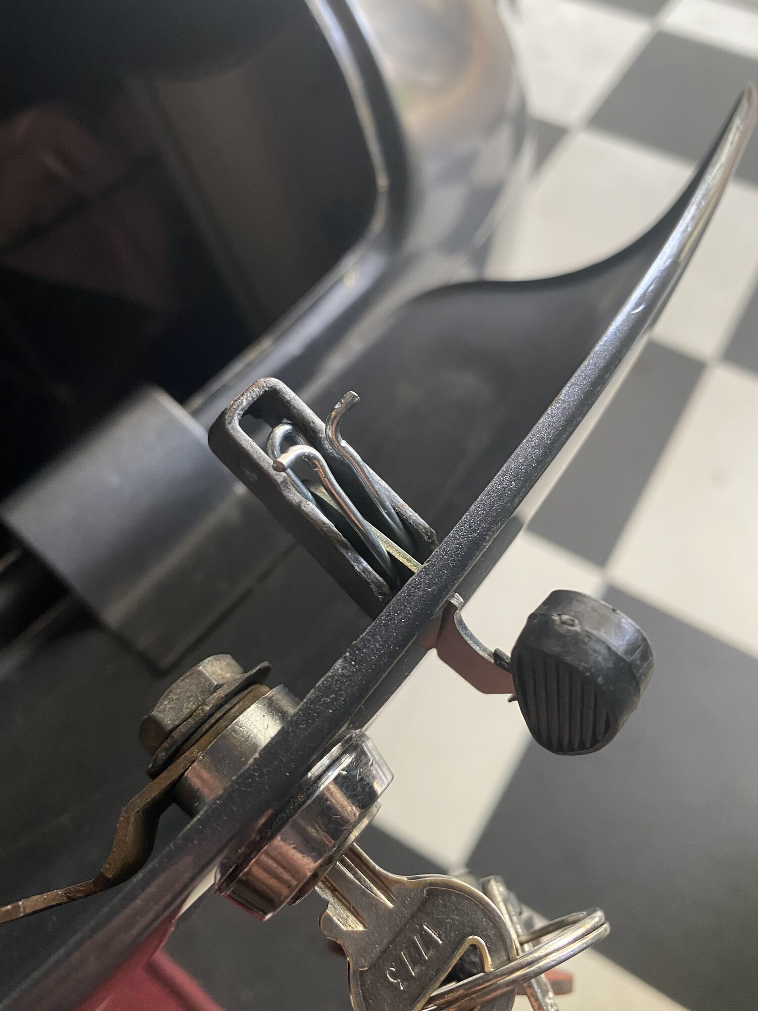

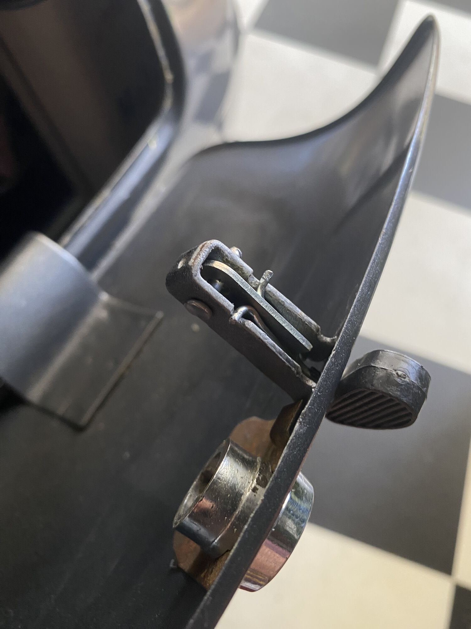

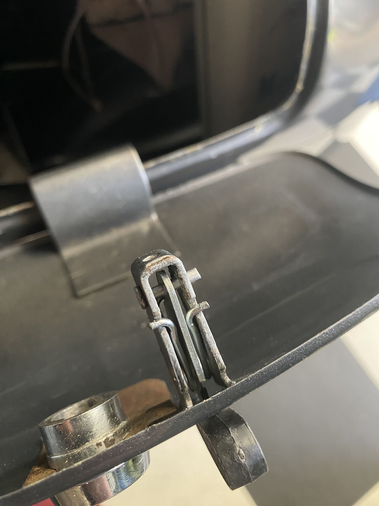

The out pointing ends sit in the little groves on the top side of the " bracket" on the door, with the U bend parallel to the bottom of the "bracket ". Then slide the lever through the door with the U bend below the lever. There should be a notch in the lever that the U bend sits in.
Side view without the "bracket "
View from bottom
View from bottom
View from the top
View from the top

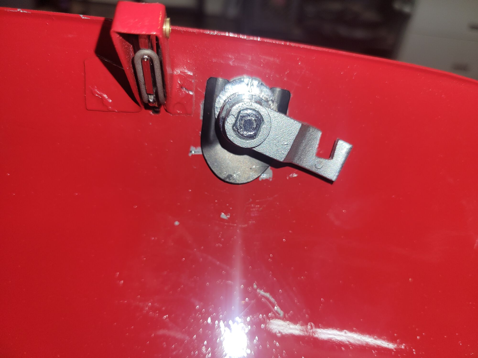

Unfortunately mine has no spring at all the lever is so loose

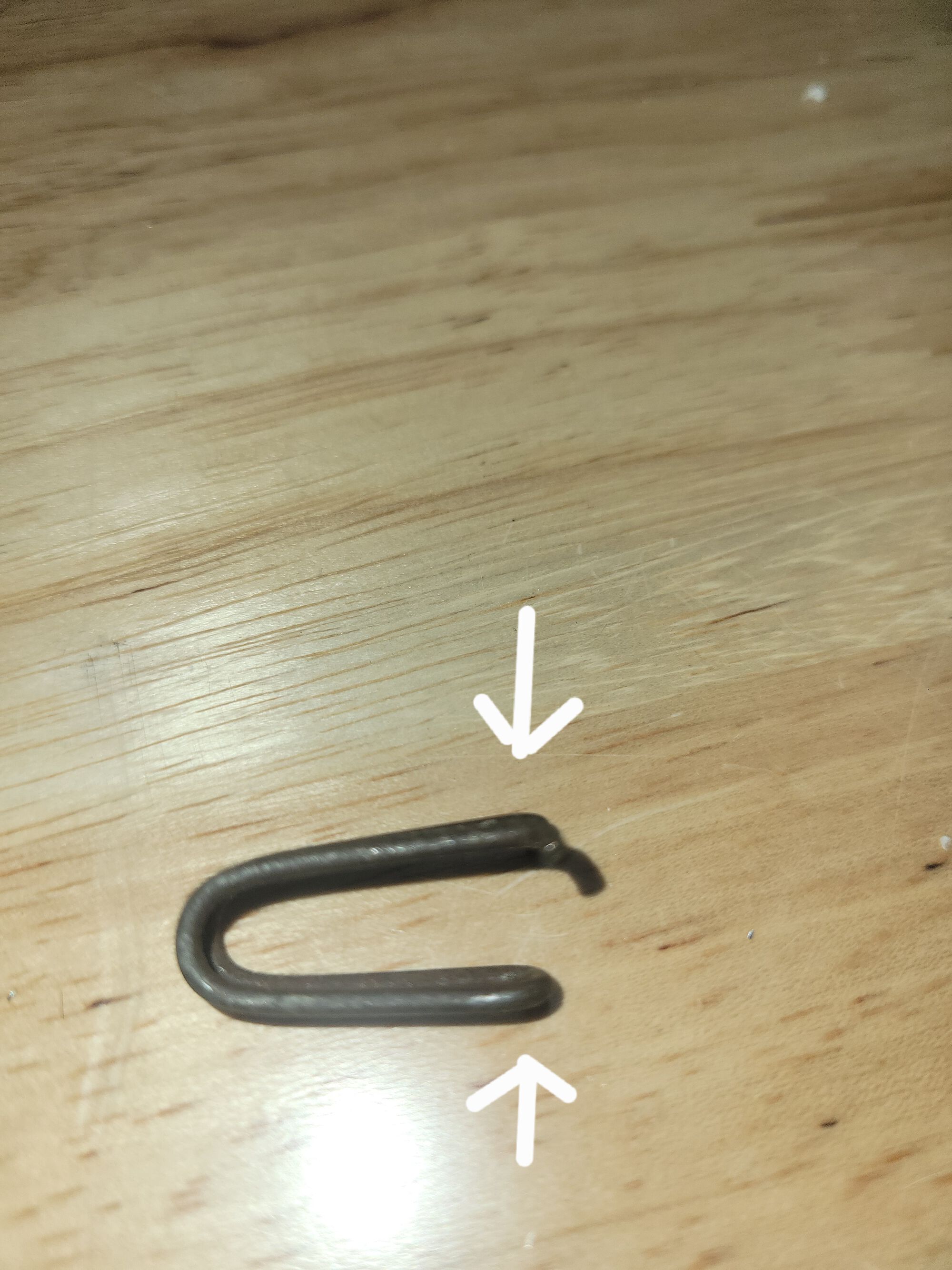

Try this.
Pinch towards each other, a little at a time,and test.
It should tighten it up
Pinch towards each other, a little at a time,and test. It should tighten it up

Jedihunter you need a 6 pack of whatever you drink thank you by pressing the spring up and down it's worked a treat thanks again no my last question do I flattened the Rivett that passes thru the hole or leave it

I would flatten it to the point you feel confident it won't vibrate out.

I would think so so it doesn't fall out
