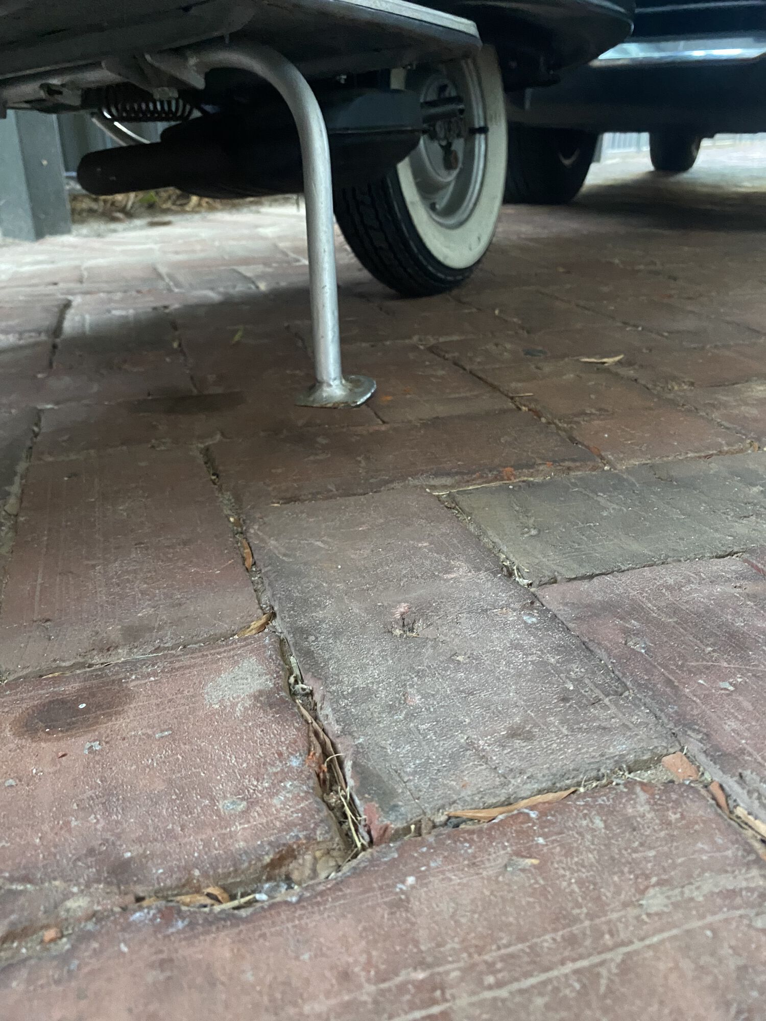

Hello again if it's not one thing it's another my centre stand doesn't sit properly one side is down on the ground the other is about 2" in the air is there an easy fix?

A picture might help. I'm guessing one leg is bent?

Maybe don't install a center stand made for an 8" bike on a 10" wheels conversion?

Location: South Australia
Stand
Centre stand
Centre stand

Frank en stein I'm running 8" wheels

Mannyvbb wrote:
Stand
buy a new stand with new boots. Give your bike the proper maintenance and care it deserves.
+1!👍
You can get a center stand for 10" wheels and always shorten the legs to suit.
https://www.scooterwest.com/center-stand-black-gl-vsb-vsc-vlb-vsd-vse-091047-bk.html

That stand seems to have been modified to park on quicksand or mud or something soft, and it either has been shortened or bent forwards.
New stand indeed, or skilled welder and spare tubes.
