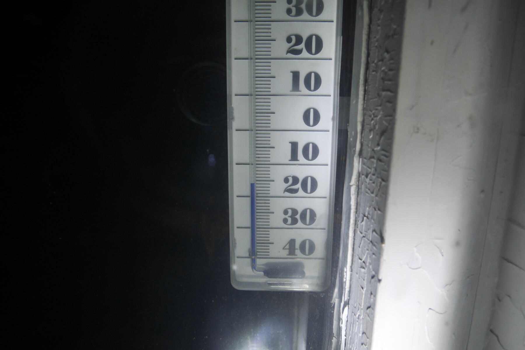

I do not have any boosters, not for scooters or cars. They are meant to start with their starting-battery. Thats the name, even. I could need in cold but here is rare days to have even -35C so no need.

-16°C is about 3°F - brisk for a scooter ride, by anyone's standards!
I've ridden 25-mile round trips a few times in temperatures as low as 17°F (about -8°C), with completely clear and dry road conditions.
At that temperature there are plenty of comfort and equipment concerns, or at least things to keep an eye out for, but the battery wasn't one of them!
