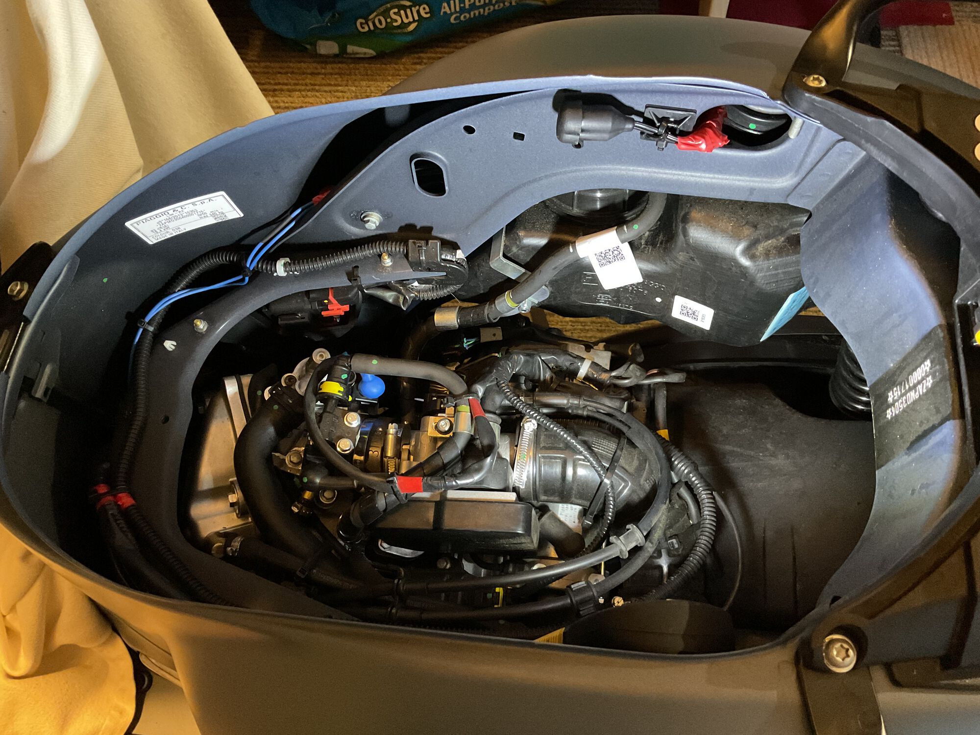

Just last Saturday I extended my battery tender lead from where the bike shop had trapped it with the black plastic battery cover.
I took the standard TM connector and soldered two lengths of 8 amp blue cable complete with circular battery connectors. I ran the cables out of the rear of the battery compartment up and around to the right hand side of the chassis. In this position it doesn't get in the way of the pet carrier, its away from heat and water.
The red tape on the photo where the wire passes through the frame is just securing a cable protector to avoid chafing on any sharp edges.
