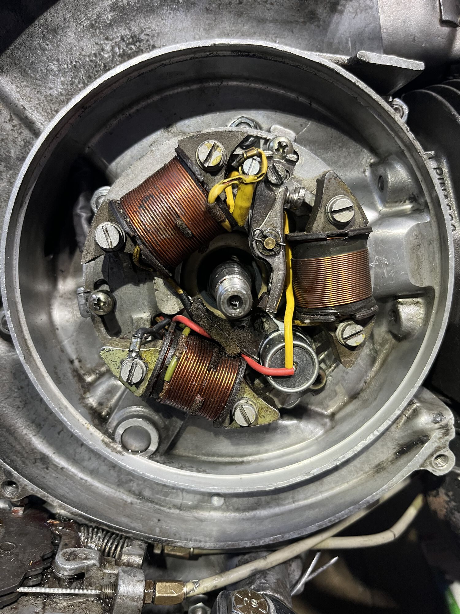

Hi im new to this scooter (65 allstste)
Need some help Im having some noise in my flywheel , any thougths are higjly appreciated. Attached here are videos

I couldn't see the videos ( came up private).
I don't see any witness marks on the stator or case.
How about pics of the flywheel, and the inside of the flywheel shroud. Just to rule them out.

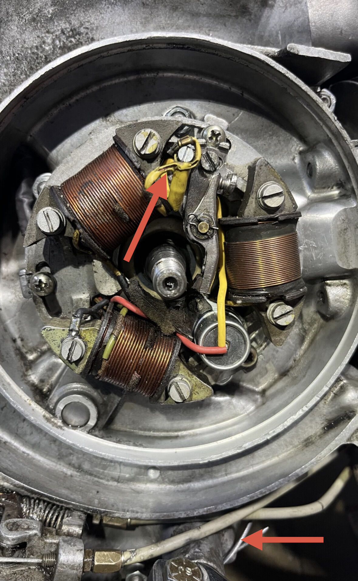

https://youtube.com/shorts/JGIAoslT0jM?si=4c4I47hCwp-ew1TF
https://youtube.com/shorts/Nl7KDDNPmfI?si=b-Si5QzSX3jTIx7o

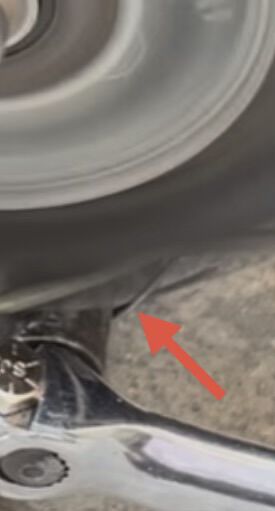

It looks like the flywheel fan blades are rubbing on a cable or wire next to the kick starter. The wire or cable moves in sync with the sound in the video.
That yellow wire on your stator also needs attention! The insulation is broke open.

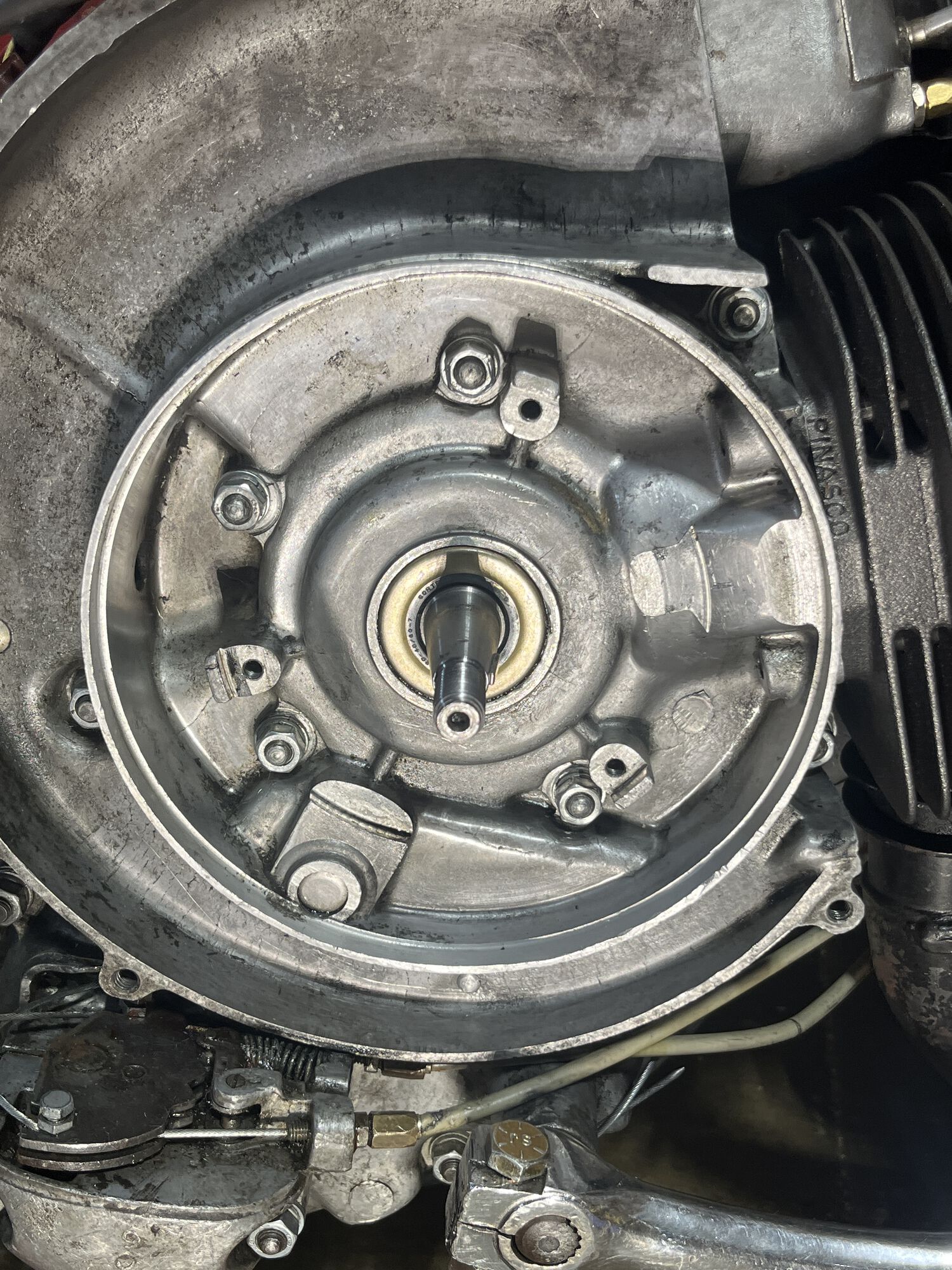

I have had several earlier flywheels develop loose magnets. It's annoying but relatively harmless. You could stake around the pockets or even wick superglue around them. The magnets don't have to be very loose to rattle. It's a battle between magnetism and centrifugal force.
Just a suggestion.
Show the inside of the flywheel. Full frame, not just a close up please.

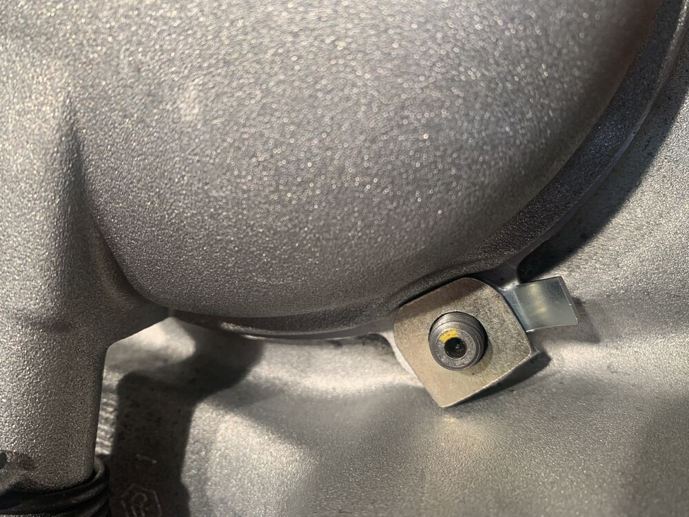

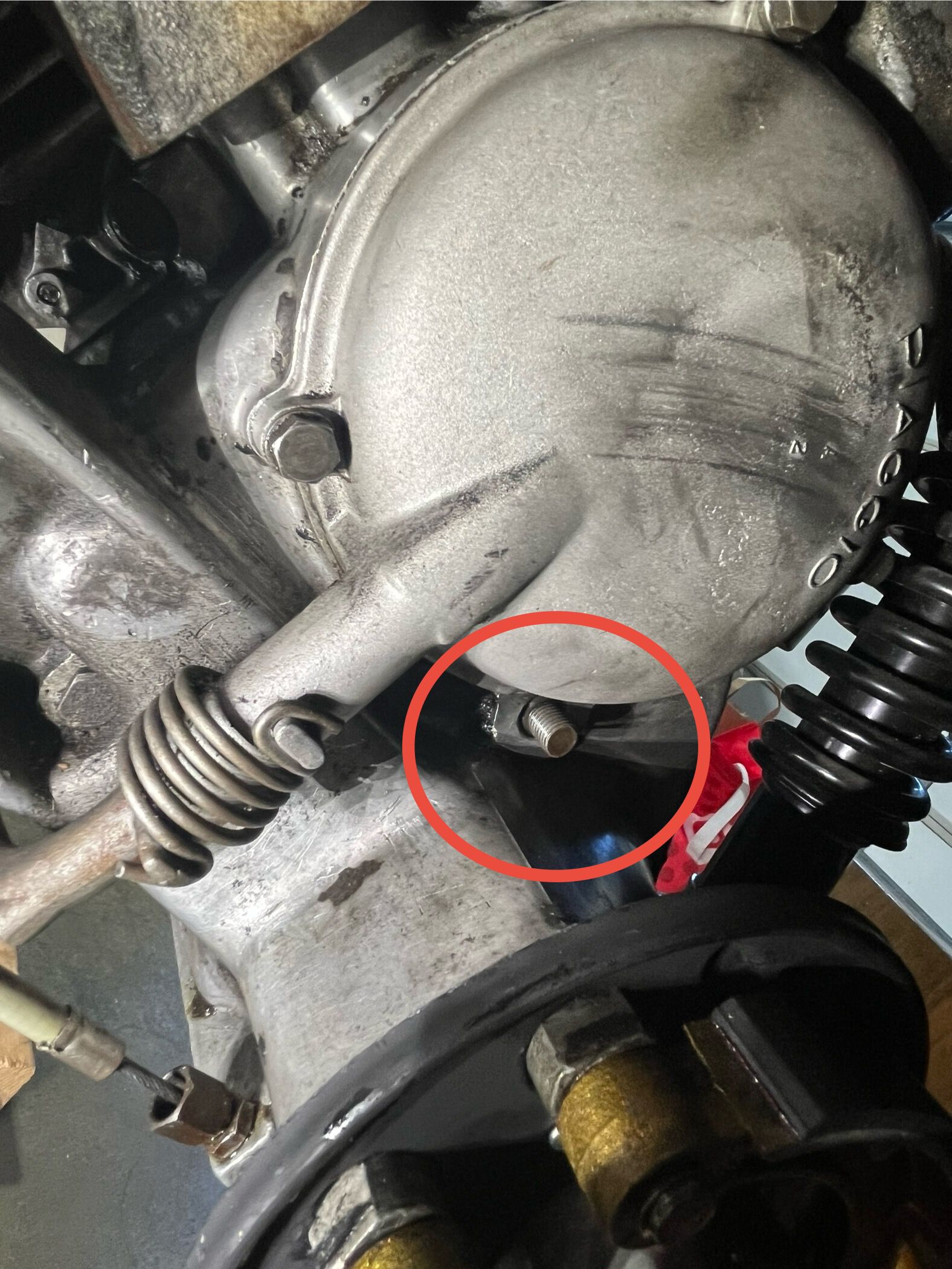

Still having some noise ,
Just recently i noticed an oil leak coming out from clutch cover. One piece of nut is missing . Can you tell me what type of nut amd washer should i buy? And the torque specs as well… really appreciate it

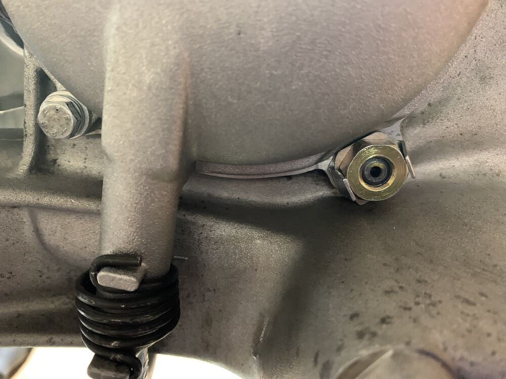

It looks like this. There are two variants but this is the preferred one.
Hec
