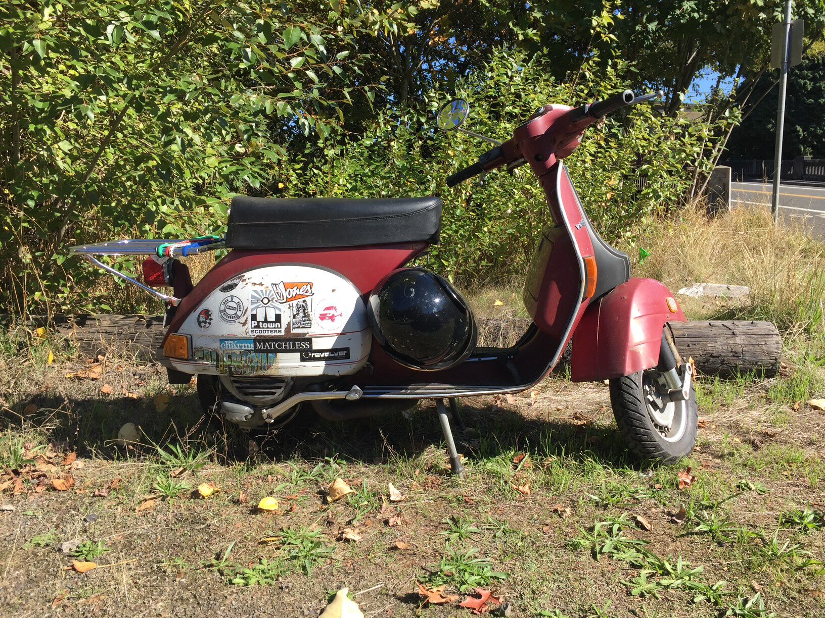

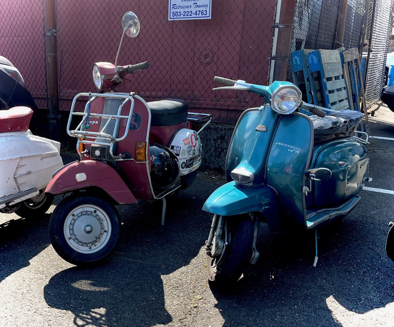

Here are a couple pics I found on my phone from earlier this year
The pic with the Lambrettas was a scooterclub meetup. I'm not a member but have many friends in that club. They were getting "refreshments" at a nearby tavern and I figured I'd join them. The white Lammy is owned by P-Town Patrick, in case anyone recognized it.
The white cowls are not original. They are probably the 4th or 5th set I've had on there. When I lived in San Diego in the 80's I parked on the street. They kept getting ripped off.
I recognize both of those lammies. If you have troubles dialing in the Malossi via this forum, i'm confident someone in the portland scooter community could help you out in person.

Yeah, Whodatschrome!
The scene is pretty rich and friendly for sure. Everyone has been cool.
I'm trying to save my big favors for a real blunder.
Maybe see you out there.

Nice P; you can tell it's been around! Too bad about the cowls though. Funny how the burgundy and navy blue paint jobs tend to lose their sheen on these bikes. Good thing is, they're usually easy to bring back to life with some acetone or abrasive polish.
