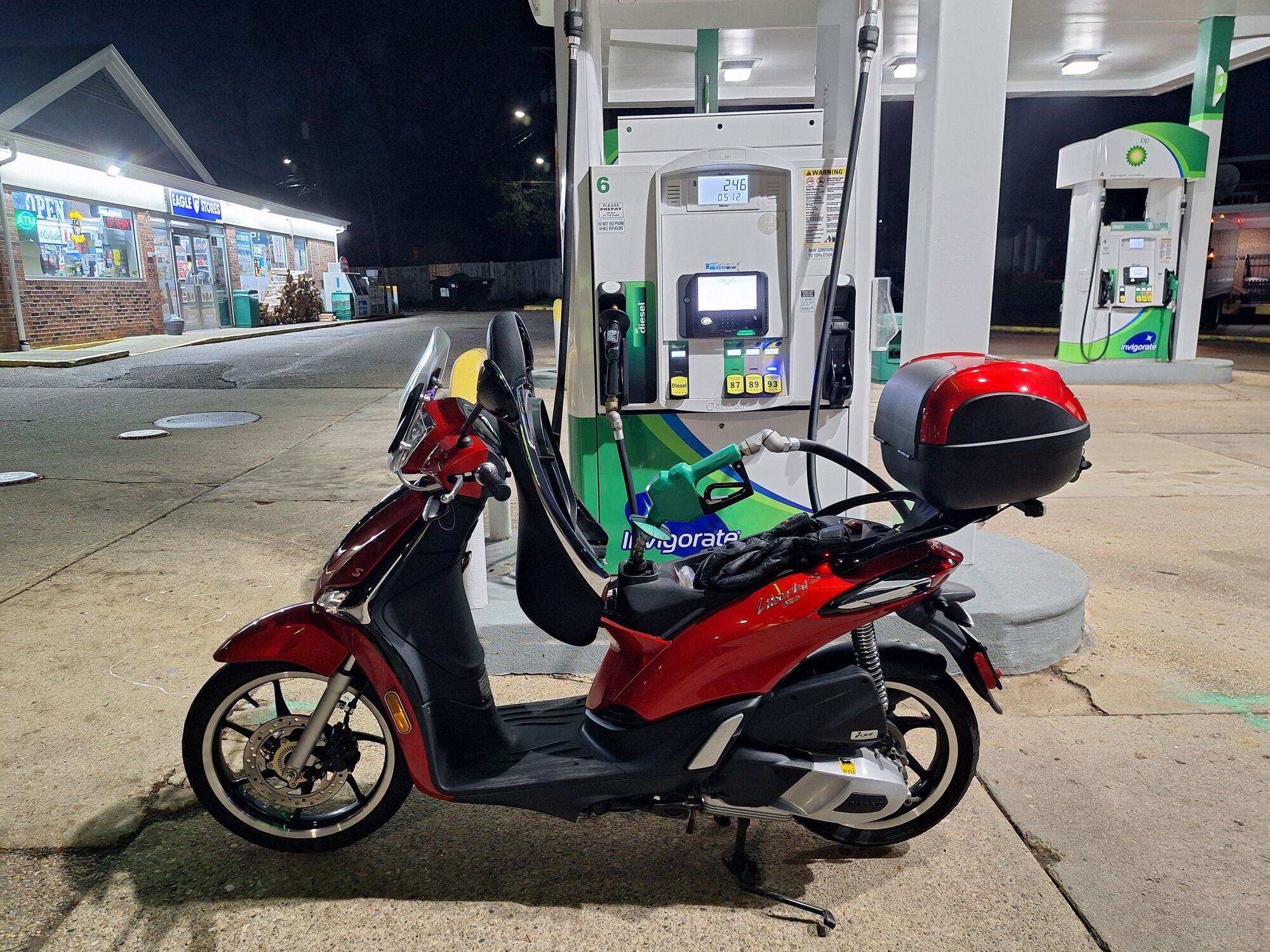

Finally, a station fill-up w/o drama!
Down a couple of bars after ride out for coffee, Y.S., stopped filling at .5 gal. - fuel gauge read full and no over-flow!
Finally, a station fill-up w/o drama! Down a couple of bars after ride out for coffee, Y.S., stopped filling at .5 gal. - fuel gauge read full and no over-flow!
this is pre-"excursion" pricing :-)

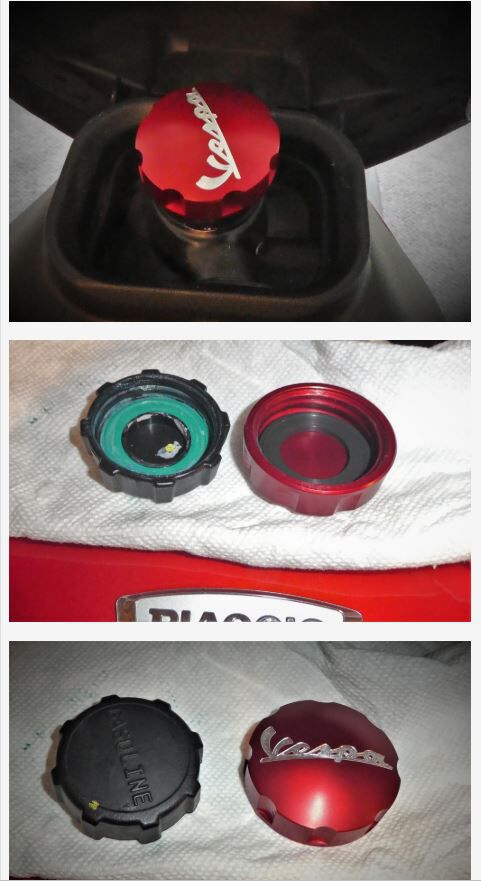

I've heard this advice before. Honestly - I tried a pull on that green thing - but....the whole darn tank, cap and threads are so sketchy, I decided, with my luck, I would snap the neck and require a new tank.
90% of the time, I fill with a gas can at home. "Pour, look, pour, look w/flashlight, pour"...turn key on - see how I'm dooon. Stop if all bars.
Frankly - fills and rethreading the gas cap* are my only two gripes about this scooter. I can live with it - and have, quite happily for 9 years!
* yeah, tossed the plastic OEM cap soonest! tank and cap hated each other - or me. We never worked it out. Bought the nice billet Vespa cap. Some better....not perfect. Cheap plastic tank, neck and cap. Seen better threads on my Kroger milk jug!

Finally got a billet cap from AliExpress. Big improvement. It appears that the OEM cap and tank are molded from the same material. Makes them want to stick instead of slip easily.
Green insert does not help with filling tank. But it does have the "fill to here" tab. I understand overfilling is to be avoided.
OFG
That was my thought, too!

Billet cap threads vs plastic tank threads: Billet wins every time.

I replaced my gas cap long ago with a billet Vespa one too! So necessary! The plastic cap was darn near impossible to remove most of the time. The billet cap is no problem.

Seven years ago - eBay, @ $12
(I've seen the plastic OEM cap for sale by dealers for $34!)
