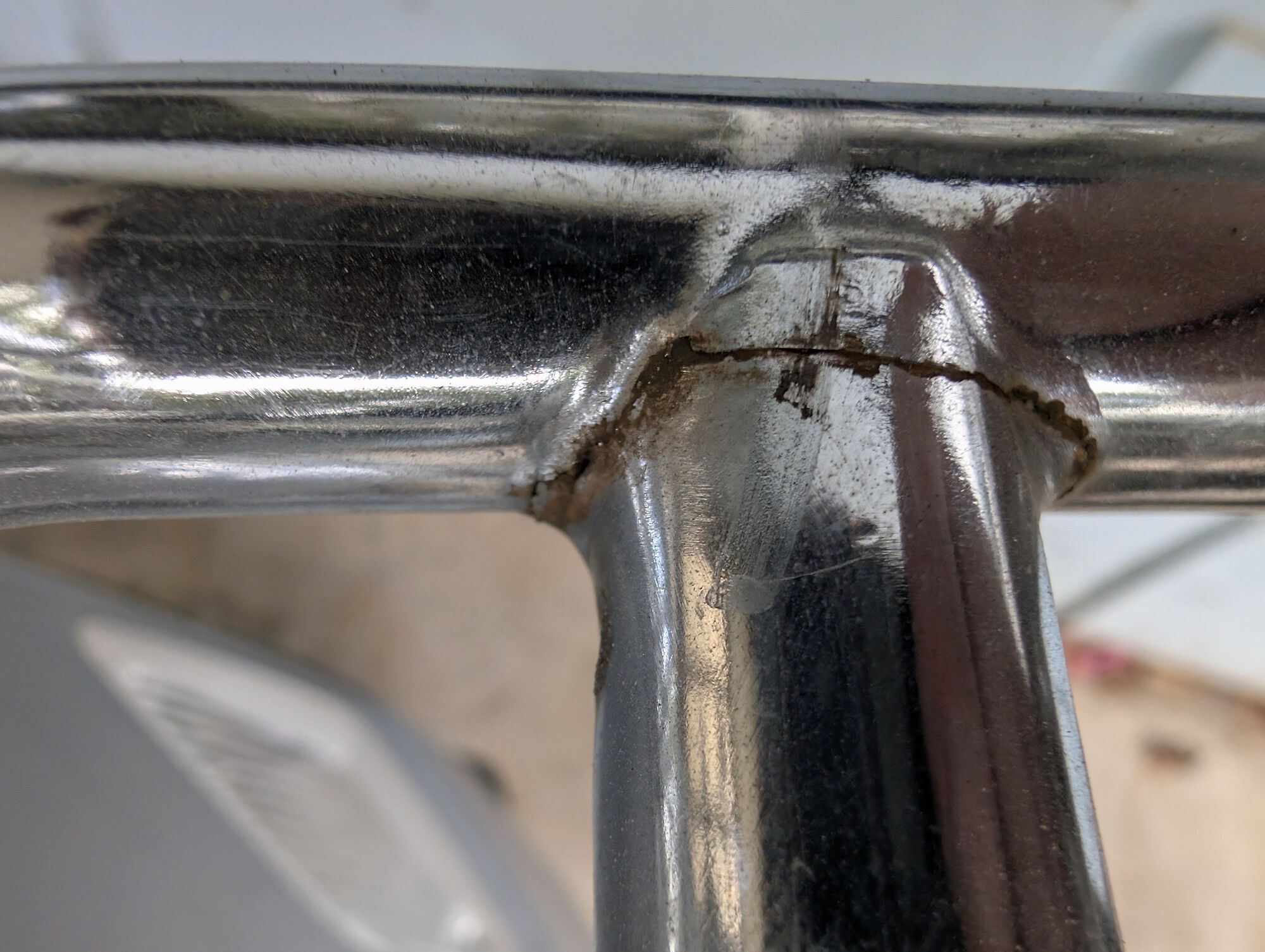

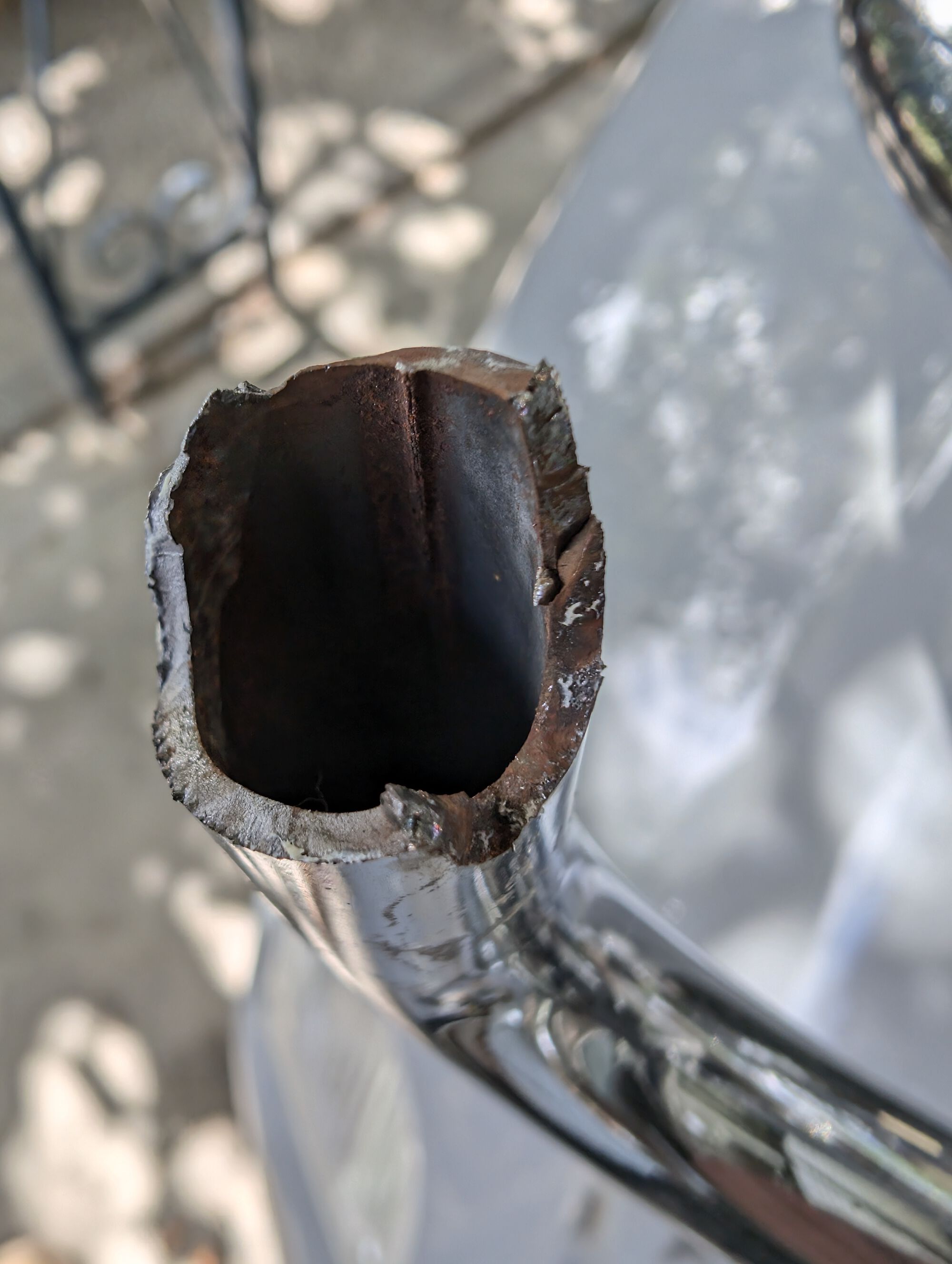

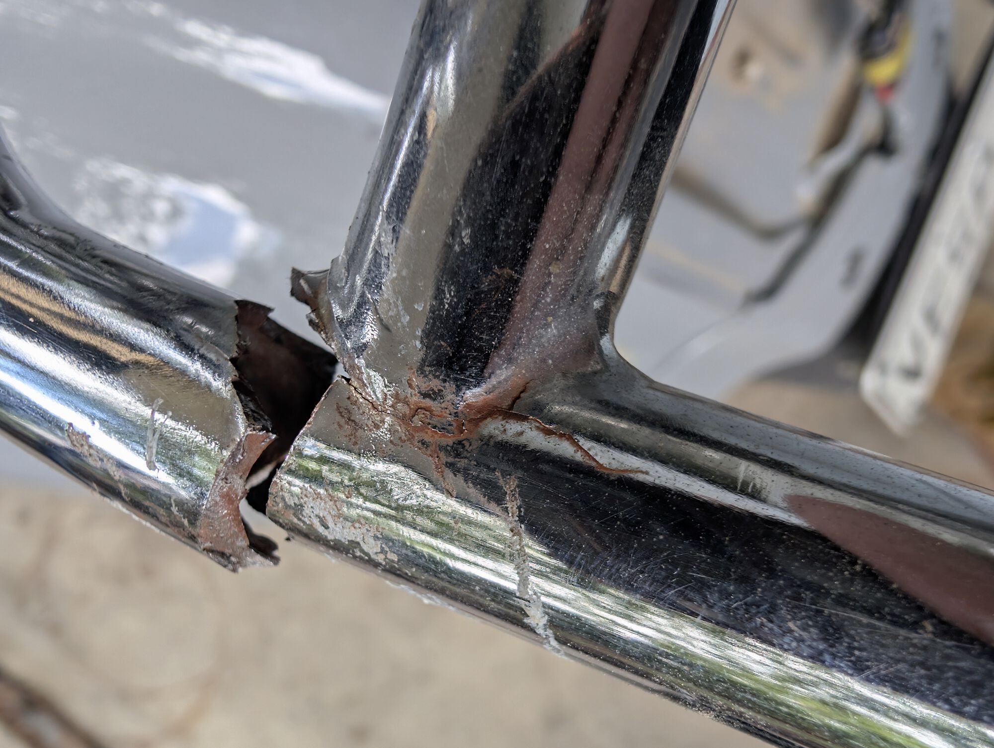

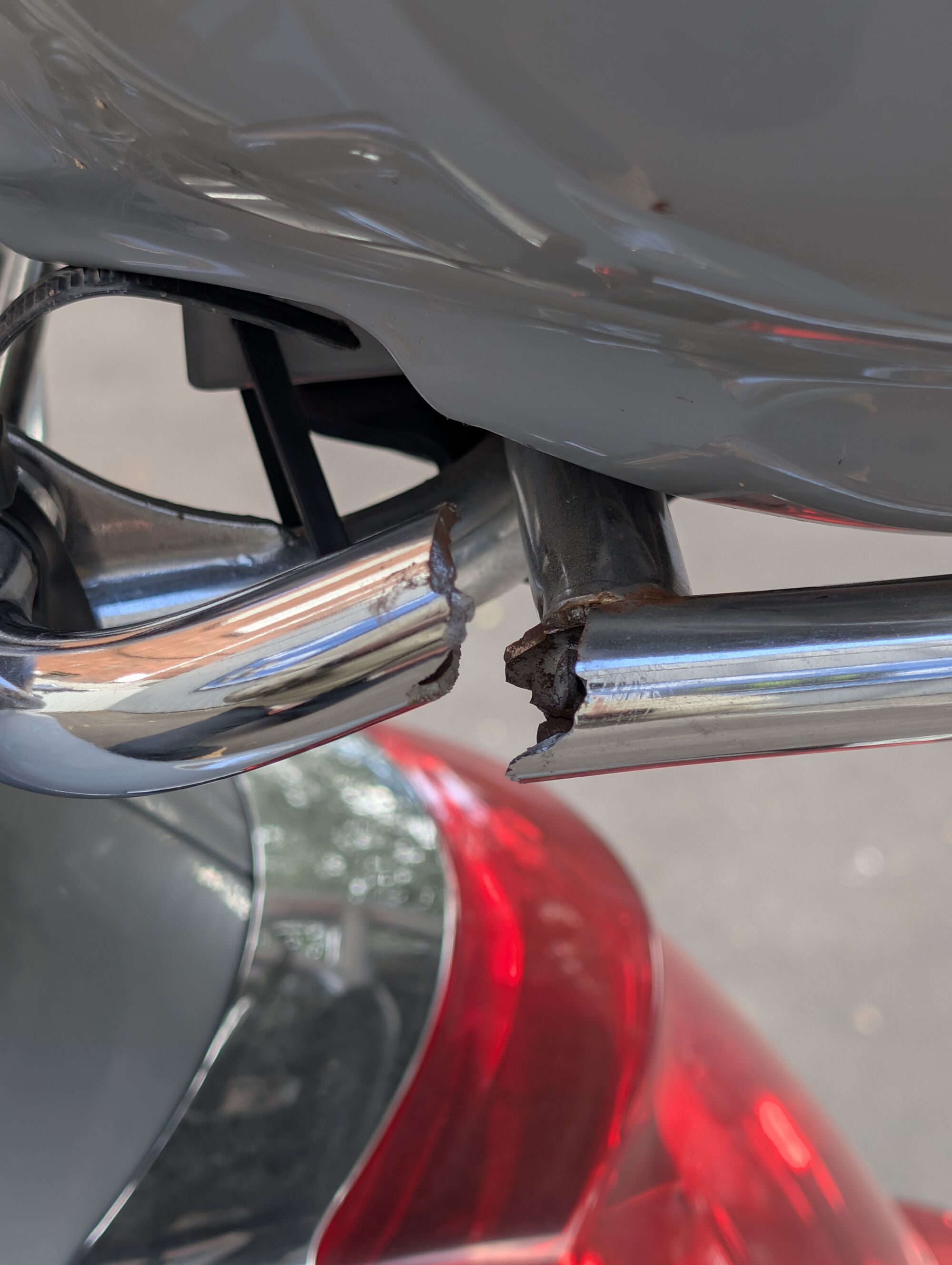

I broke mine. And no i was not carrying a heavy load, i avoid doing that.
The spring broke years ago and now the rack itself around the welds.
I don't need folding, the reason i had it was iirc the salesman said it was stronger?
other end of that bar

Not sure I buy the "stronger" argument, though that can have several interpretations. Maybe the folding version can accommodate more weight (seems doubtful) but what you have here seems to have broken after millions of microflexes occurred as the folding part wobbled over the fixed part. That made the metal brittle, as suggested by the clean fracture pattern.
I have a folding version too, with a permanently installed top box. The folding feature really isn't useful. I wouldn't do it again.

Chrome is porous

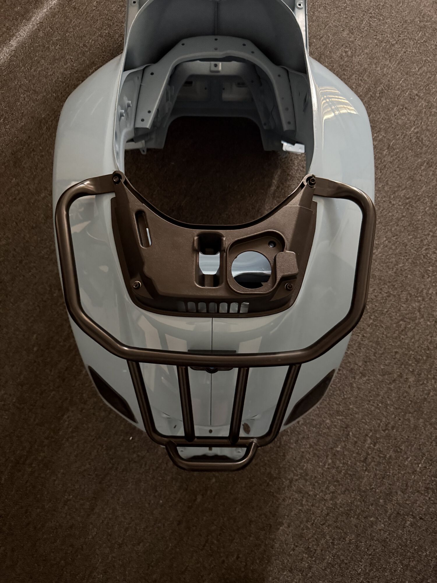

Have just bought OEM flat rack for AU$131
Decided against non-OEM after seeing pics of the holes on other brands not lining up properly. plus I can get the oem and a much better price.

heh - you may well find that the OEM rack has the same problem with holes lining up - at least the ones I've fitted always had to be wrestled into place. But the last one was nearly 10 years ago, so maybe, just maybe, they've improved. The chrome though is excellent on the OEM - best of the bunch.

Yup ...
One of the two tangs needed bending - just was well it's low grade steel so i could do it without a blow torch.
Could only get 3 holes to line up at a time so i enlarged one.
Already had a bit of rust on the welds for the tangs.
The bolt didn't want to go through - seemed the chroming had clogged some of the thread. had to work it through from each side, one day I'll buy some taps.
But it did have a QC sticker 🤦‍♂️
Bonus vs folding: the box is slightly further forward which should result in less stress on the rack.
That's pretty much how they show up at dealers now. Since Piaggio moved production of this part to Vietnam, all of them come in with rust stains on the bubblewrap where the holes are for the bolts.

and shitty welds
