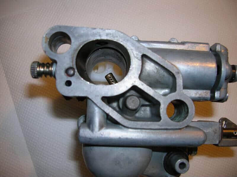

Just wondering, based on the dell'orto carb diagram, there's two pilot jet outlet hole
I am pretty sure one of them is the hole that controlled by pilot screw,
Anyone knows the other one located?

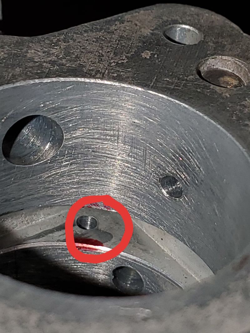

It's hiding, here, on top of the slide:
(Photo credit: BGMStella, in a post from 2020)
Basically it's cracked open at like 1/16th throttle, depending on how deep the notch in the corner of the slide is.
I've seen it called the "pilot bypass orifice". Kind of gross sounding.
