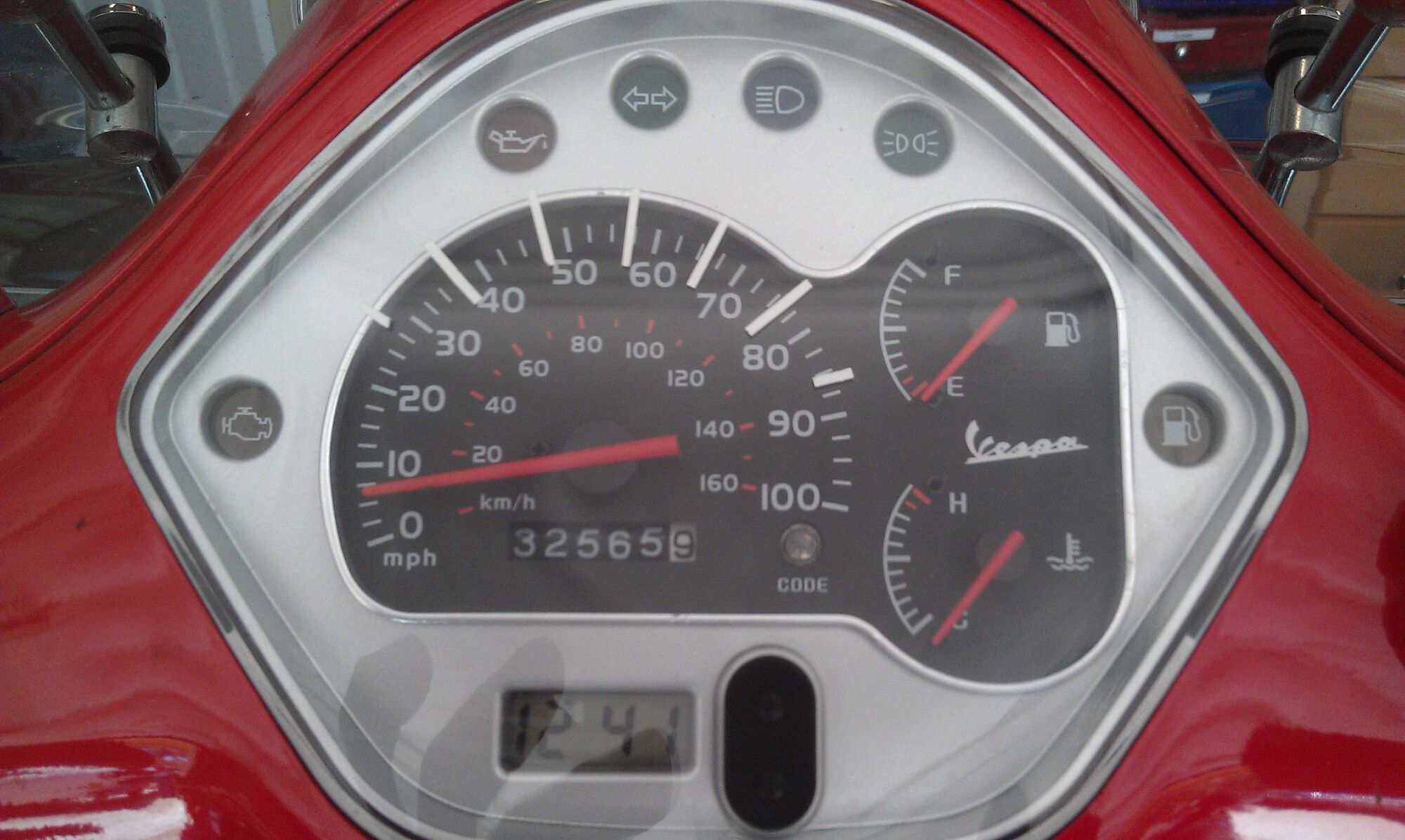

Just add some markings - I used white label-printing tape - to mark the important speeds. Note my speedo is an mph one.
20, 30, 40, 50, 60, 70, 80 mph marks
