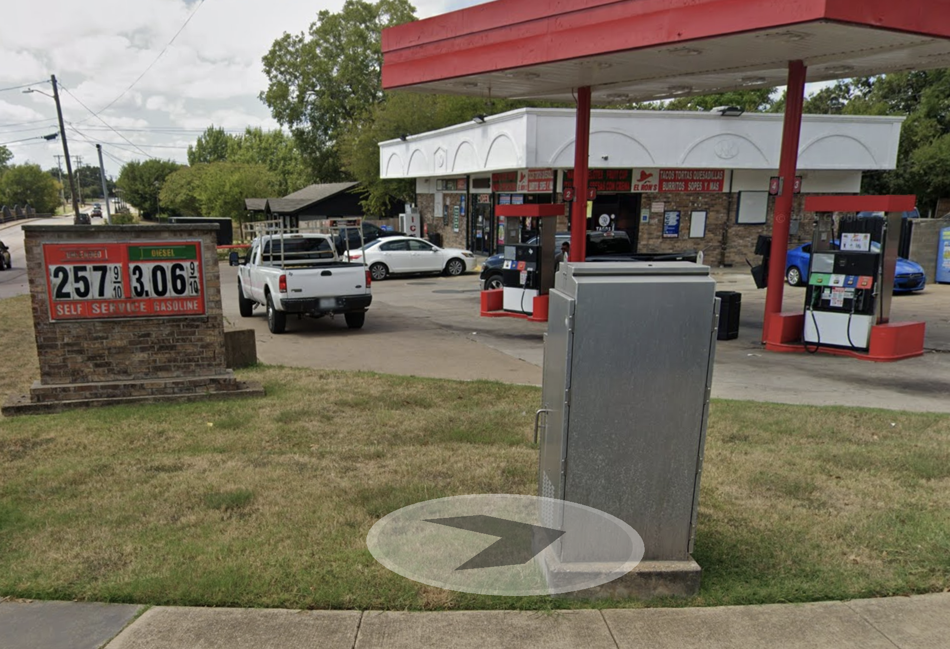

On the positive side of things, last night when I got gas for the truck the price was $0.10 less/gallon than it had been at the beginning of the week.
Still gonna get the BV on the road to commute on it, though.

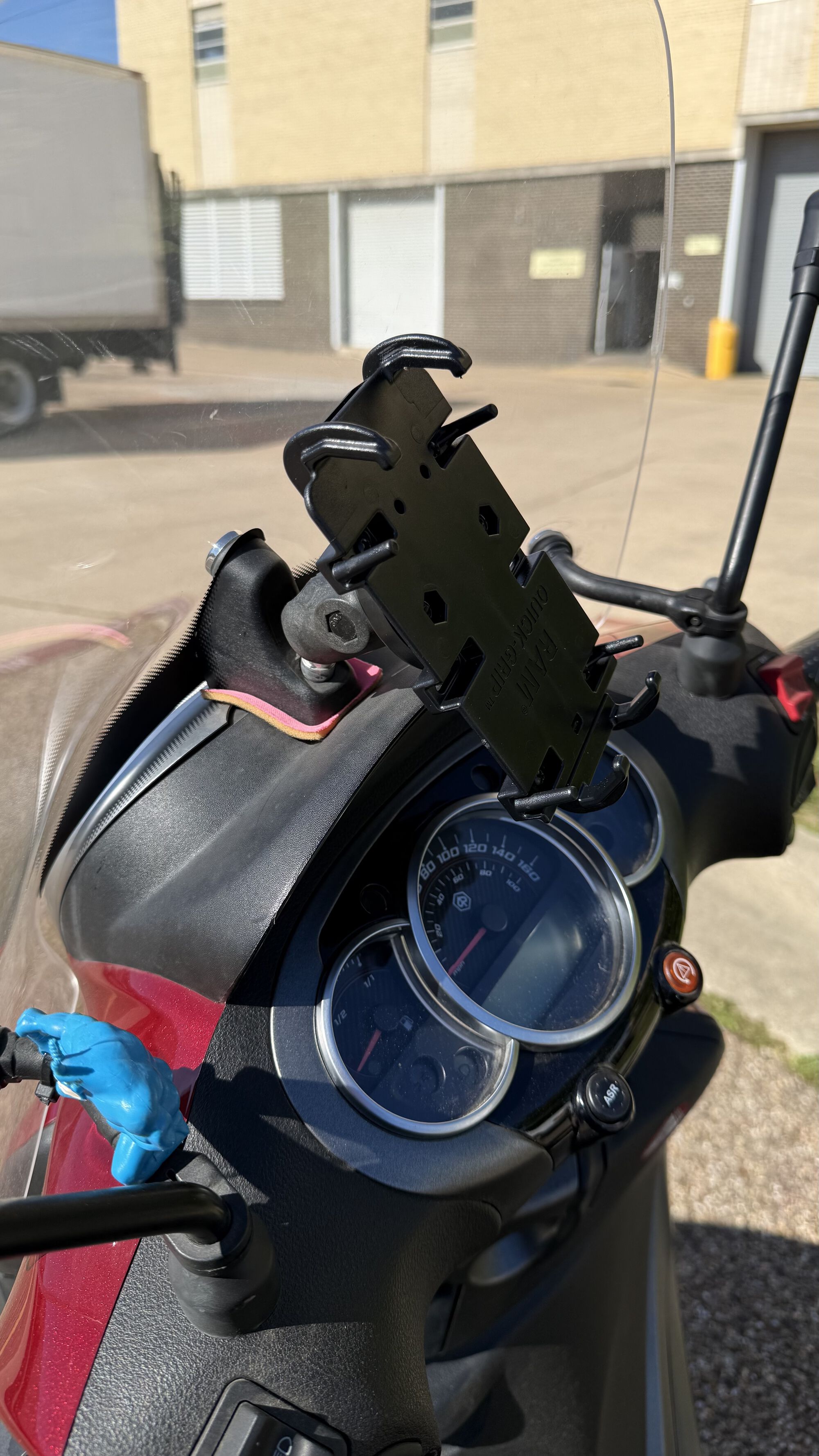

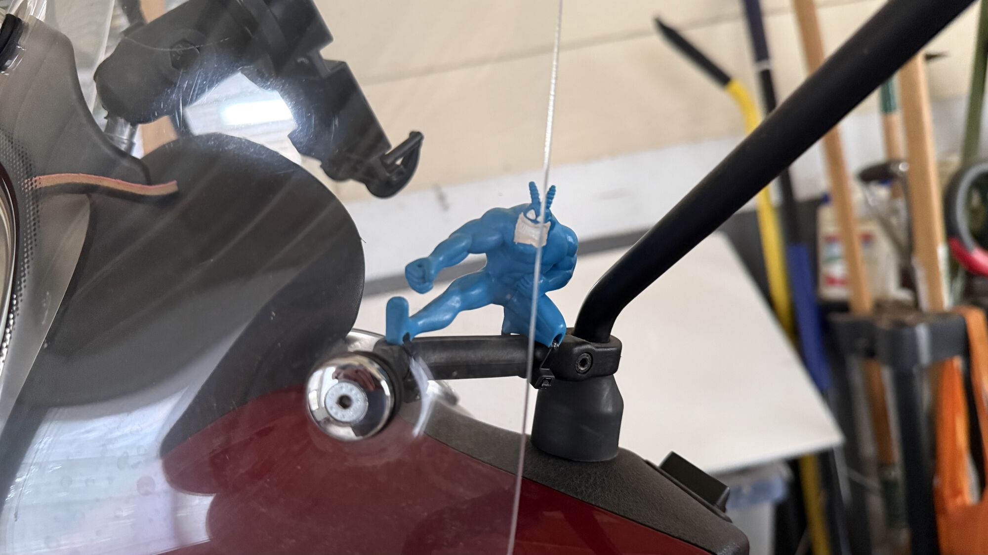

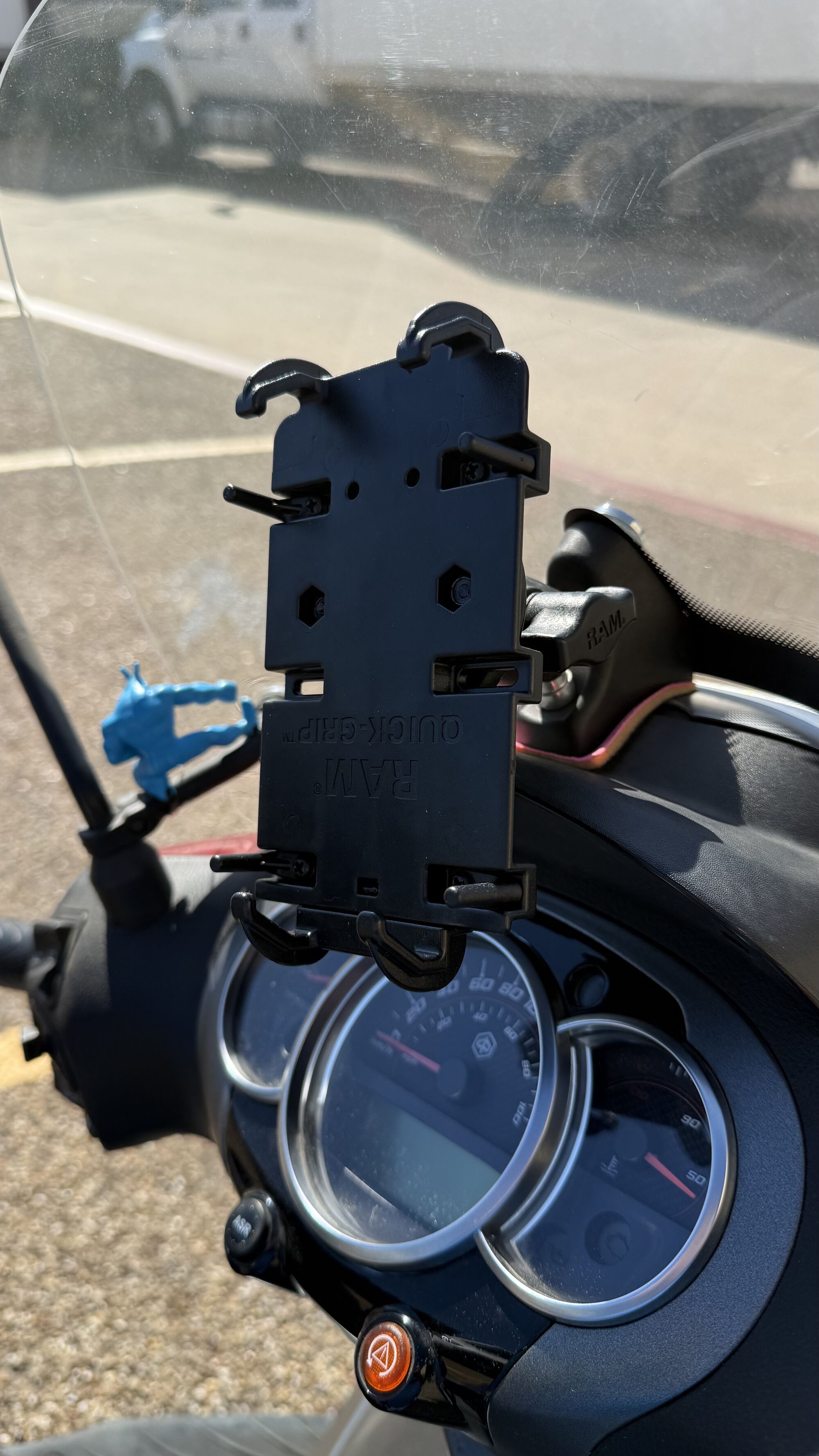

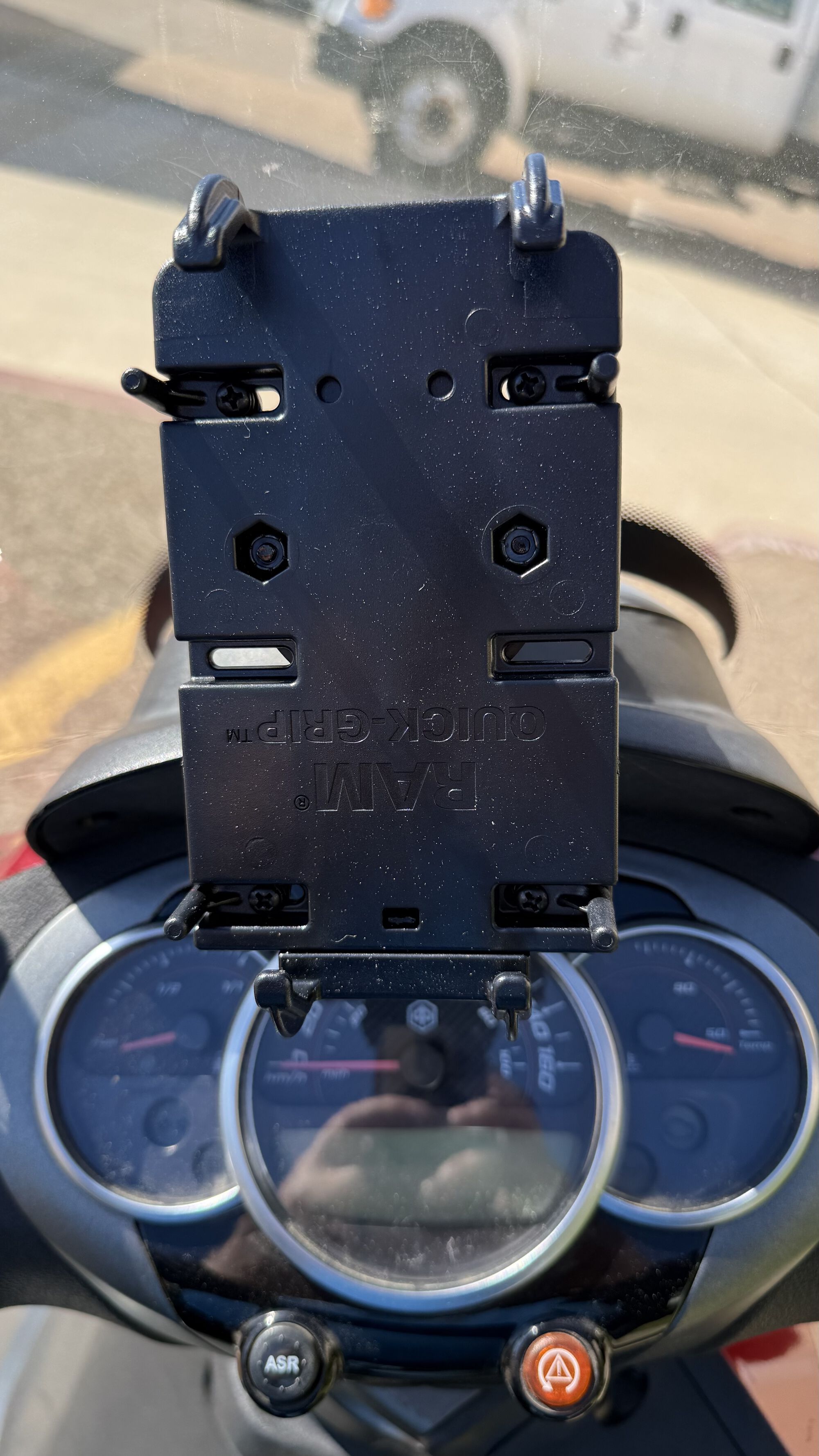

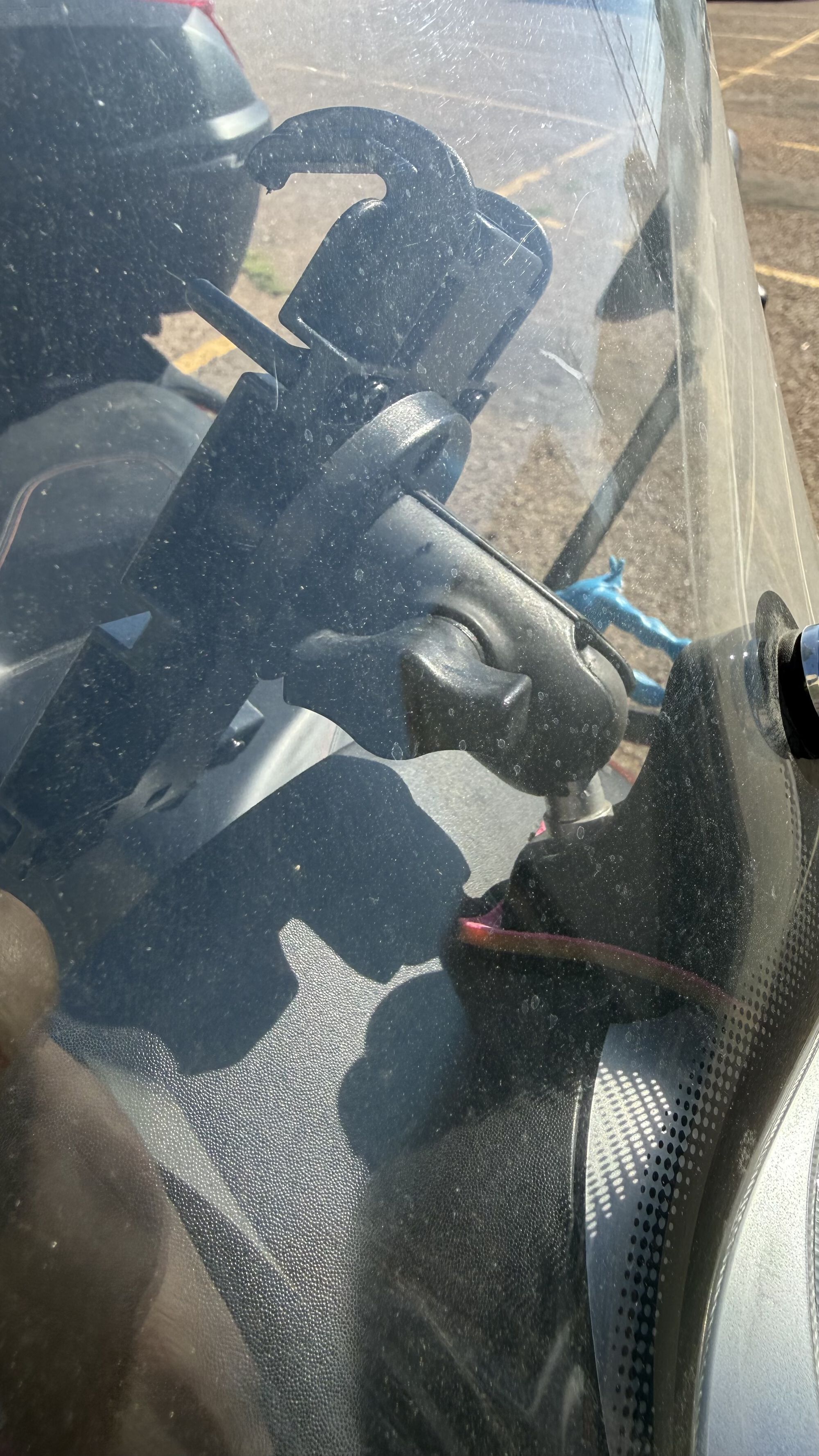

I have a RAM mount installed on the center windscreen screw mount point.
I ran across this thread when I was researching adding a phone mount after I bought my 2013 BV350 back in 2016.
I used the suggested items for the ball mount (RAM Motorcycle Handlebar Clamp Base & RAM Single Socket Arm with Round Swivel Plate), and bought a RAM Quick-Grip Small Phone Holder for it. It worked great with my iPhone 6, iPhone 7, and iPhone XS, but is too small for my iPhone 16 Pro. So I replaced it with a RAM Quick-Grip XL Phone Holder. I also bought the various screws recommended in the linked post, but I can't remember where I got them from.
The phone holder was great, because when I switched phones, I only had to adjust the positions of the side pegs. That is, until the iPhone 16 Pro, which is taller than the other phones. I could get it to fit, but it was extremely snug. It was so snug that I had to remove the mount from the scooter to be able to get the needed leverage to get the phone out of the holder. It was easier to get the larger holder instead.
When I install the Givi windscreen for cold weather riding, I simply leave the stock windscreen mount point in place, since it doesn't contact the Givi screen, and I don't care about how it looks.
The only issue I have found is that the center bolt on the ball mount tends to not stay tight, and the phone will pivot a little. That's why you see that pink neoprene under the windshield mount. I thought it would help, but it doesn't. I actually tightened it down so much that it cracked the top trim of the headlight assembly.
Current phone mount setup, view from riding position.
Current phone mount setup, view through windscreen.
Current phone mount setup, view from left side.
Current phone mount setup, view from right side.

Two updates after four mornings & three evenings of commuting:
1) Picked up some External Tooth Lock Washers to use on the RAM phone mount setup in hopes of eliminating the rotation of the mount ball. While replacing them I ended up mildly stripping the nut that the bolt goes through. The nut/bolt combo is used to hold the middle anchor point of the stock windscreen in place. I dug through all my spare nuts & bolts on my highly disorganized workbench and found exactly one (1) locknut (the kind with the nylon insert) that would work. I also found a spare mounting bolt. I then had to figure out how to hold the tiny nut in place below the other nut so that the bolt would catch it and thread through it. I also had to find an 8mm wrench to hold it while I threaded the bolt through. I couldn't find an 8mm wrench, but I did find a 5/16" wrench that worked. The phone mount did not move at all on my ride this morning.
Seems to me you cannot see your speedometer.
OK, agree, the speedometer is not of help with respect to safety but it could be not so nice to your wallet.
I have the RAM X mounted on the stem of the right mirror, a bit turned to the left to keep the phone behind the windscreen.
I only loose sight of the water temperature gauge, but that needle is always stable.

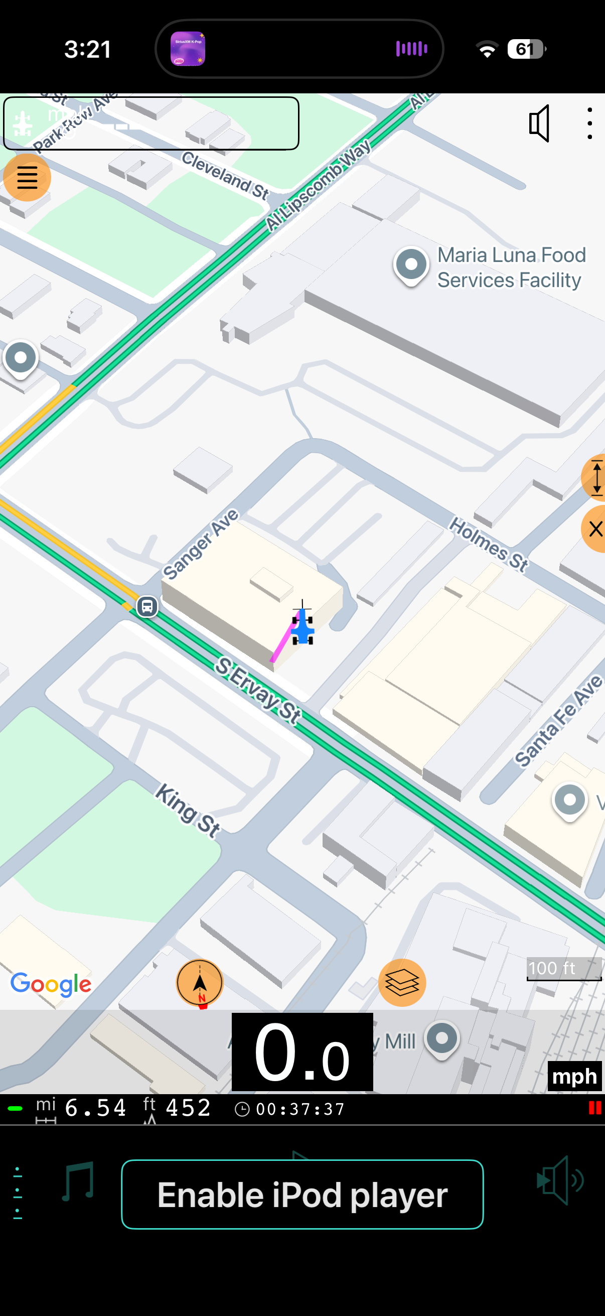

You are exactly correct.
The standard BV350 speedometer has a significant accuracy error.
The larger numbers on the speedometer are KPH, while the smaller numbers, which are much harder to see when riding, are MPH. Where I live, the speed limits are MPH.
For safety reasons I use a GPS speedometer app that also displays a map with current traffic conditions. With this setup I'm able to quickly see my actual speed, and also note if there is a traffic issue that I need to take an alternate route to avoid.
Screenshot of speedometer app view. The speed is at the bottom of the map. I'm currently sitting at my desk, hence the speed of 0.0 mph.
