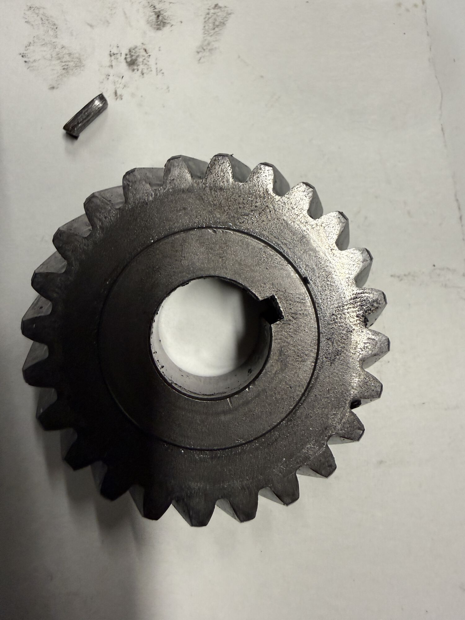

For once it is an easy fix. The input shaft woodruff key sheared.
Glad it was the easy fix!
It slipped because it wasn't torqued to spec. The woodruff just lets you know.
Make sure you have a good clean connection between the mating surfaces, then torque to spec.
Also, you can delete that woodruff key. I don't know why it or the clutch shaft key are there--they serve no functional purpose I'm aware of, but can smear steel onto the mating surfaces if they shear.

It's still popping in and out of gear at full acceleration, which I'm sure is why the woodruff key sheared. It works perfectly at less than wide-open throttle, though.
I'll be splitting the case in the future to further investigate the tolerances. It won't be for a while.

when you split the cases, be sure the lap the primary to the input shaft. If it's not a good, consistent fit, it'll slip and shear, same as a flywheel.
Besides the possibility of smearing, what other advantage is there to leaving the key out?
It's one less thing to lose into the cases. It also makes getting the clutch installed a lot easier.
I think one of the purposes of the woodruff keys on the clutch side is to act as a mechanical fuse or fail-safe. They're supposed to shear under excessive load to protect the crank and keep everything from exploding if the engine locks up.
But it's a pressure fit, same as the flywheel. If that breaks loose, the woodruff isn't going to save a thing.

No, the clutch isn't a taper fit like the flywheel. It just slips on. At least that's the way I remember it. The key isn't there to keep the clutch from letting go, it's there to let it go if the crank locks up.
The key on flywheel side is there to locate the magnets relative to the stator.
Also at the front axle/hub.
The key prevents a hub from rotating against a shaft as you torque it.
Maybe it's like a cotter pin or a tabbed washer.
Adds resistance to a first slip?

We are talking about the small primary gear on the end of the crank, right? In Utahusker's picture? That one is definitely a straight shaft.
The tapered shaft is on the end of the xmas tree and the clutch spider mounts on it. I kind of figure that even if you've lapped it until it's a perfect fit, there is not much harm in putting the key in there surely?
