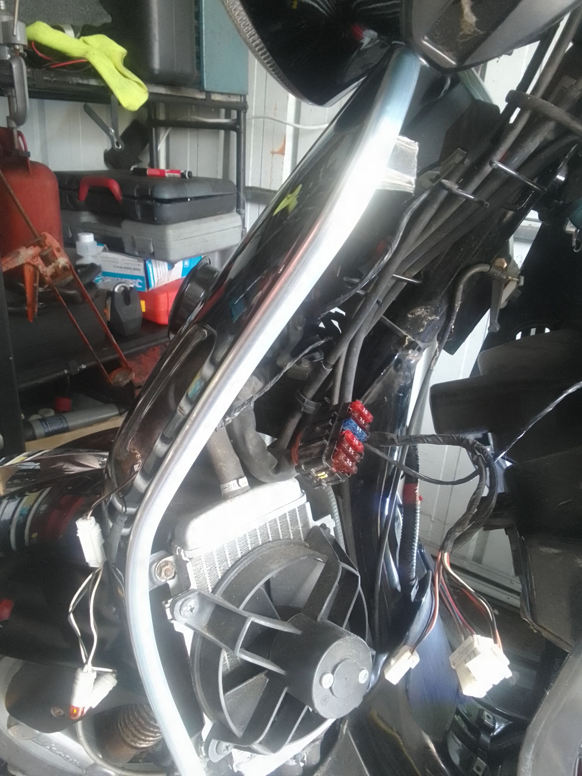

I've taken the leg shield off for a quick look at the wiring and nothing obvious.

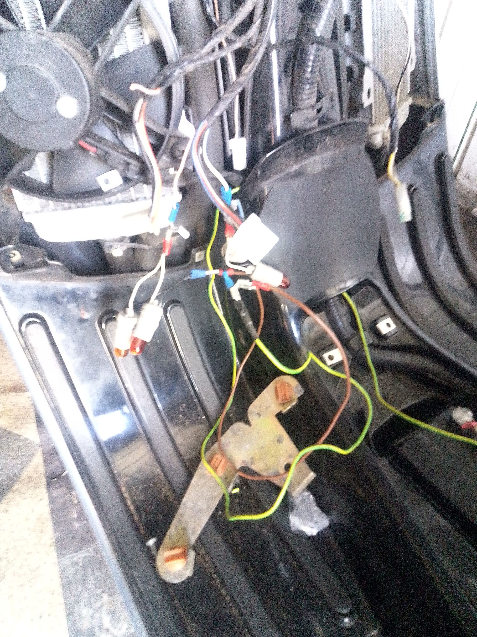

Could some kind soul also point me in the direction of the earth points?[img][/img]

Just in case it helps anyone, you can indeed cut into the alarm pre wiring and take the live feed from there, I've ran an earth directly to the battery.
