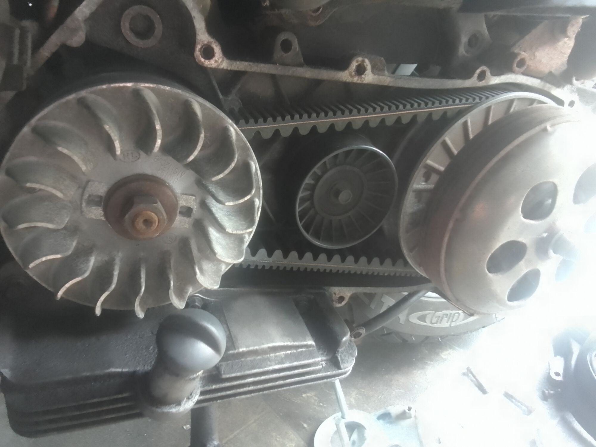

Is it normal the first throttle on after replacing belts and rollers for weird noises to come from the transmission?
Is it just settling in?
Not sure I put the rollers in the right way as I brought mallossi ones and the hole looked the same size on both ends.

Leouk wrote:
Is it normal the first throttle on after replacing belts and rollers for weird noises to come from the transmission?...Not sure I put the rollers in the right way as I brought mallossi ones and the hole looked the same size on both ends.
No, weird noises are not normal.
Are you sure belt was properly seated when torquing the crank nut? Loose crank nut will quickly damage crank splines. Open it back up, better safe than sorry.
There is no wrong way on Malossi rollers.

Does anything look obviously wrong here? ( Novice where CVT is concerned)

If you just installed the belt/variator/nut - and it looks like the pic, I would suggest that the belt should be further down the clutch pulley as to not trap the belt at variator. Doing so will keep you from be able to bed the nut to its proper torque. Loose nut = bad times ahead.
No.
Could just double check the torque but since you have it this far apart should probably go all the way for peace of mind.
2 ways to insure you aren't torquing on a pinched belt: 1) open up the driven/clutch pulley and wedge the belt into it, belt should be slack at the vario. 2) after torquing rotate the crank several several times and recheck torque. If belt is pinched this will free it up.
You was right.
