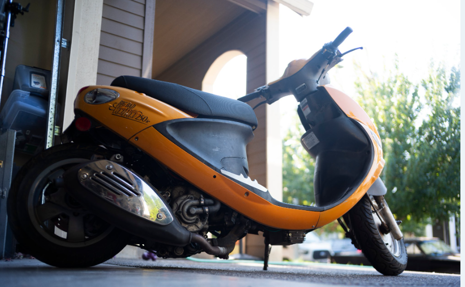

MS put this same engine into a Buddy 125. Megasquirt on a GTS 250 engine... In a Genuine Buddy 125.
