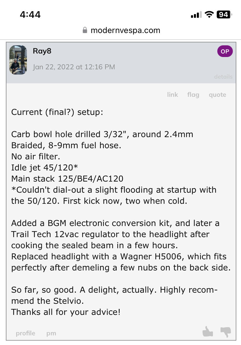

I took a screenshot of Ray8's VMC Stelvio 177 build where he posted his final settings. His build is very similar to mine. I think I may be slowly gravitating towards his final settings. I am running an air filter though. I bet I end up close to his settings.
Hec
Hec
Blast from the past right there!
Current jetting is 55/160, Lemarxon X234, his LML slide, and his 22mm sleeve.
MJ idk, as it was reamed from a 122 up (less than 128). AC reamed from a 140 to idk (less than 160). No filter.
Much more a delight than then.
