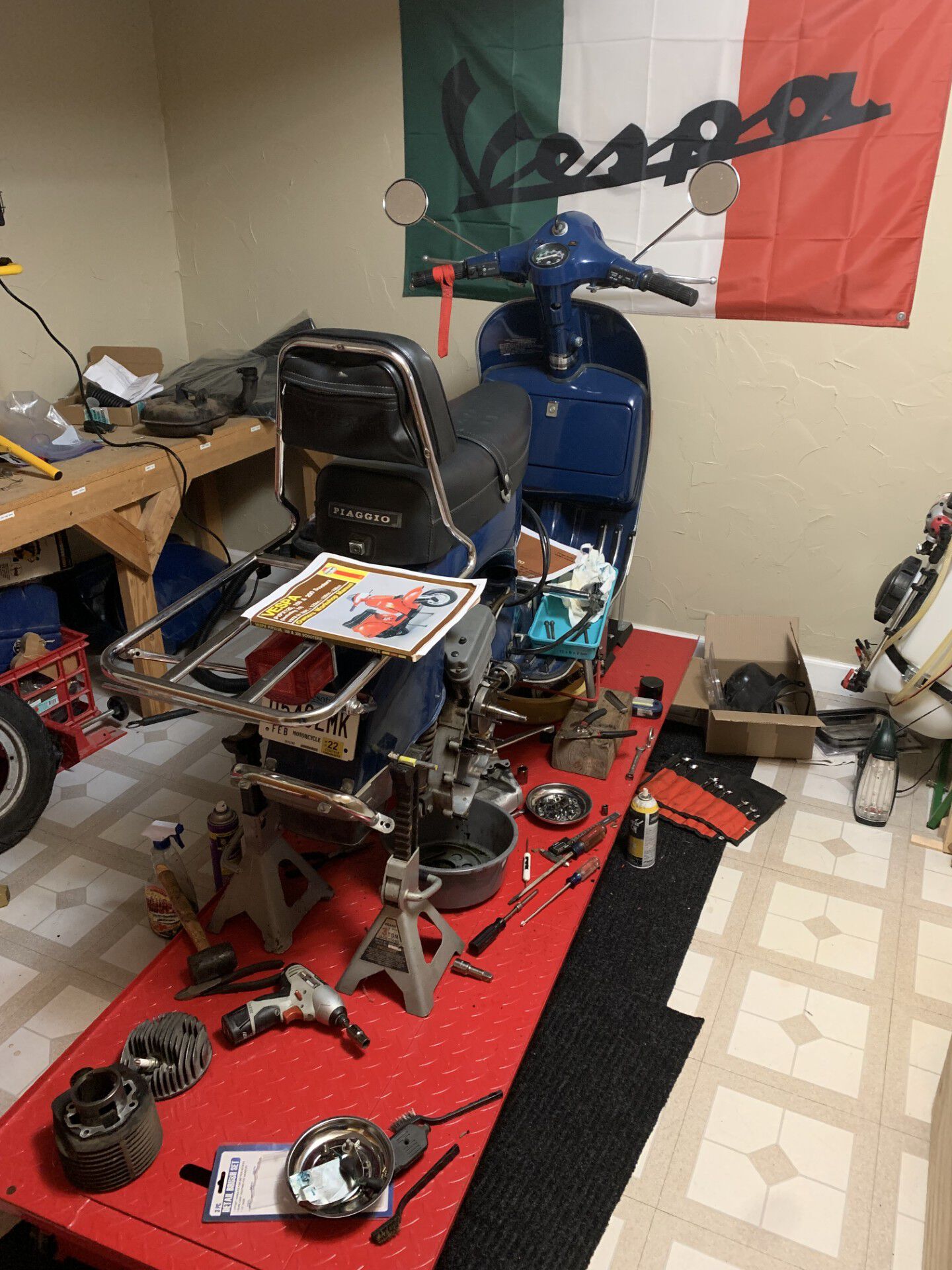

Get yourself a piece of steel rod that's just small enough in diameter to pass through the cowl peg holes on the frame. Pass the rod through both holes and support each end of the rod with a jack stand. I did this until I built my Vespa Stand. It worked fine!
Hec
Vespa Rear Support
