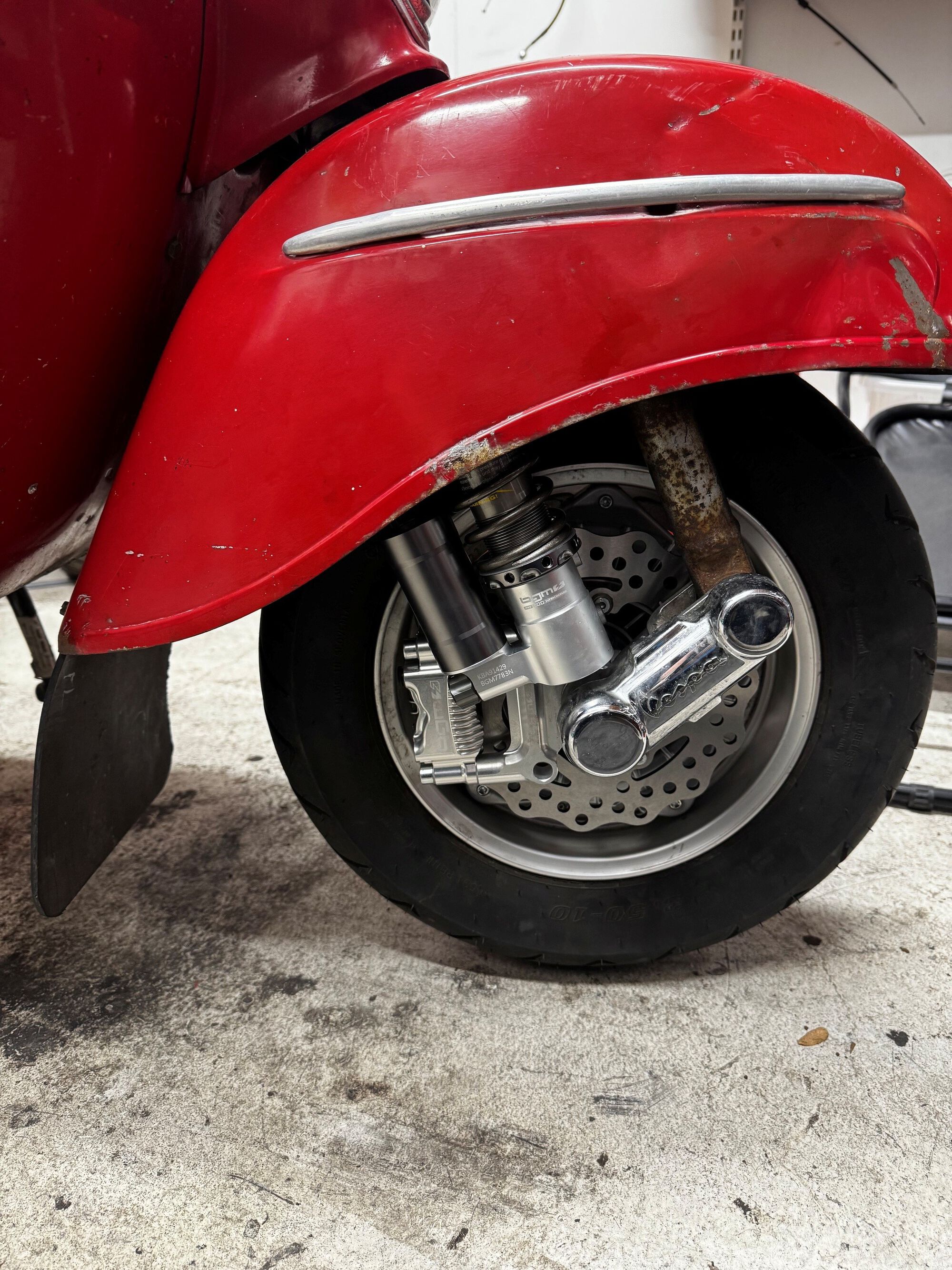

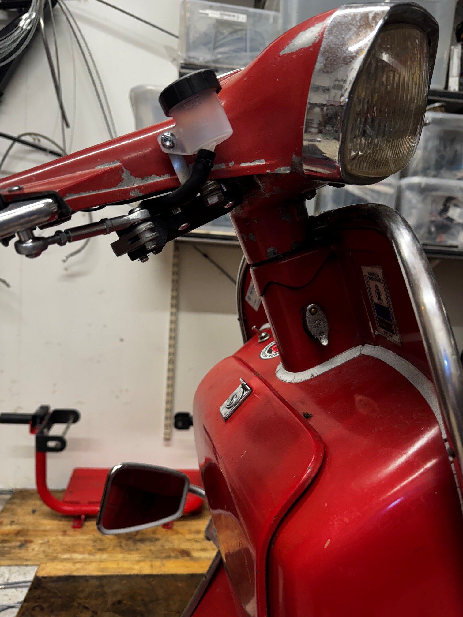

Hi Eltel69,
I went down that route to match the front with the 252-engine in the rear...
Went all in for a taylor made PK fork with floating disk, radial caliper and BGM Pro shock.
On the handlebar I went for a Crimaz handle/pump which I've used with success on my 90Racer.
Be aware of that a "standard" PK fork needs alot of work to look good in a SS frame with regards to fitment of mudguard vs frame...
Eltel69 wrote:
1967 SS180
I want a front disc brake
Suggestions please
[img][/img]
PK fork in SS180
PK fork in SS180
Crimaz on SS180
Crimaz on SS180
