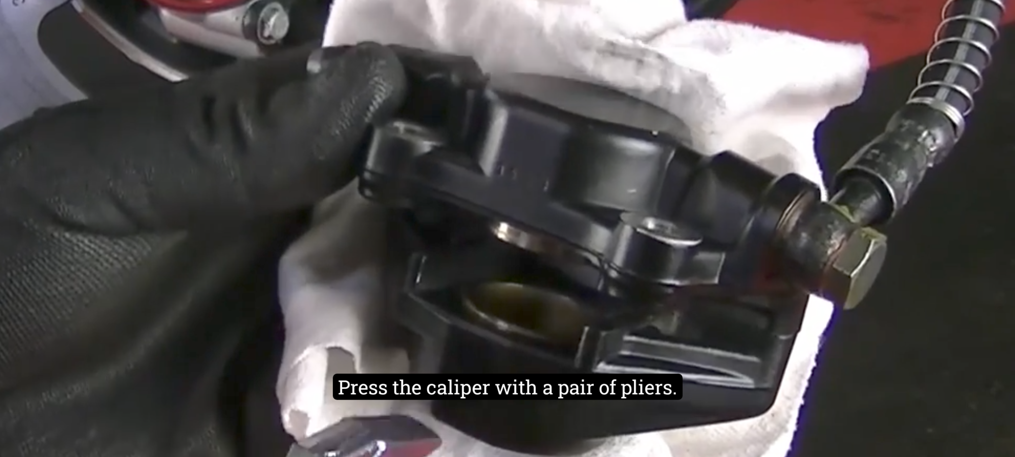

A year ago I disassembled and cleaned the caliper. 2 pistons, as in the photo. This time I did not clean it, the pads are original.

There are no boots there.
This is Piaggio Heng Tong calliper.
