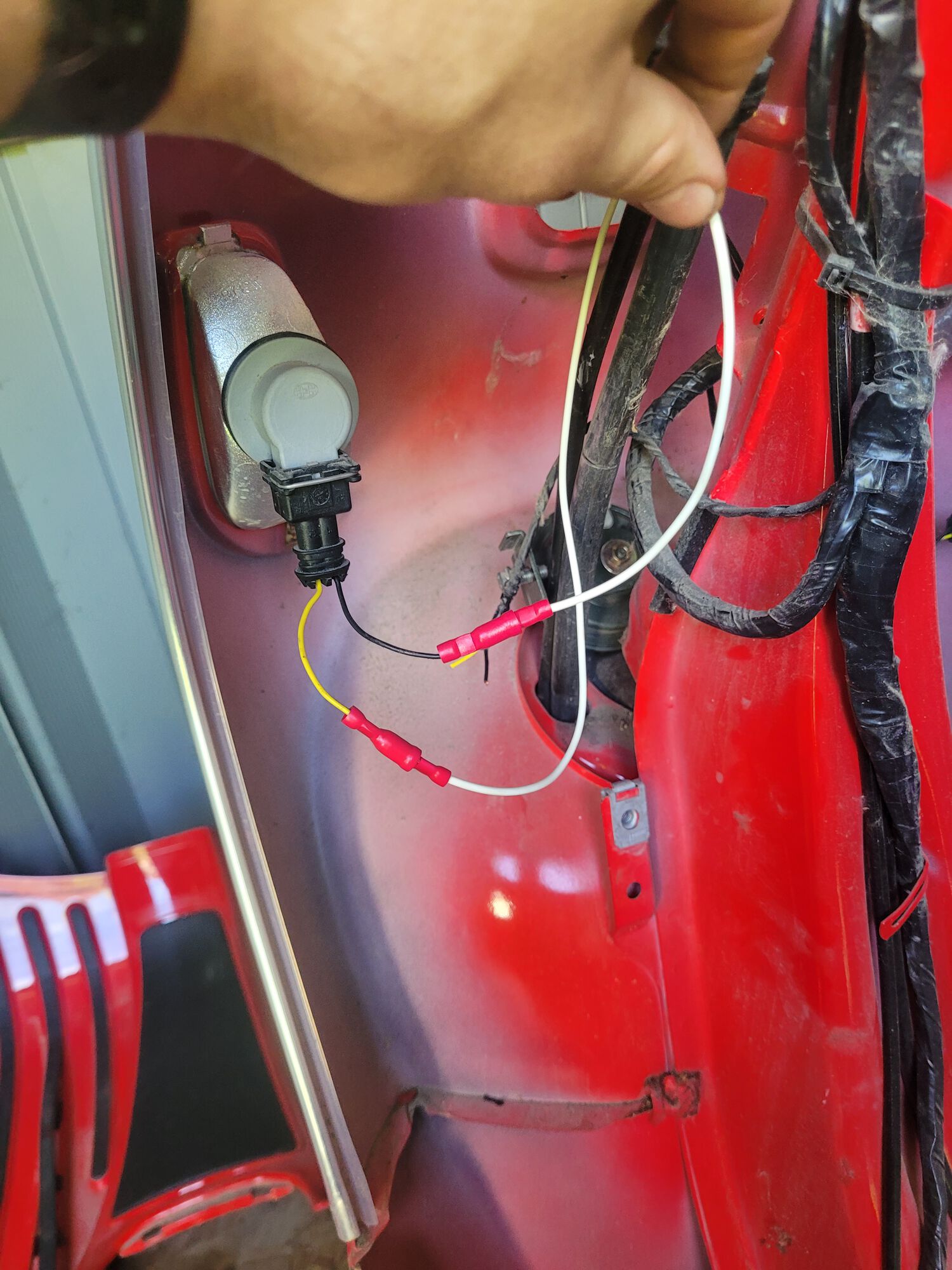

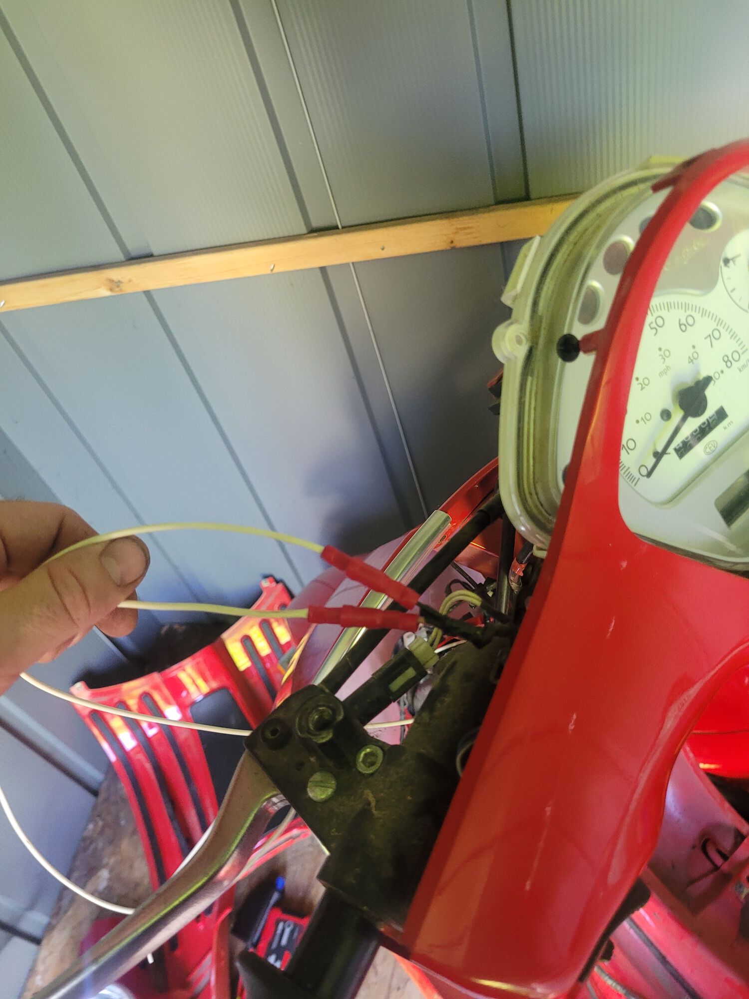

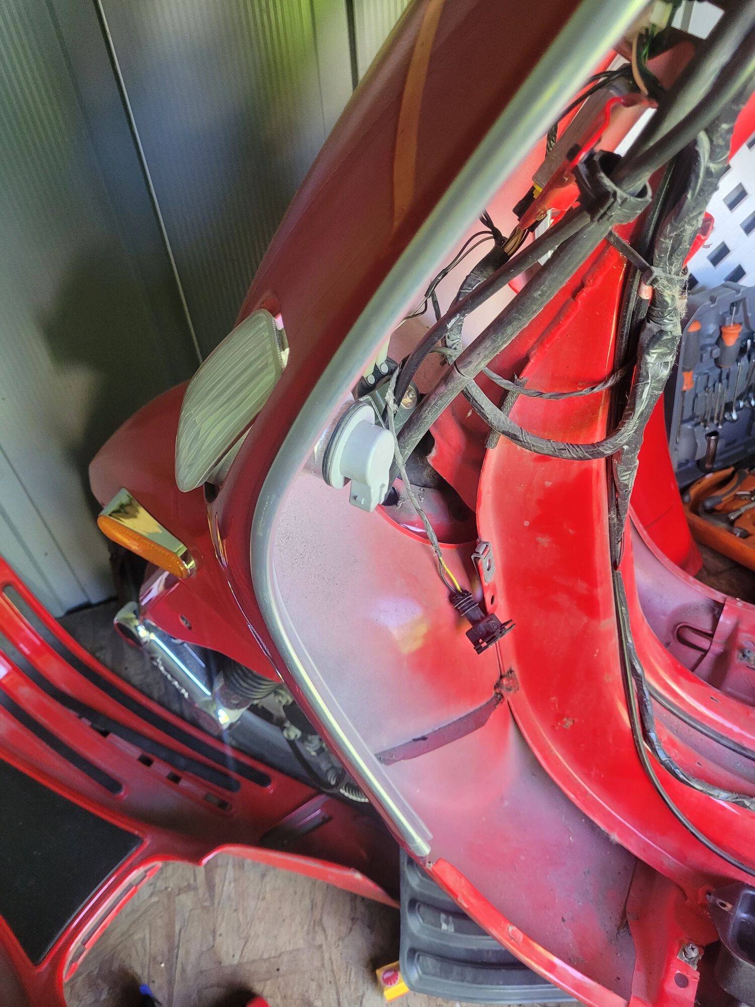

I'm going to be doing the euro light mod and started that. I want to do it for cheap so I'm re routing the pod wires to the DRLs and then I'm just going to apply amber tint to the lights because finding amber bulbs here is difficult.

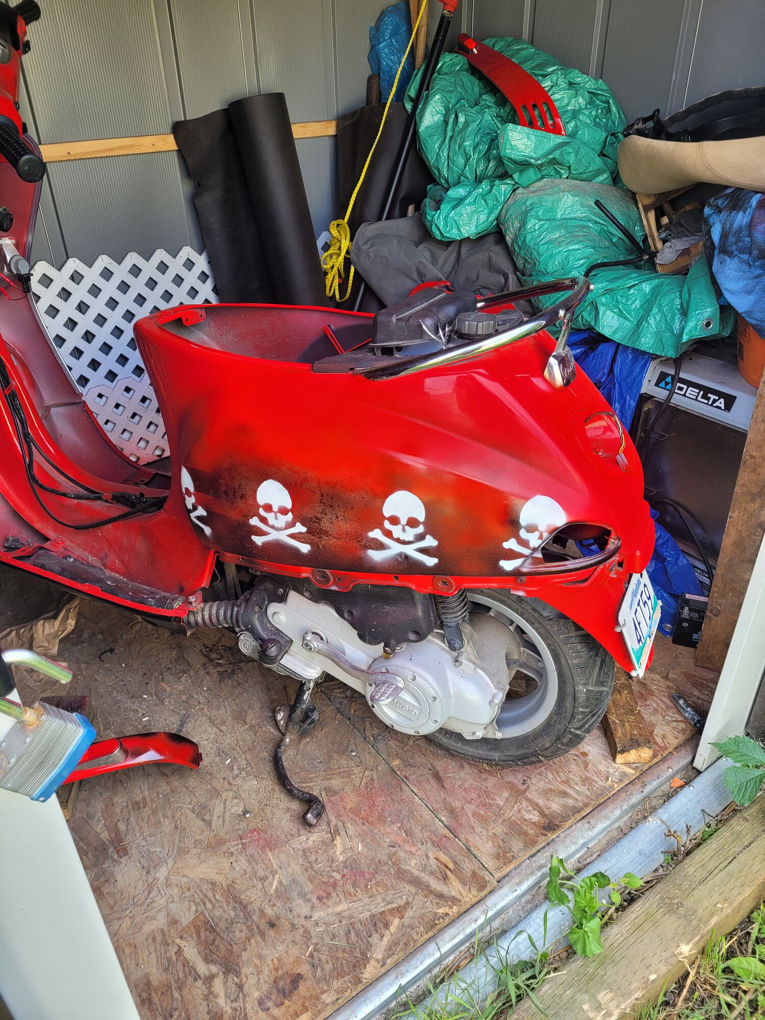

The scoot had some pretty deep gouges on one side, I've never been good with body work. Filled them in, sanded and played around with rattlecans and paper stencils

I applaud the creative coverage
