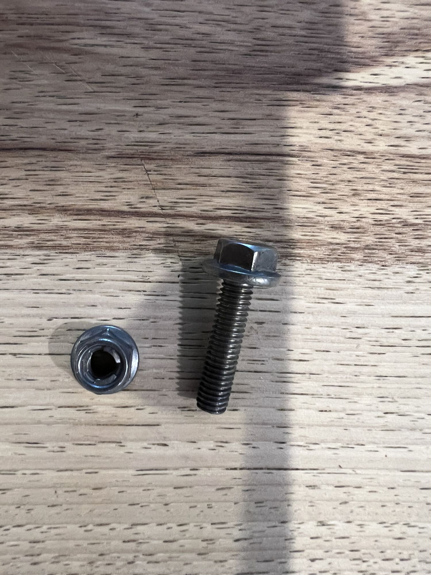

I recently reinstalled the motor on my 2013 LX 50 4t 4v. I have accounted for every nut, bolt and screw that I took off the bike when I removed the motor except for these. I can't for the life of me remember where they go. The nut is a "lock nut". It's gotta be from either the electrical or fuel systems. It's not from the motor itself. Anyone have an idea where they go? The bike is running beautifully, so it can't be anything too critical. Thanks!

Can you measure its diameter and length (in mm)? That would help.

The bolt length is 31mm and the diameter is 6mm. Sorry that I left those measurements out.

I was going to search the parts list (https://www.af1racing.com/ProdImages/st3/EVP8000US3.pdf) for an M6 screw or nut, but didn't find any that looked right. Perhaps you would have better luck.

Found it! It goes to the air cleaner. Thank you, thank you, thank you. It's been driving me crazy for the last 3 days.
