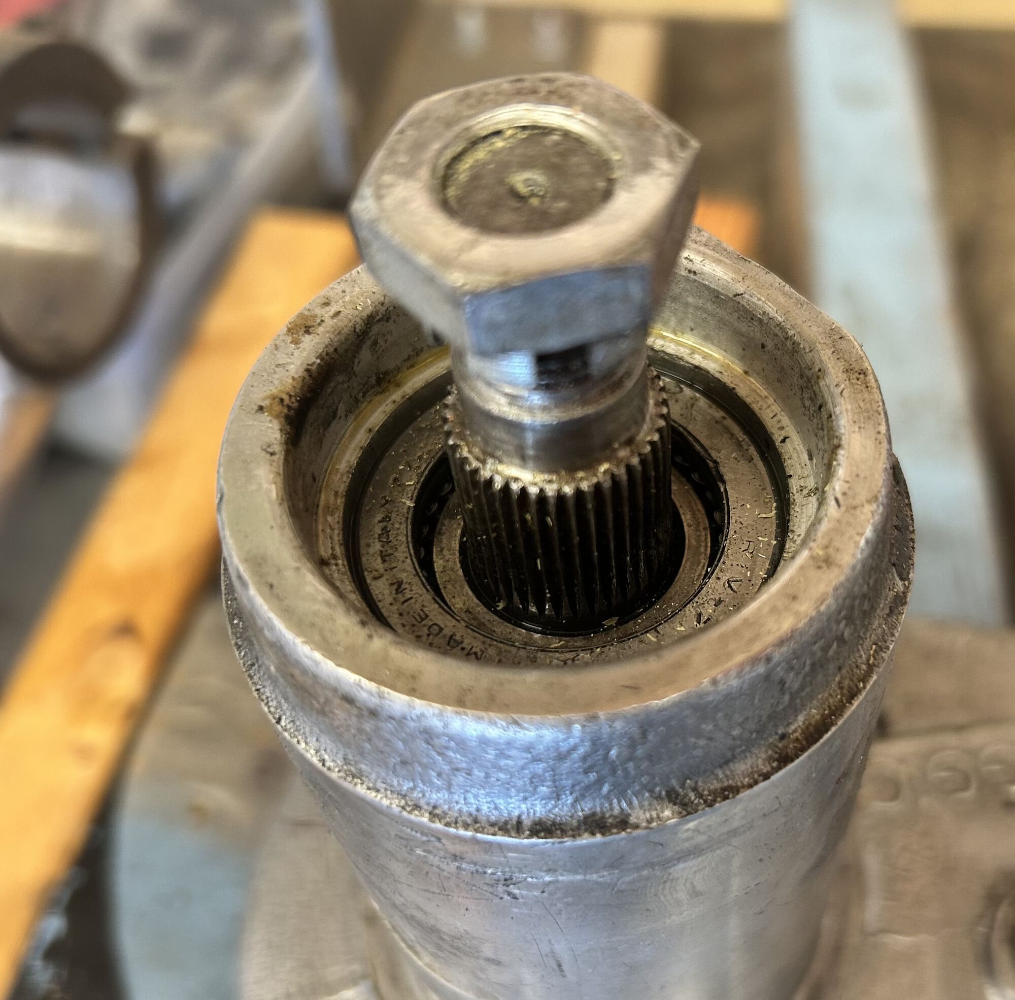

Howdy. I've started a rebuild on a 1958 GS engine and have run into a snag. Everything else has come apart as expected, but the dang axle ain't "tapping" out. (And I'm doing more than tapping, too: some pretty solid whacks. Gotten to where I'm nervous about damaging something).
So far I've been cycling thru heat (to the outside bearing, and also the case around it) and PB Blaster. The axle has moved maybe a 1/4 or 3/8ths inch, but now it's beginning to take the inner part of the outer bearing along with it. I'd say that's where the problem is—the inner ring of that bearing is pretty solidly stuck to the shaft.
Any thoughts? Just keep cycling through heat and Blaster? I'm nervous about just moving on to the caveman solution, a much bigger hammer.

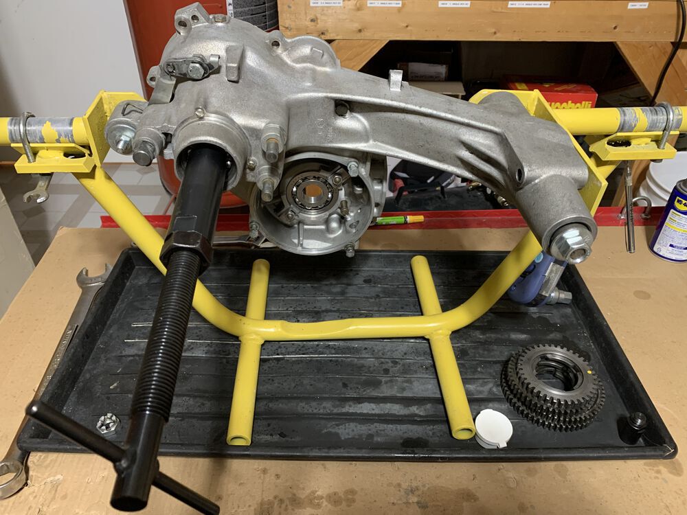

Tough one! I would try using a crankshaft installation tool to try to pull it back in place then tap on it as you have been doing, then pull it back in place with the crankshaft installation tool, and tap on it again. Repeat and Repeat! Hopefully it will break free. You are working it in one direction only. Maybe working it in both directions will free it up. You can also try soaking it with a 50/50 mix of acetone and type F transmission fluid. The acetone/type F mix will creep down deep then the acetone portion will evaporate leaving the type F transmission fluid behind to work its magic.
Good luck!
Hec
Crankshaft Installation Tool used to pull in the axle on my P-125X
